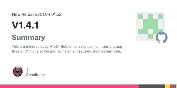

You can try the Beta version here:
On my MacOS, this version solved the issue.
Thank you, @3dball !
