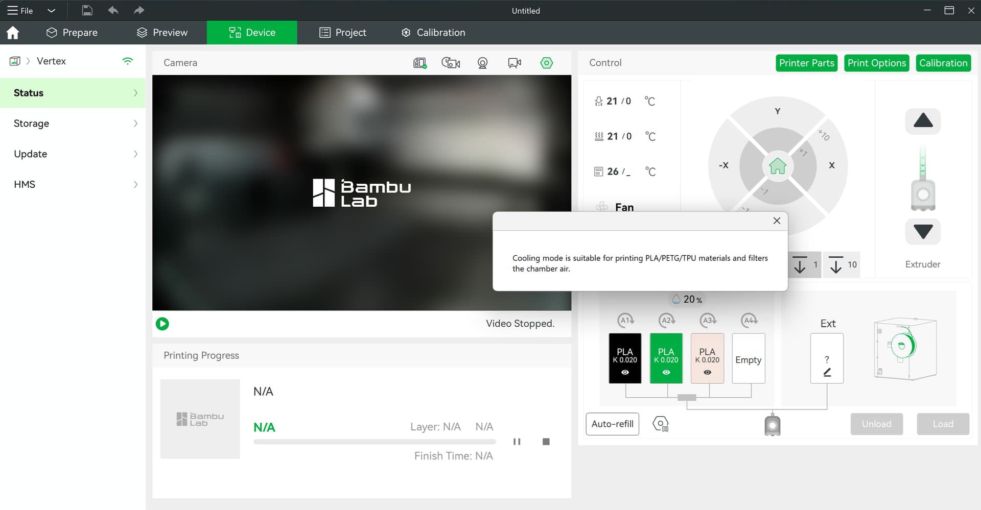

Clicking on the Fan icon in Bambu Studio used to let you adjust the 3 fans on the X1, now it just shows a modal window. No way to adjust while printing, except for using the Bambu Handy mobile app now:
Are you on the Beta version of firmware? That version is the source if the issue from what I’ve found.
I tested all versions of Bambu Studio 2.x and I found that the issue exists in those versions. If you roll back to 1.x you get your controls back. Rolling back to non beta version firmware for the X1C also solves the issue.
yes I am running the beta, that must be it. Thank you kind sir.

I’m on the latest NON-BETA (2.0.3.54 Windows) and am now experiencing this problem. This is a huge issue for me. Hopefully they will revert this. I need full control of the fans from within Bambu Studio. I wish Bambu would stop adjusting things and taking away functionality. I have over a dozen printers, and it sucks when I lose key controls like this!
Im on 2.0.1.50 and if you click the fan icon it opens the 3 to adjust but its now a pain in the +#$ because you have to confirm each time you want the fans off 99% of the time i dont use chamber or aux fans. This is the stupidest “fix” they have ever made

Did they just take away the ability to change the fan speeds, or is this a bug?
I can’t change the fan speeds from the Bambu Handy mobile app either. It is permanently stuck on 30%,30%, and 30%. If I try to change it, it immediately reverts back.

Grok fixed this for me for my X1E
Step 1: Disable Default Cooling to Prevent Overrides
This is crucial—without it, even per-layer G-code won’t stick because Bambu Studio inserts its own M106 commands based on filament cooling profiles.
- In the Prepare tab:
- Click the gear/three dot icon next to the Filament dropdown to open Filament Settings.
- Go to the Cooling tab.
- Set Part cooling fan, Auxiliary fan, and Chamber fan (if visible) to 0% or disable them entirely.
- Disable Auto cooling, Keep fan always on, and any overhang/bridge fan options.
Step 2: I was able to slice and edit manually in slicer by right clicking the layer. If I change fan speed it will keep that speed until I adjust another layer.
***In this situation I disabled all three fans the X1E has so that I can test them independently.
