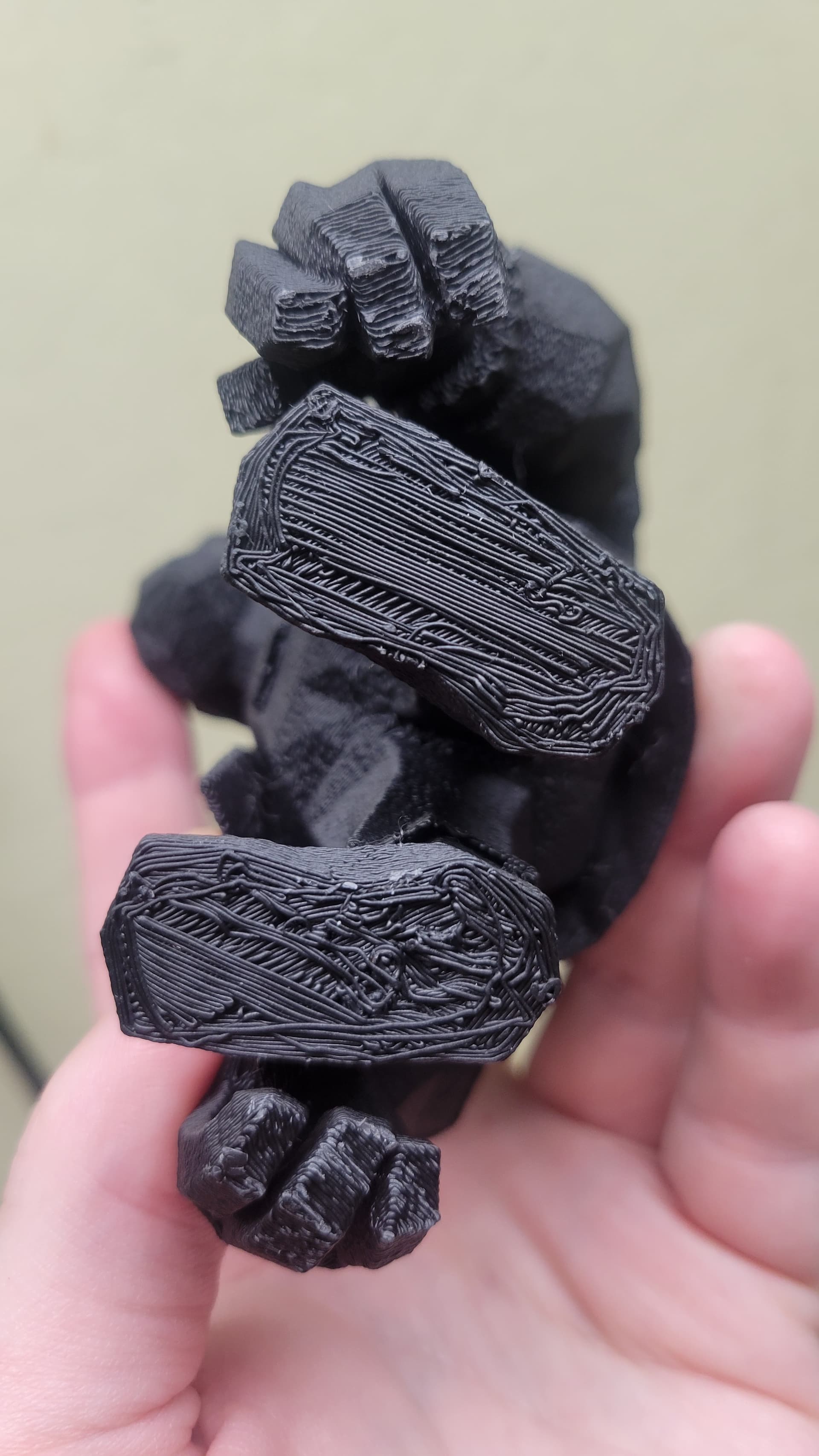

Can't figure this out, first layer issues, matte pla

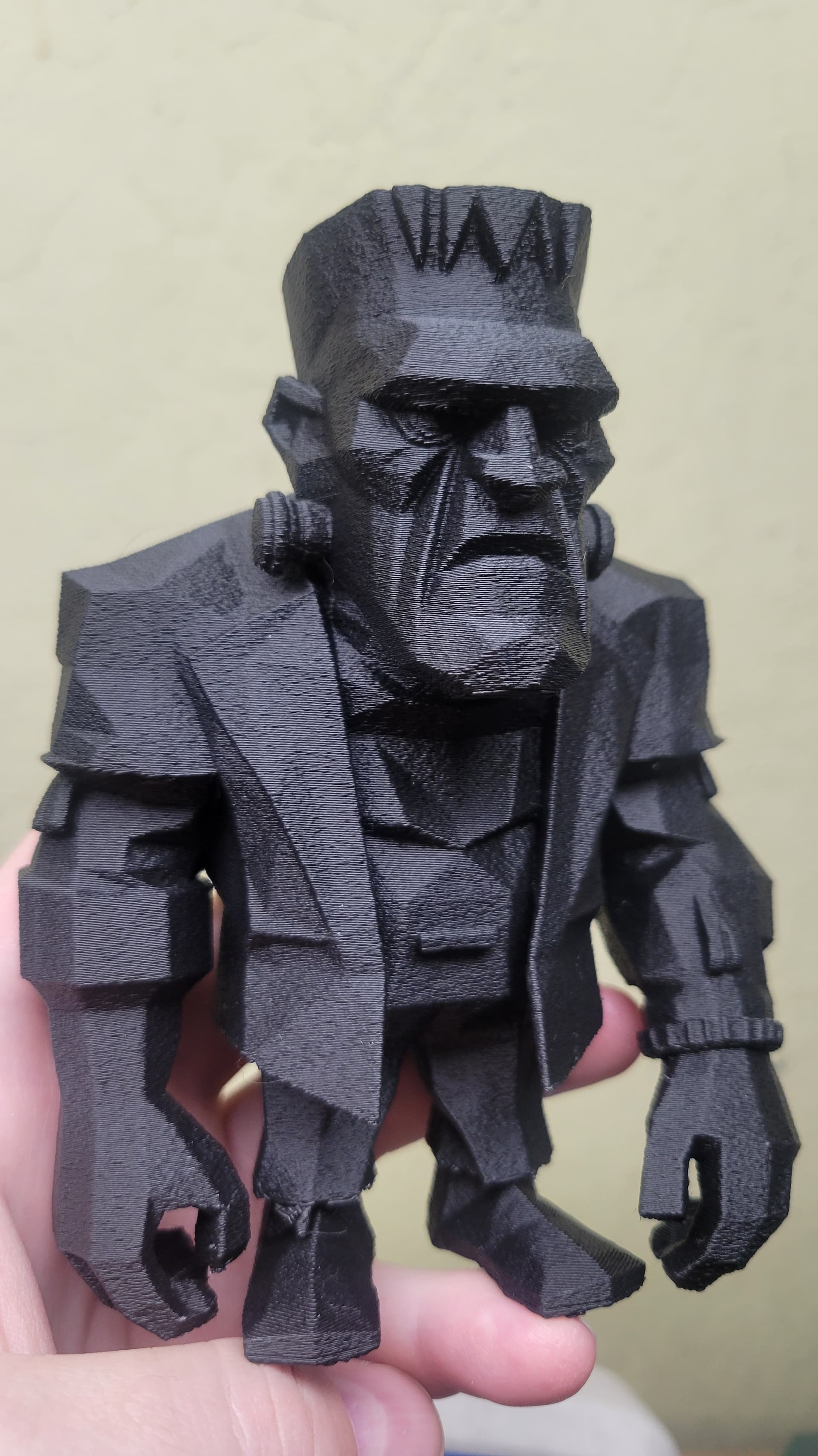

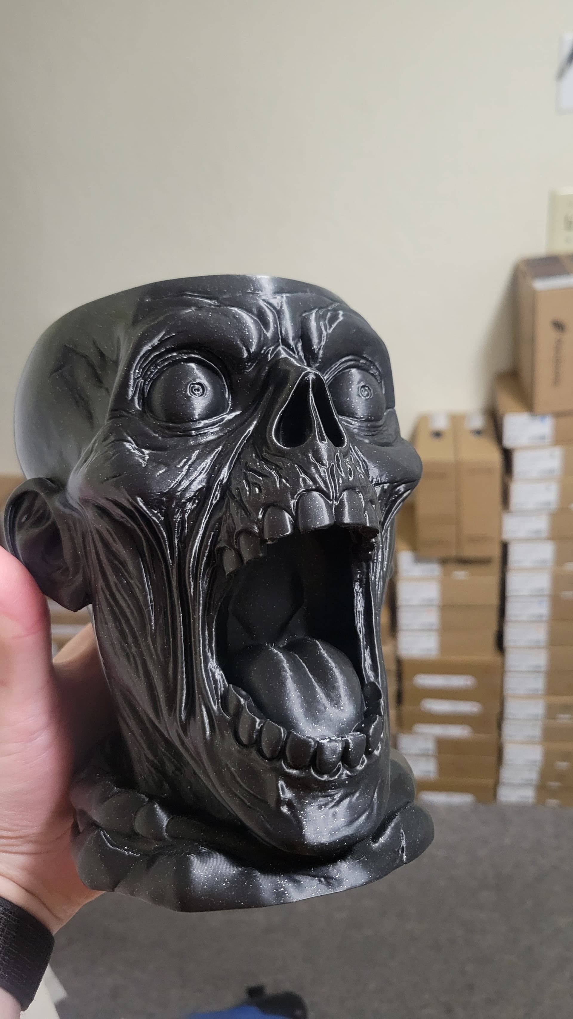

Having this issue -->ONLY<-- with Bambu matte PLA. Same printer/plate does not do this with Bambu PLA, Bambu PLA Silk, Bambu PLA Galaxy, etc. I’ve tried it with multiple different prints now.
First layer is garbage, every layer after that is absolutely flawless
This started somewhat recently, thought it was firmware (wasn’t), now thinking it is plate related as I recently switched to Biqu Frostbites (wasn’t occurring with Bambu Textured PEI Plates). Although I don’t know why it would only happen wtih matte PLA…
I’ve tried flow calibrations, increasing first layer temperature, reboots/resets, calibrations, nothing has helped.
From what I’ve been able to find, it may be a Z Offset issue with the first layer?
Perfect print with garbage first layer.

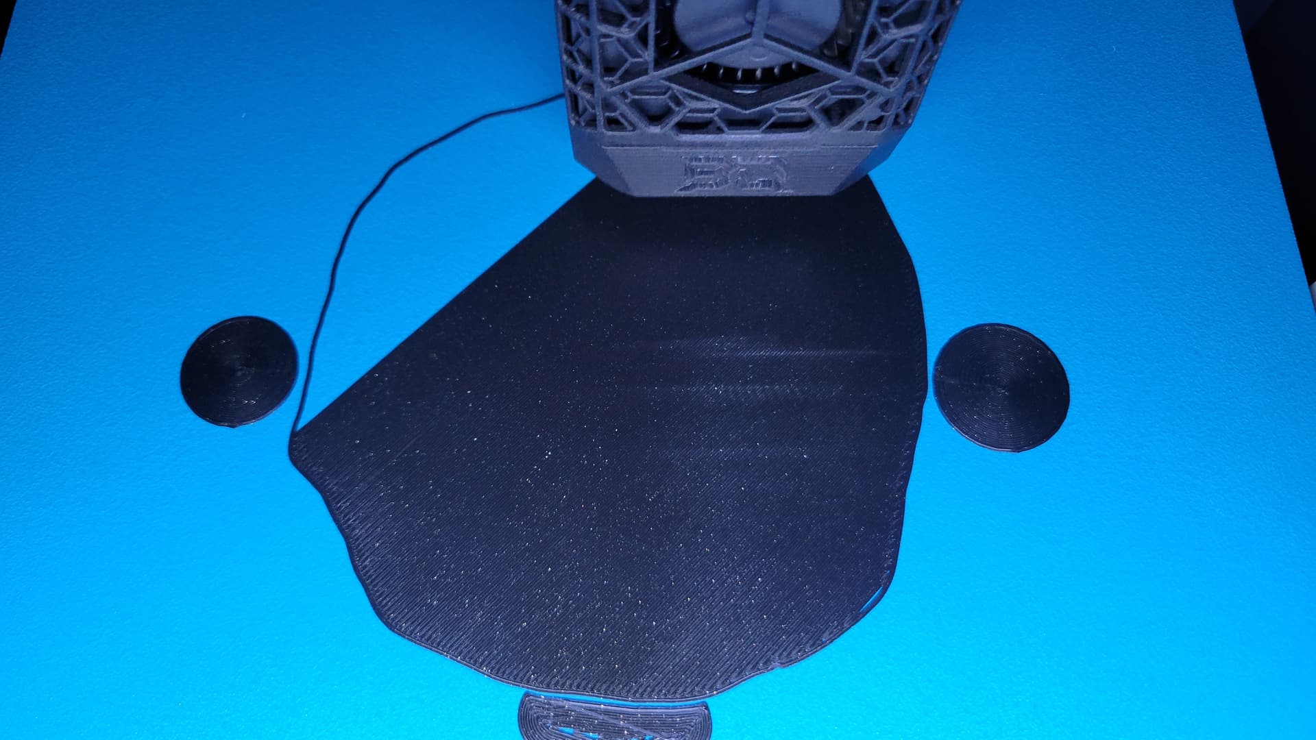

Last picture is the fist layer of a 12 hour print done in Bambu PLA Galaxy and is perfect.
I’ve countless examples of perfect prints with garbage first layers.
