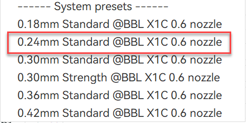

Hi guys,
sorry for the newbie question and maybe I do something wrong, but somehow I cant find the 0.20mm layer height in my X1 Carbon:
I see 0.24mm, bu no 0.20mm?
Are you using a .6 nozzle? .2 layer height is not a standard preset for .6 nozzle on my printer. I believe these printers all come standard with .4 nozzle & if that is what you have installed, then you have to select .4 nozzle in system presets under the printer section of slicer. Then you can select .2mm layer height.

yes, I know it looks strange, but you can also print in 0.2 with the 0.6 noozle.

Magic numbers have nothing to do with the nozzle size, but the drive system of the printer. And afaik, the Bambu Lab Printers use a transmission that would lead to 0,04mm microsteps, aka magic numbers. Correct me if I am wrong, but I see nothing wrong with using 0,2mm layer height.

But in the video, nozzle size does not matter at all for magic numbers. They are solely and only related to the stepper motors precision (I assume the printers have standard 1,8° steppers) and the pitch of the threaded rods.
And with the default pitch and steppers, the magic number is a multiple of 0,04mm and as I already said, completely unrelated to nozzle size. I might be wrong about the steppers. So actually 0,2mm layer height is the correct value, while 0.24 is also fine, it is not cause it can be divided by 0.06 but by 0.04.
But with ABL, magic numbers loose much of their relevance anyways since ABL constantly adjusts z-height anyway.
