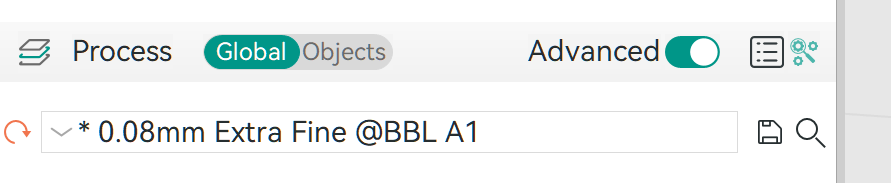

I believe @Megafonmann is referring to Objects vs Global in Process area.
Thanks Found tab. File could not be altered so trashed and reinstalled the STL and resolved the problem.
I got bit by this last week. Support settings in the Objects tab silently override those in the Global tab, so if you changed it to trees in the Objects tab, you’ll get trees no matter what the Global tab says.
