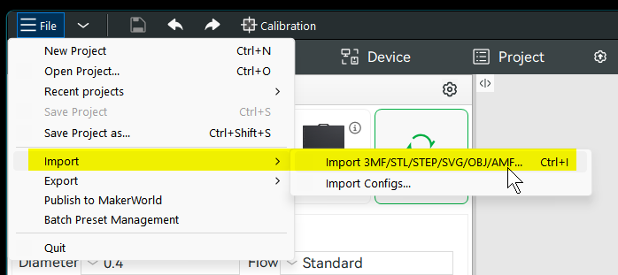

File→ Import should let you load the.OBJ with colors without using another converter.
yeah but as i said, this will only import the object and not the color settings :frowning: so the model is only single color
