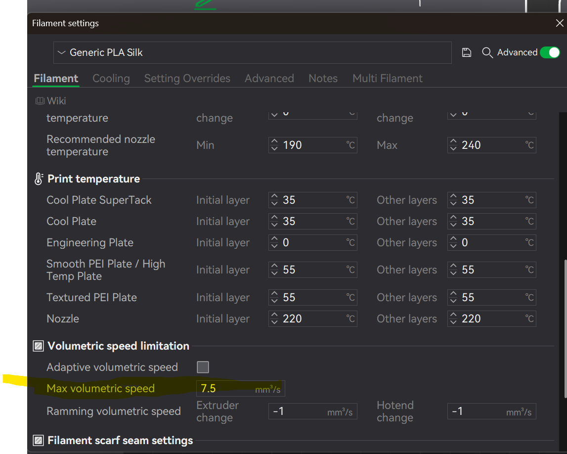

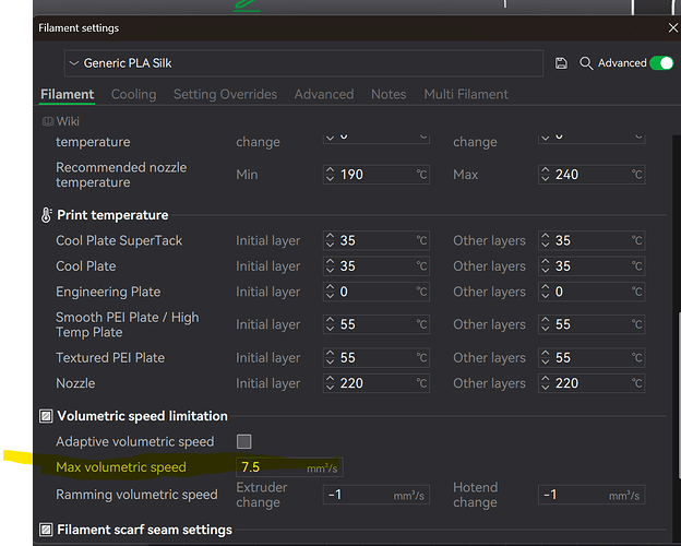

With Silk, slow down the printing speed to get shinier/smoother results, mess with the
Max Volumetric speed
Generic silk defaulted to 7.5 for me, try 3 or 4 and compare results. Prints will take longer but should be better quality, potentially.
