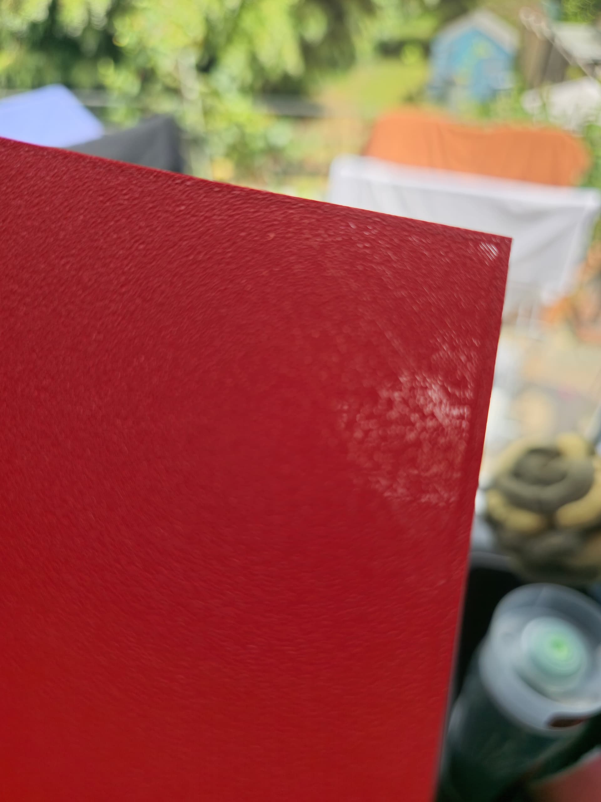

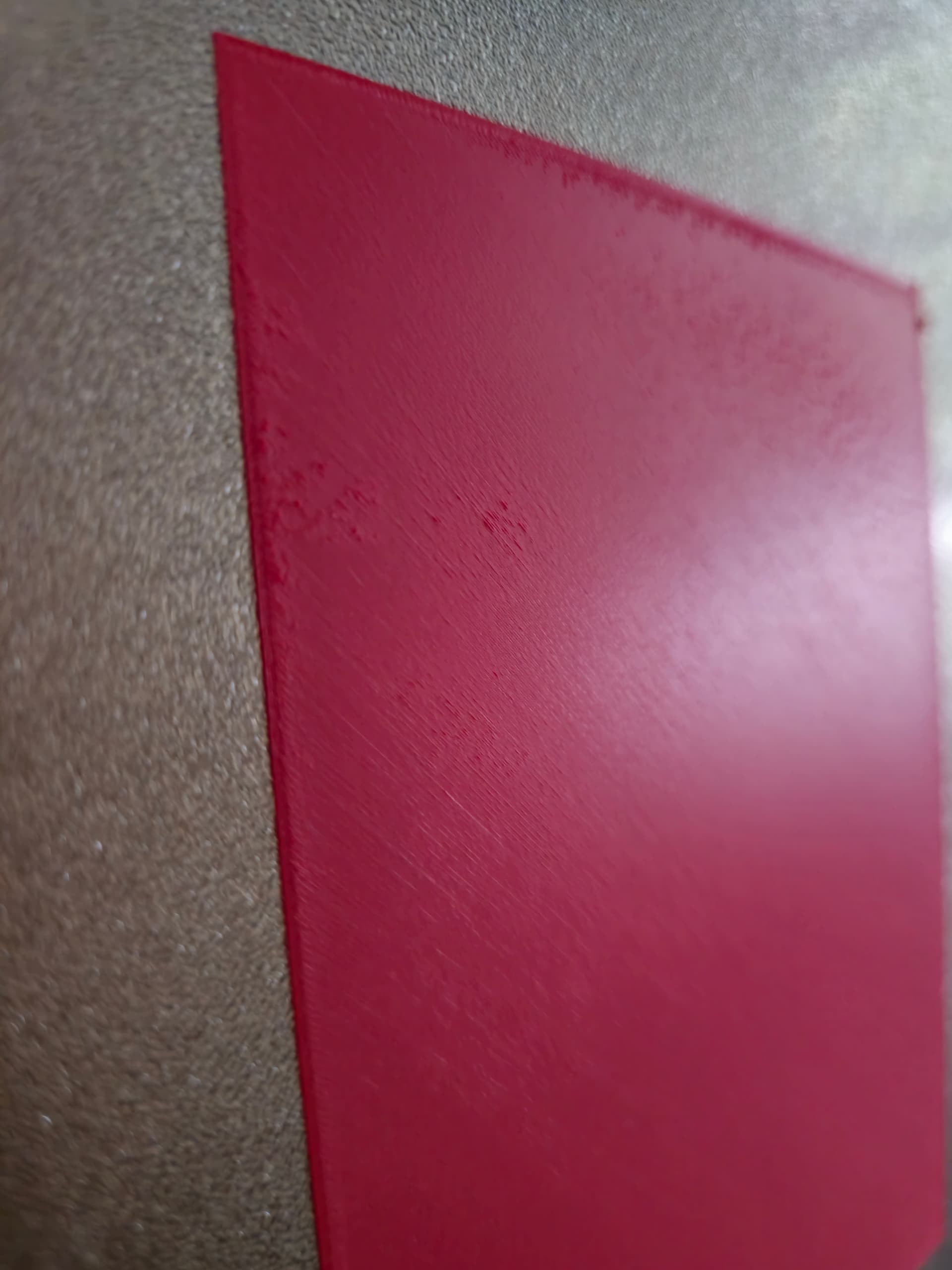

It seems that it was the Sunlu filament CMYK bundle. It was confusing because bambu was giving me test prints and they printed ok.
But i couldn’t print an actual model at all kept constantly failing. I couldn’t even get the bambu labs calbrations to work.
So i purchased some new bambu matte filament and it printed no problem. Only issue i have now is the first layers are not that great.
I found that for all types of textured plates. like SuperTack and Textured PEI, you must have a minimum of 0.12mm layer height for first layer or it will not stick.
This is especially for the above two types of plates.
For smooth plates where you use glue, 0.1mm can work, but i still recommend 0.12mm as minimum with 0.2 nozzle. (I now use this as minimum for ANY nozzle)
The front test patterns use 0.12mm layer height on all bambu printers.
