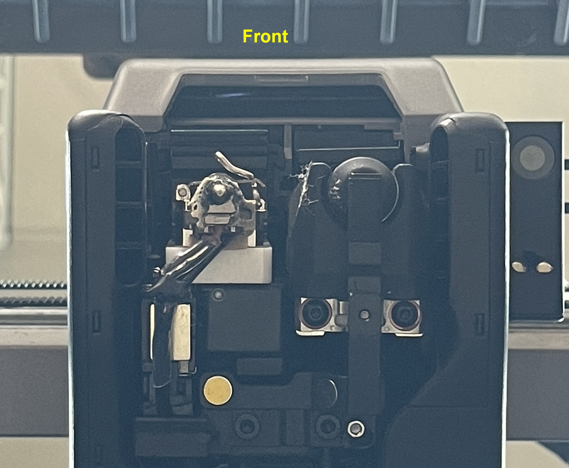

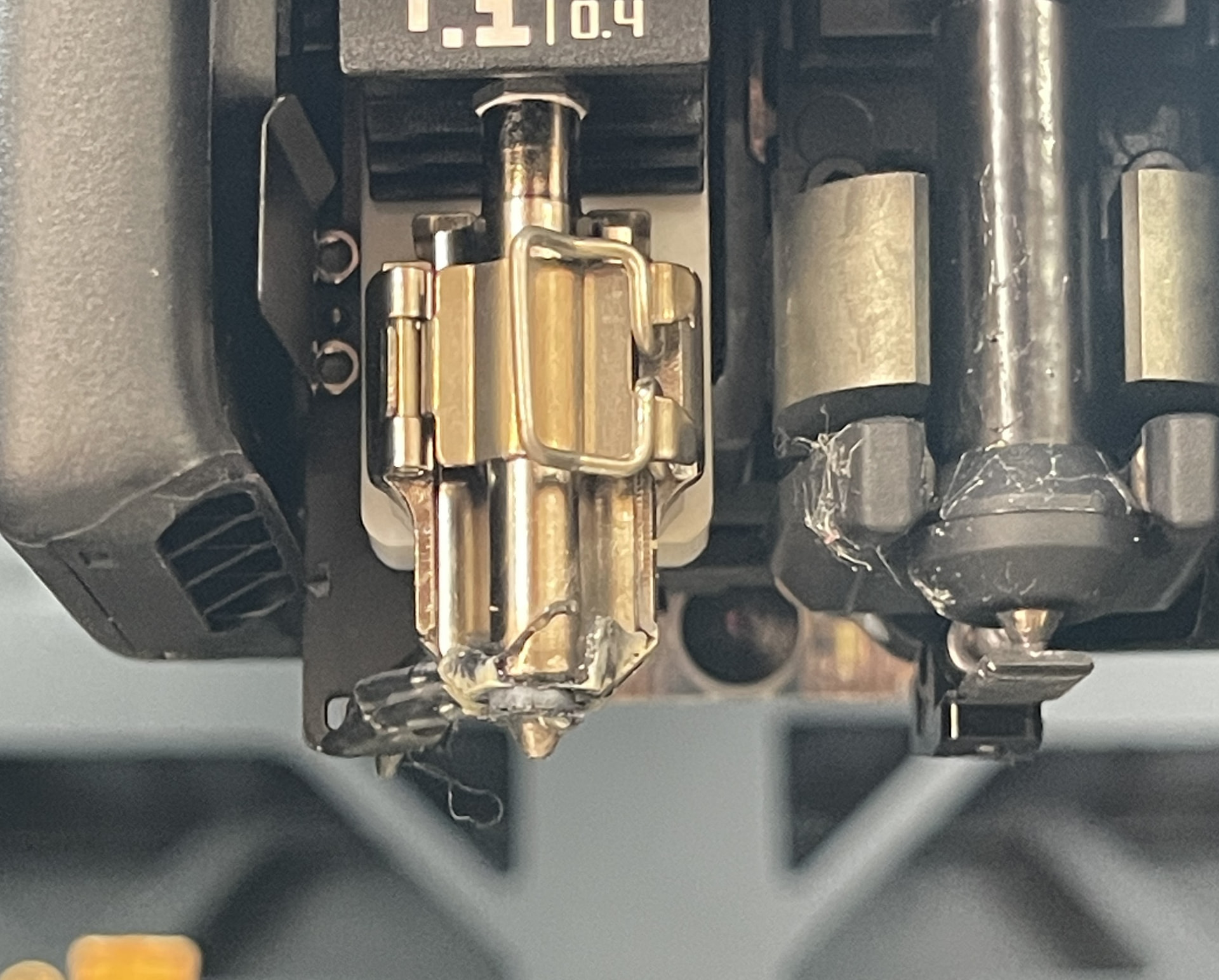

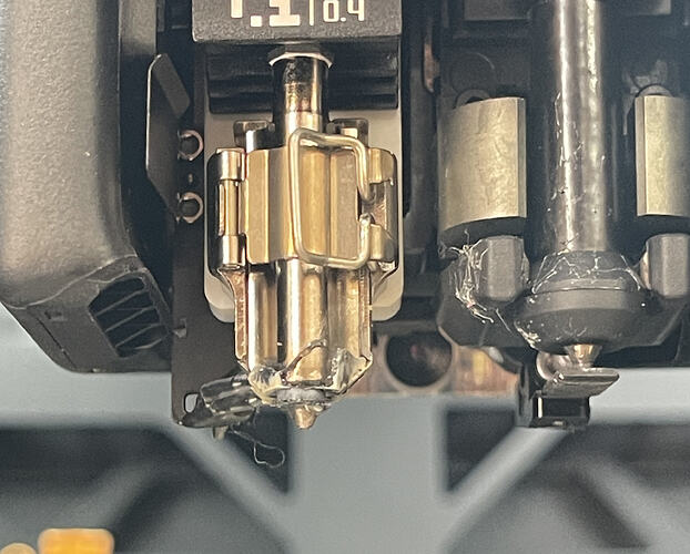

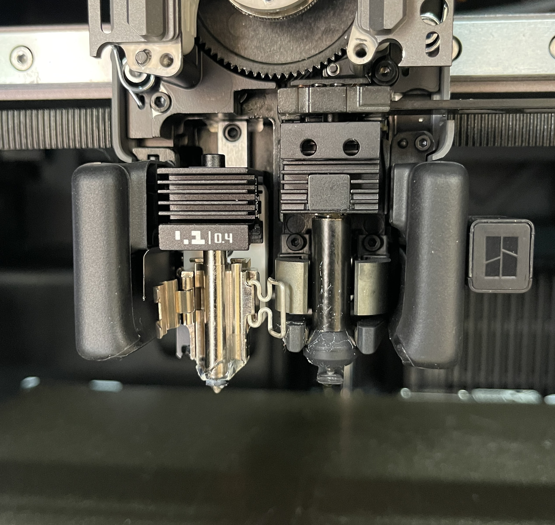

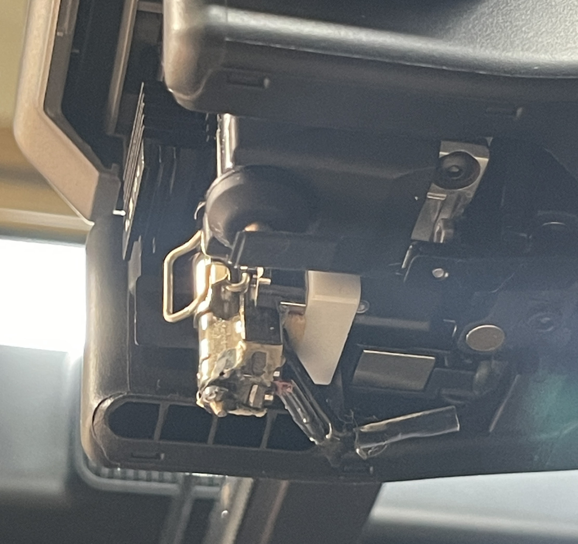

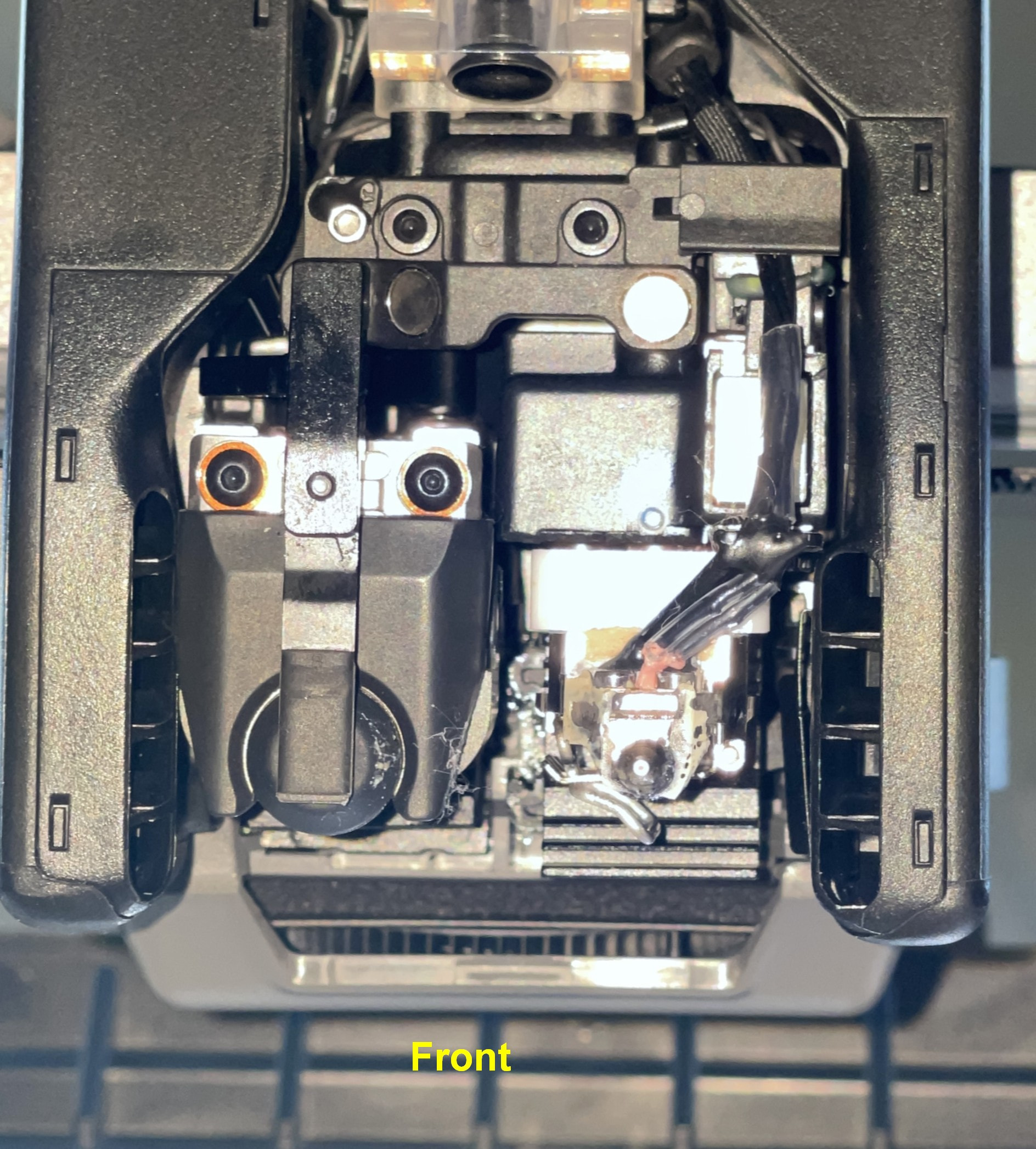

Howdy folks. My left nozzle is working fine but when I was dealing with stuck filament in the extruder I decided to remove the left nozzle but it wont budge. It’s in there solid. Am I doing something wrong? It looks like PLA is stuck to it holding it in place, but I admit at my age it’s very hard to see up close at that angle. And my iPhone 12 max doesn’t do a good job for up close. I’ve attached some images and I have a couple of videos if that’s better. Thanks everyone.
Some filament may have found its way between heater and nozzle and has set in when cold.
I would heat the nozzle to 250C and try to get the nozzle out. Do not use your fingers but a pair of tweezers or a small pliers.
