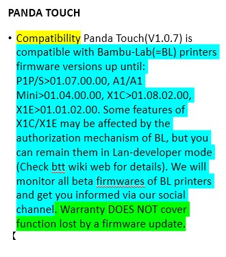

So, I was looking on Amazon yesterday night to see if Bambu Lab had any items for sale and came across this cautionary text from BIQU relating to the Panda Touch.
I don’t know exactly when Bambu Lab rolled out their firmware update, 01.08.00.00 and then promptly pushed out 01.08.01.00 due to issues with 08.00 but seems like 4 weeks or so back.
I read that as the Touch is already out of date AND they’ll update the Touch firmware whenever
Actually, the panda touch can work past FW 1.07 but anything beyond will render all commands inoperable (you can still monitor) unless you select developer mode and LAN Only Mode on FW1.08 and beyond or stay with FW1.07. Problem is if you want to purchase a AMS2 or AMS HT you need firmware 1.08.00.00 so will kill panda touch commands unless going LAN only mode of course

This cautionary note is on the Amazon Panda Touch page as of today, July 25, 2025.
- 【Compatibility】Panda Touch(V1.0.7) is compatible with Bambu-Lab(=BL) printers firmware versions up until: P1P/S>01.07.00.00, A1/A1 Mini>01.04.00.00, X1C>01.08.02.00, X1E>01.01.02.00. Some features of X1C/X1E may be affected by the authorization mechanism of BL, but you can remain them in Lan-developer mode (Check btt wiki web for details). We will monitor all beta firmwares of BL printers and get you informed via our social channel. Warr-anty DOES NOT cover function lost by a firmware update.
I wrote this particular post on May 29, 2025 so almost two months ago. But the issue was known before May 29.
As of today I would take the continued cautionary note as BTT saying take it or leave it. We are not going to update the Panda Touch firmware beyond 01.07.00. and the warranty does not apply if you have more recent firmware.
