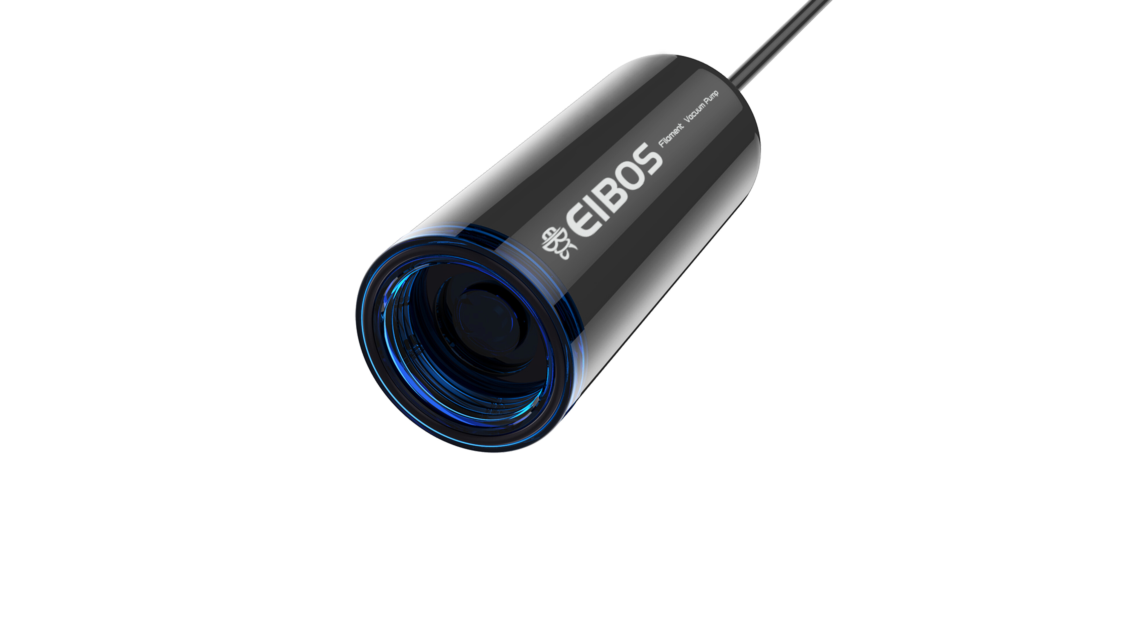

I’ve built 2 cereal dry boxes for my non-AMS A1 printer where I can print directly from the box with a bowden connector.
I’m just wondering if it’ll be a good idea to install a vacuum connector to remove the air from the box ? …less air then less humidity
…by using a pump like that ?
I think you’ll find those cereal bins have seals that are far from hermetic and any vacuum you put them under will quickly leak back to ambient. I wouldn’t bother. Get a filament dryer and dry before printing. Use the drybox to feed the filament so it stays dry while you’re printing.

Even if the seal is initially good enough to limit air exchange, creating a vacuum will collapse the container and probably pop the lid off when it distorts.

While this may seem like a good idea, it is only really a great way to waste time and money. If you want the TL;DR version, one needs heat to get the water to escape. While less air may reduce the amount of moisture, as @RocketSled has noted, there isn’t enough of a seal to maintain a vacuum.
