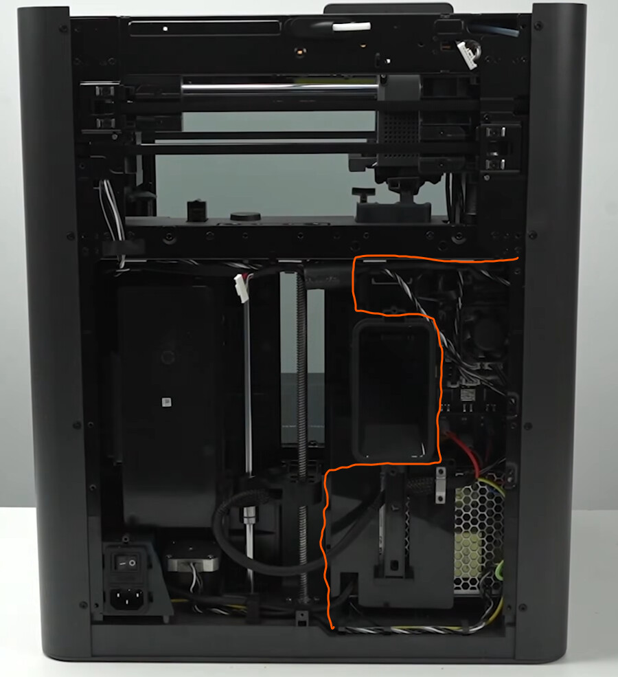

Anyone tried to make chamber perfectly sealed? I don’t like when heat and also fumes comes out of printer especially during printing materials like filled PC.
Exhaust filter and poop outlet is easy to seal, worse is with electronic grill. I don’t wanna to cover it because won’'t be air ventilation for electronic and PSU. I think only the solution is to design separated compartment for electronic to insulate them from printing chamber. Is there existing mod for that? or necessary is to design something like that from scratches? or maybe do you have other better idea?

I never said that I wanna to circumventing chamber temp control. I would like to isolate electronic from printer chamber to only use for cooling electronic cool air - electronic cooling will be ensured
I had to 2 diy printers Voron Trident 300 and Micron and for both of them all fumes stay inside chamber is perfectly sealed and electronic is cooled by external air.
You are focusing to much on fumes. Lets focus how to minimize heat looses through vents in rear panel.
If such what I described not exist, I will design sth soon.

On rear panel you have some vent grill.The easiest way to keep chamber heat inside will be cover them but then electronic doesn’t have ventilation and proper cooling. I would like to prepare some barrier to separate electronic from printing chamber - to avoid that heat will come out through electronic grill. Such thing allow to reduce heat losses, but ensure proper electronic cooling
