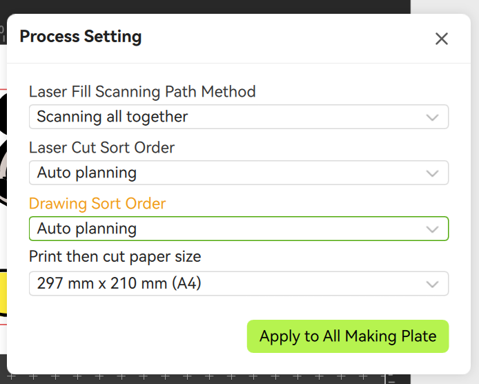

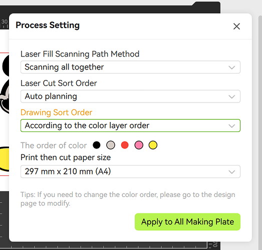

  1. In the prepare tab, you should click on the small gear at the right of the drawing file,
this will open this window
  1. You should then click on the Drawing Sort Order drop down list and select “According to the color layer order”

Wow, very much not straightforward. I had even changed the order of those little circles but when I previewed it made no difference. The key was that Process Setting window. Thanks a ton!
