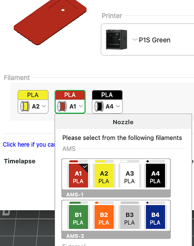

Look at these screenshots:
A perfect match, as I planned it as such.
A close match as the swatches did a closest match equation.
The original screenshot with an expanded AMS window, letting me choose that the model RED could use any one of the colours form those I have available.*
*If you have only four, the logic is identical, it just means you have four to choose from, but, again, YOU choose.

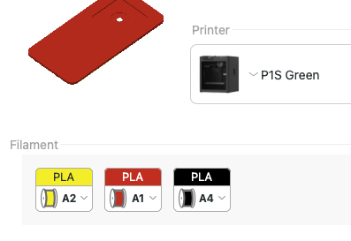

The original model, with a palette of 8 colours in the project filaments.
You will note it is painted (the paint icon on the right of the model).
I am showing the available choices from the drop-down, as I wish to change the purple to orange.
I selected orange, which you can now see uses the slot purple previously had.
The model and slot now show orange, exactly as I said.

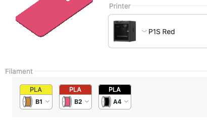

Now, when I go to print, the orange is selected; this is the way my first example explained, again, in great detail.
But, yet again, I can use my second example in this mix.
I have changed my mind just before I print and decide the orange I ONLY just chose, needs to be red.
I use the orange thumbnail and tell it to use the red from the AMS.
As you can see, the orange from the model is now red from the AMS, and the preview shows the frog as red.
We have gone from Purple to Orange to Red, all without repainting anything.
Both of the very detailed methods I explained were used just now, and both were used in the final set of screenshots.
