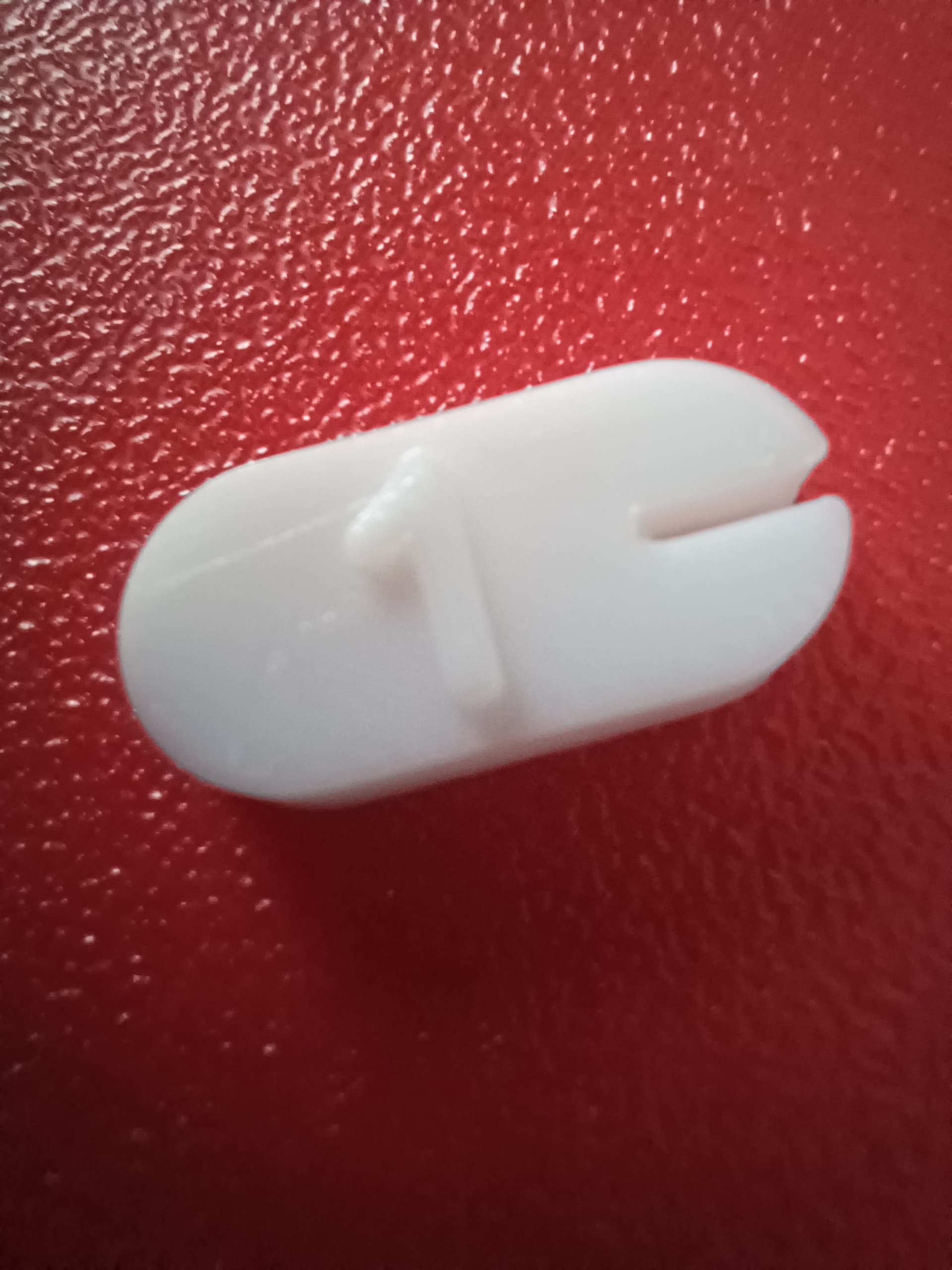

can someone please assist an old man. how can i change the colour of the number on this piece using ams, assistance appreciated
when you are looking at the model in bambu studio, select the object and then press a number 1-4 to the slot in the ams that you want to use.

sorry, i am printing the main body in white but would like the number to be red, when i try the change filament method it doesn’t stop to allow change
That will only change the whole model whereas the OP wants to change the colour of the top half, just the number.

thank you fellow printers, sorted it. so stupid, the the number on the ams i was changing it to was the same colour as the base doh!
