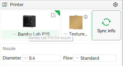

I changed the nozzle 0,8mm to a 0,4mm, changed the silcing and settings to 0,4mm nozzle.

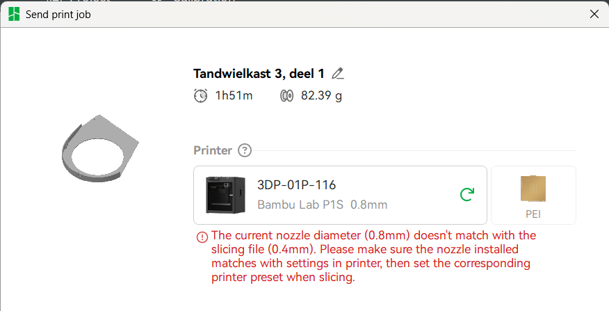

after slicing I got this message. But the nozzle in the printer is a 0,4mm and not the 0,8mm
How Can I change this? Do I need to change the setting on the printer it self?
change the nozzle in the printer settings (I dont know if the P series can do it remotelly like the H2 series, you need to do it via the screen)
