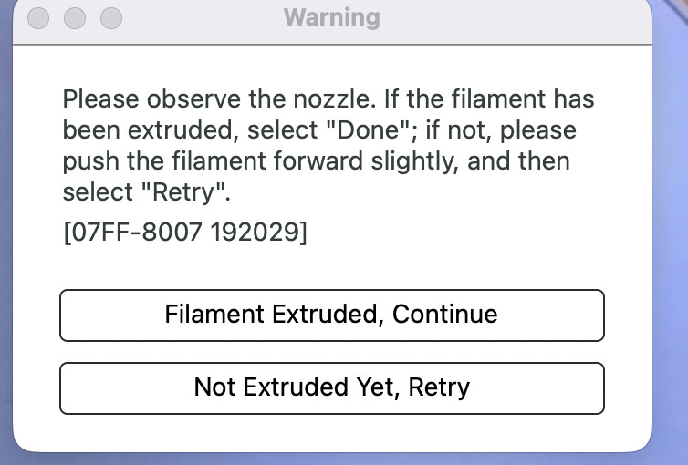

'changing filament' before every print recently?
Hi
Im not sure if this is a recent bambu studio upate or an issue my end, but before every print now I get a message popping up asking if filament has been extruded? regardless of whether ive checked flow dynamics before hand.
Is there a way to stop this happening at all?
thanks
Nick
Hi Nick
I've had the same problem for several months. Like you, I think it's a consequence of the latest update.
My setup: Bambu Lab A1 without AMS.
Firmware : 01080100
Please Bambulab team, help us.
Good Luck Nick
Super annoying to have to go physically to the printer when you have network connectivity. You might as well be using an SD card. Actually that would be less annoying because the print would not stop two minutes in.
Same issue here on my A1 Mini since firmware 01.08.01.00 (no AMS).
It only happens with the first print after (re)starting the printer, so I try to just keep the printer on as long as possible without restarting it.
its stopped for me now randomly - not sure why. I didnt actively do anything to my knowledge to stop it
