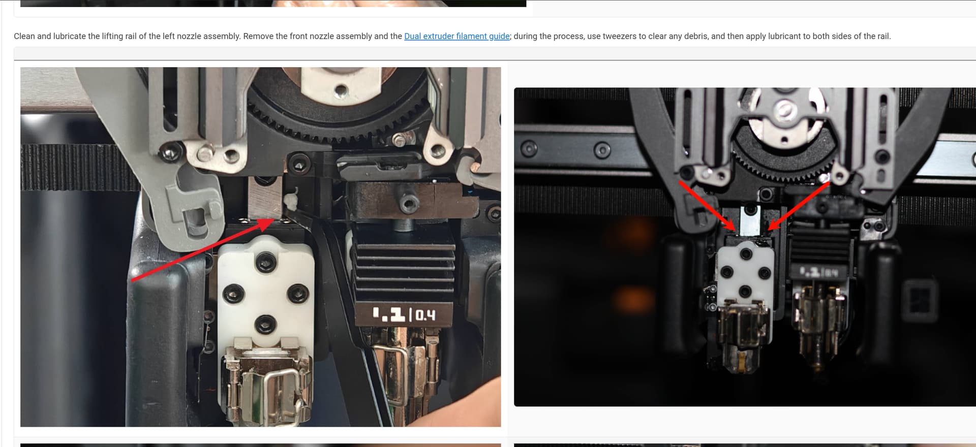

Did some recommended maintenance on the front nozzle assembly. Here is the location I lubricated

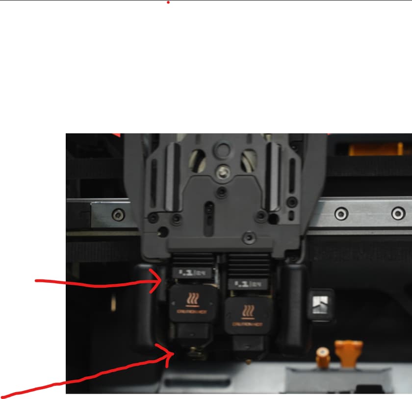

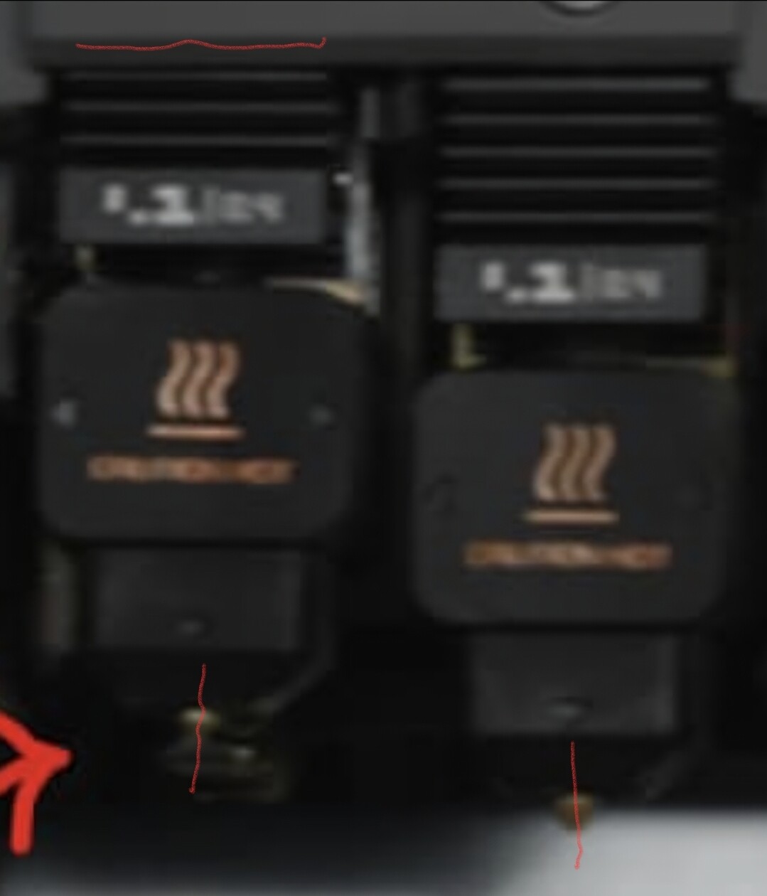

the picture below shows the hotends with the silicone sock on. The gap between the hotend and the top (top arrow) was larger than what you see on the picture. It’s almost like the sock didn’t want to go up high enough. Right side nozzle, no trouble. The pic below is not my machine, it’s how the sock is supposed to look, mine has a larger gap, I should reassemble the non-working nozzle and take a pic or video.

had to take off the cover (3 bolts), lube’d with oil and put the cover back on with the new nozzle, my first error was overload of some sort, check the filament path. My guess is the nozzle didn’t line up correctly. Took off the cover, removed and added the same nozzle (new) back in, silicone sock seems line it doesn’t fit correctly.

Compare it with a known good nozzle and see if one is shorter. Is there a qr code on it?
Also, the latch should be pretty easy to close. If its hard to close, the nozzle probably isnt seated correctly.
The socks look correct in the pic. They always fit loose since they attach from the front, instead of bottom.
Post pictures of your tool head. Can’t tell what’s going on without seeing it.
Could be crazy but it does look misaligned. Or a weird camera effect. Did you say you removed the plate behind the nozzle? Check the alignment of that plate
