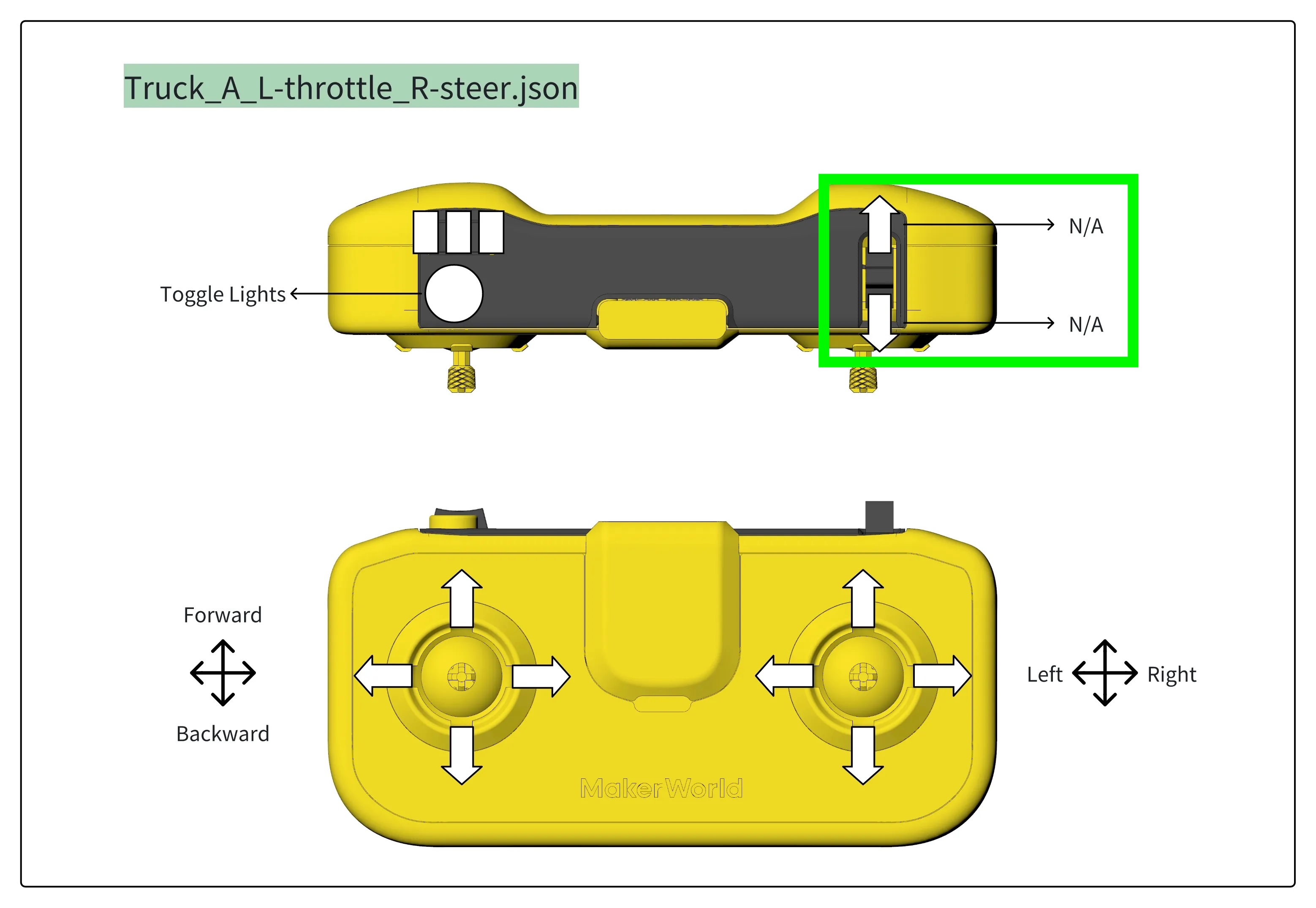

If so, here are the parts of the official controller that it uses:
I indicated in green the joystick that is “R Shoulder Stick” from your first post. Because this joystick is not used for this particular model, I think that could be why changing the value has no effect.
From what I can see, only the two front joysticks and top button are used in this project - if you try to edit the servo settings in these two joystick sections, are you able to change their direction?

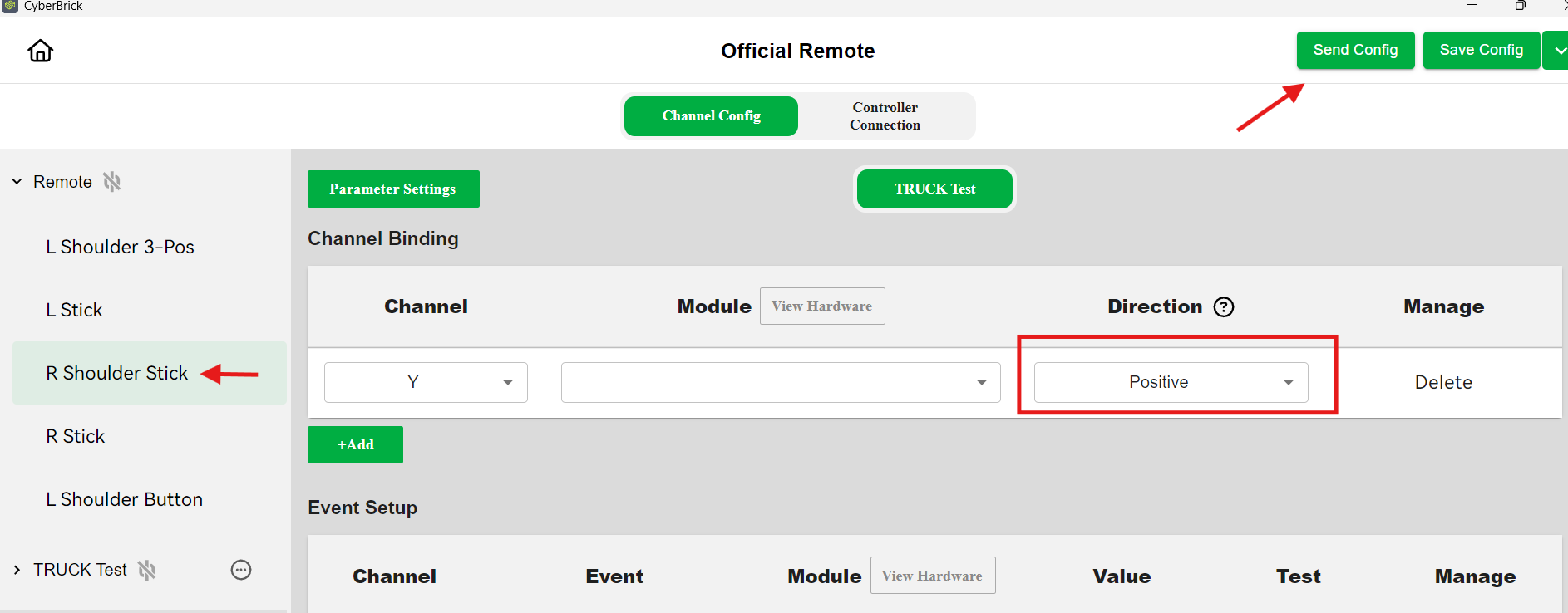

But I believe I figured out what happened. When I finished constructing both the transmitter and remote, I followed the core load procedure using the phone app. I selected the Official remote and they Cyber Brick garbage truck. It loaded both, and then I was able to control the truck. But the transmitter stick (the new 2way) was causing the lift fork to move in the opposite direction. So I loaded the desktop app.
At the bottom of the app screen, after I connected both boards, it showed the “official remote”.
that is what I was trying to edit.

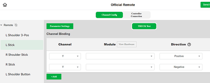

I went back to the simple remote listing, downloaded the JSON there, loaded it instead. This resulted in two configurations now showing:
I decided to try and edit this new one. Now all the drop downs are populated and I can change (the ones that were blank) and I can change and upload the value for the 2 way stick. So this resolved it.
