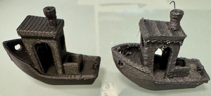

Here is a Benchy with Siraya Tech on the left and CHCKX on the right. Both spools dried at 85° for 12 hrs and printed on the H2C with a Diamondback 0.6mm nozzle.

85C is not enough to fully dry these polymers my guy. Not if they’re really wet, which I wouldn’t put past chckx. I’m extremely invested in this though — can you dry them at higher temps and post results? Would the spool handle 110C+ temps?
85° is plenty if you adjust the drying time. The spools are (supposedly) PC so, no 110 is too much. PPS itself is not a particularly hygroscopic filament. It doesn’t require aggressive drying. The “PPS-CF” I suspect is actually ABS-CF since the density is too low for PPS. The “PPA-CF” is most likely PA6-CF.
I also compared it to PolyMaker Fiberon and Siraya Tech filaments under the same drying conditions. The results are much better. The PPA-CF was actually dried for 24hrs at 85°
But you are welcome to buy your own spools and run your own tests. I’ve already returned them.
