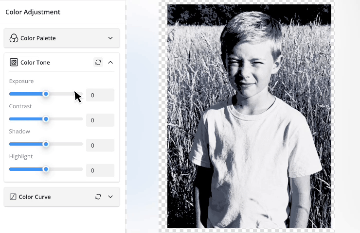

The customization process is as simple as editing a photo on your phone
  1. Upload your image.
  2. Try different “color palettes,” just like picking a filter in a phone app. With these two steps, you can easily get a satisfying result.
Click here to see how easy the process can be

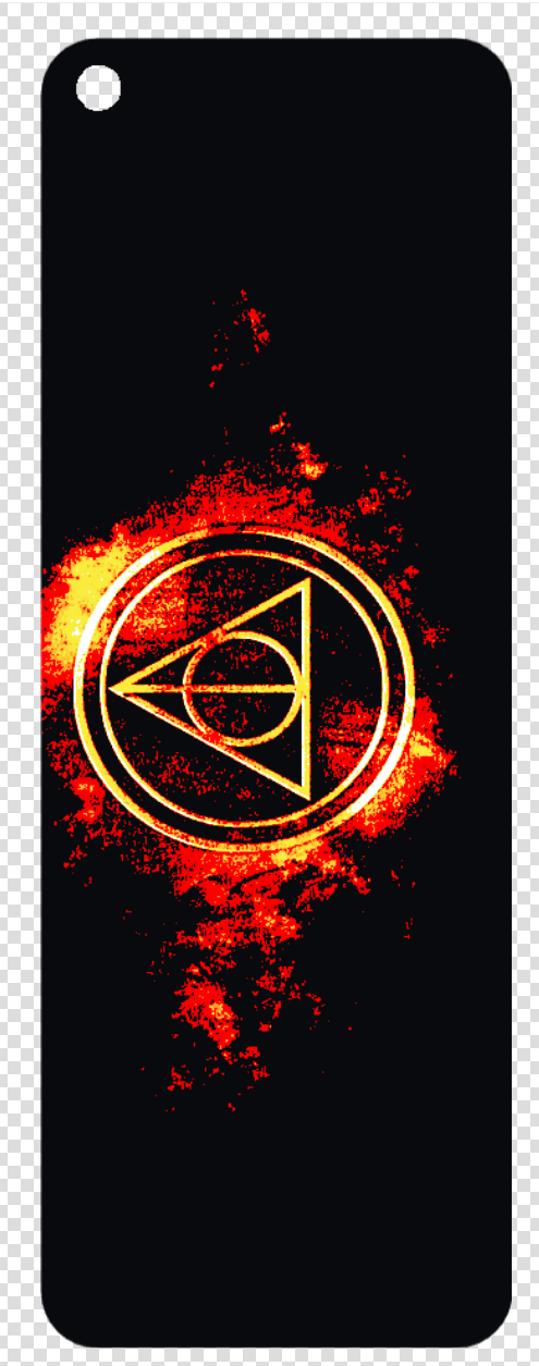

The “Deathly Hallows” Test:
  • The Expectation: One screenshot shows the render of a Harry Potter graphic. It looks clean, the lines are sharp, and the color separation is distinct.
  • The Reality: The physical print failed structurally.
    • Fragility: The print actually fell apart in my hands.
    • Transparency: You can literally see through parts of the print. It seems the software generated walls so thin (or with insufficient infill density) that they became translucent and brittle.
    • Definition: The sharp geometric lines of the triangle and circle are jagged and muddied.

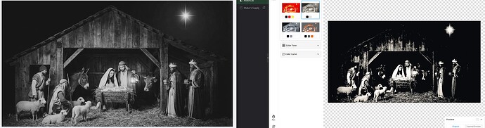

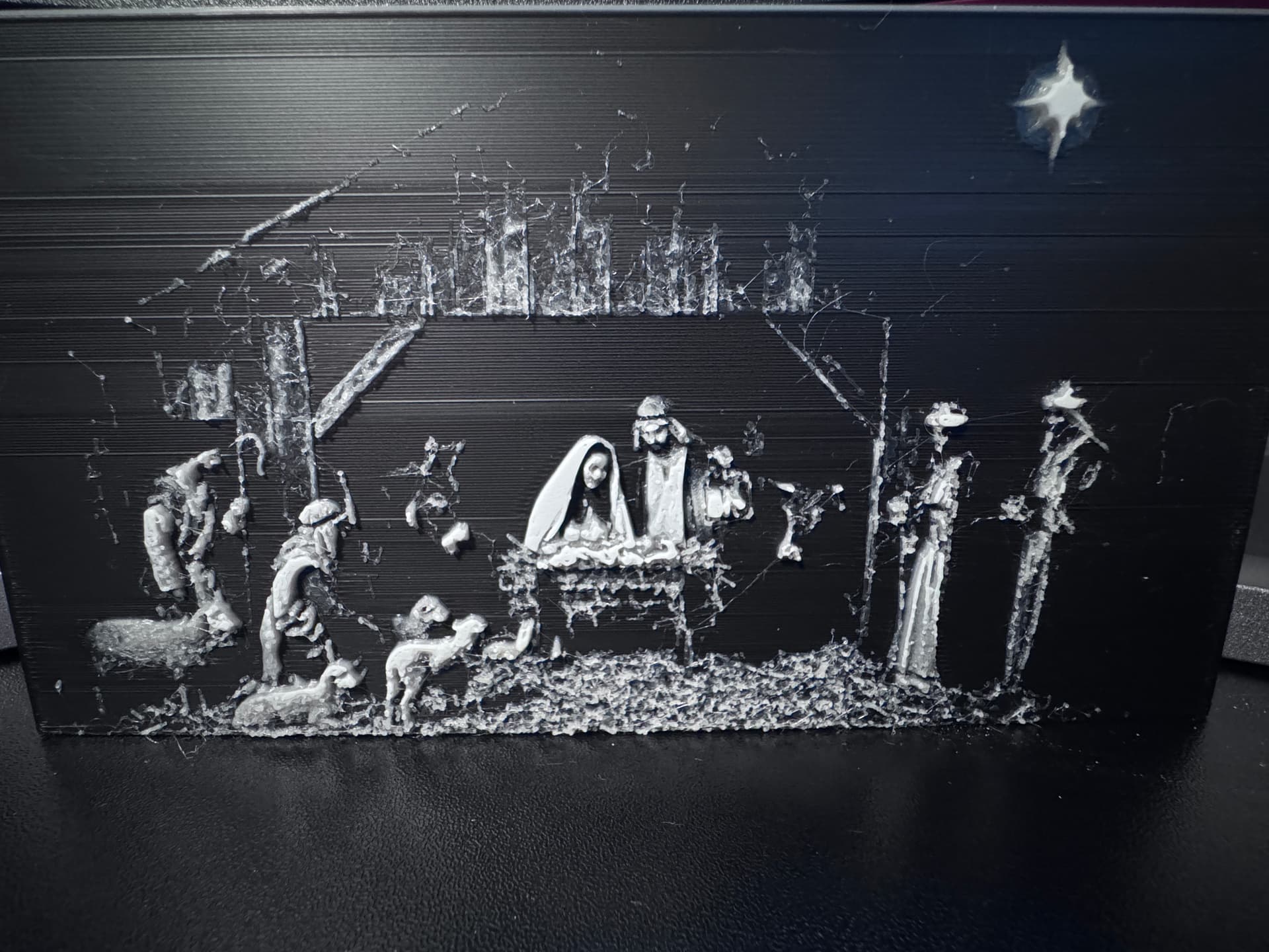

The “Nativity” Test:
  • The Expectation: I imported a high-contrast, black-and-white photo of a Nativity scene. In the Chroma Canvas preview (split-screen image), the software did a decent job converting the photo to a printable model.
  • The Reality: The final print is essentially unusable. It resulted in a black block with white blobs. The fine details of the straw, the figures’ figures, and the roof texture were turned into stringy, undefined plastic artifacts.
My Critique & Suggestions for Bambu Lab:
It seems like the software is generating G-code that is technically “correct” regarding coordinates, but it isn’t accounting for the physical limitations of FDM printing (nozzle size, wall thickness, and layer adhesion) when generating these specific pixel-to-voxel structures.
Suggestions for improvement:
  1. Structural Integrity Check: The software needs to ensure a minimum wall thickness. Generating single-wall loops for color details makes them brittle and see-through. There needs to be a “solidify” option that ensures colors bond to the main body.
  2. “Printability” Preview Mode: The current preview is too optimistic. We need a view that simulates the actual nozzle width. If a detail is too small to be printed clearly, the software should warn us or blur the preview to match reality.
  3. Minimum Feature Size Control: Give users a slider to filter out “noise.” In the Nativity scene, the software tried to print tiny specks of white (straw) that resulted in stringing. Being able to set a “minimum print area” would clean up the model significantly.
  4. Optimized Retraction/Travel: The amount of stringing and blobbing suggests that the travel moves generated by Chroma Canvas aren’t optimized for these dense, multi-color islands.
Has anyone else had better luck tuning these, or is this just the current state of the beta?

I have tried this tool a few times and got decent results by:
  1. Use the color adjustment controls.
  2. Use 4 or more filament colours.
  3. Use 20 to 30 total layers.
A grey scale image (black and white) like your nativity image, need at least white, black, dark grey and light gray filaments. Layers of white on top of a black layer, makes very few gray tones before it is just white.
Make sure that there are at least 4 layers of black at the bottom.
Hope this helps.
