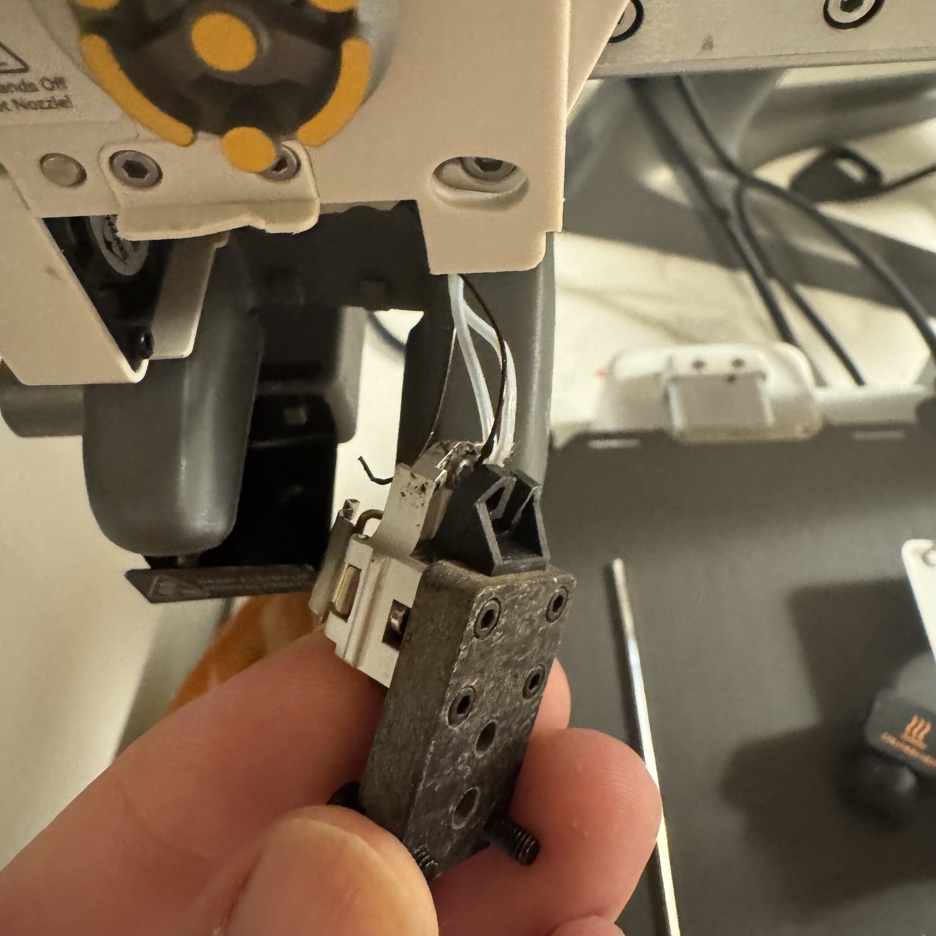

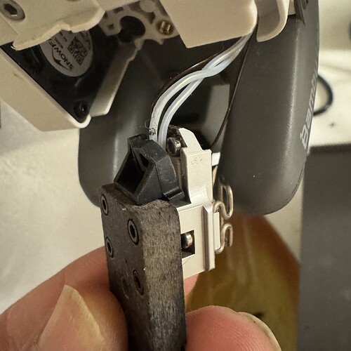

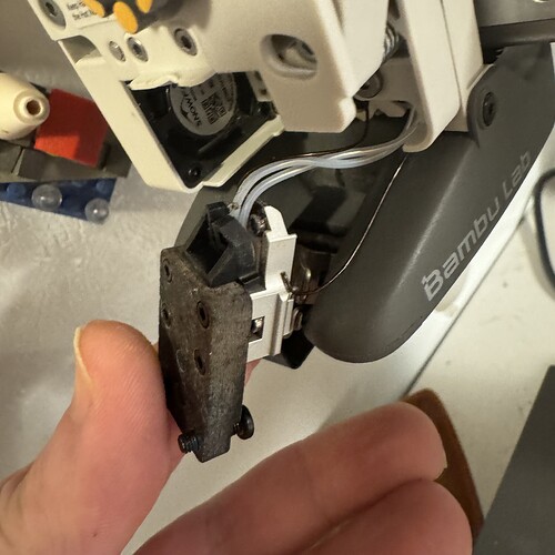

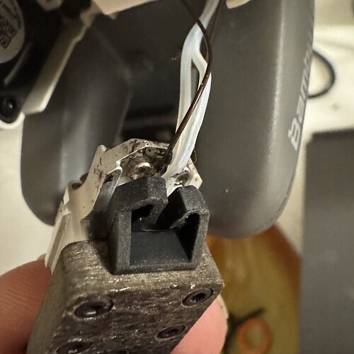

So I was cleaning the nozzles of my H2D with a brass brush after setting the temps to like 140c to remove any gunk on the nozzle tip before replacing the silicon socks when all of a sudden I thought I noticed a spark and the machine powered off and then after a few seconds powered itself back on. Did I make a mistake by cleaning the nozzles with the machine powered up? I printed since it reset and there do not appear to be any lasting effects but it’s concerning none the less. Is this possibly some static or electric build up with the eddy sensor or something at the nozzle tip?
Jep. You probably hit the wires of the heating assembly and caused a short. Look at the blank wires below your nozzle (not just the thermistor).
Yes, never do any matinence with the machine on. If you need to heat up a nozzle do it with a lighter or something. That was very dangerous and may have damaged the printer. Be careful.
Well good to know. Never even considered I could cause damage when the heaters were off. I didn’t even think about the thermistor. I will remove the nozzles to clean them in the future and use a torch or heatgun.
Also super glad that I didn’t brick my machine or cause some serious damage (or at least it’s not yet apparent)

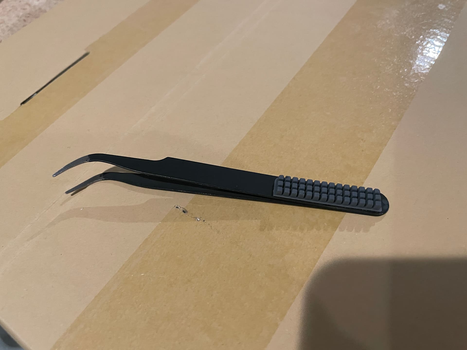

I clean my nozzles with one of these,

The fact that those wires are exposed is jank AF if we are being honest here.
This is how it’s supposed to look, you can see the ball of epoxy where the wires attach. So someone is missing a step in the factory. Those other two skinny wires are the thermistor which use ceramic coated wires (and also pass basically 0 current) and would have no issue even if they were shorted (temp reading would just go to 0 for a split second lol)

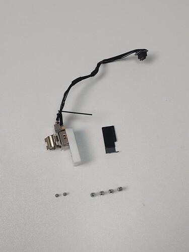

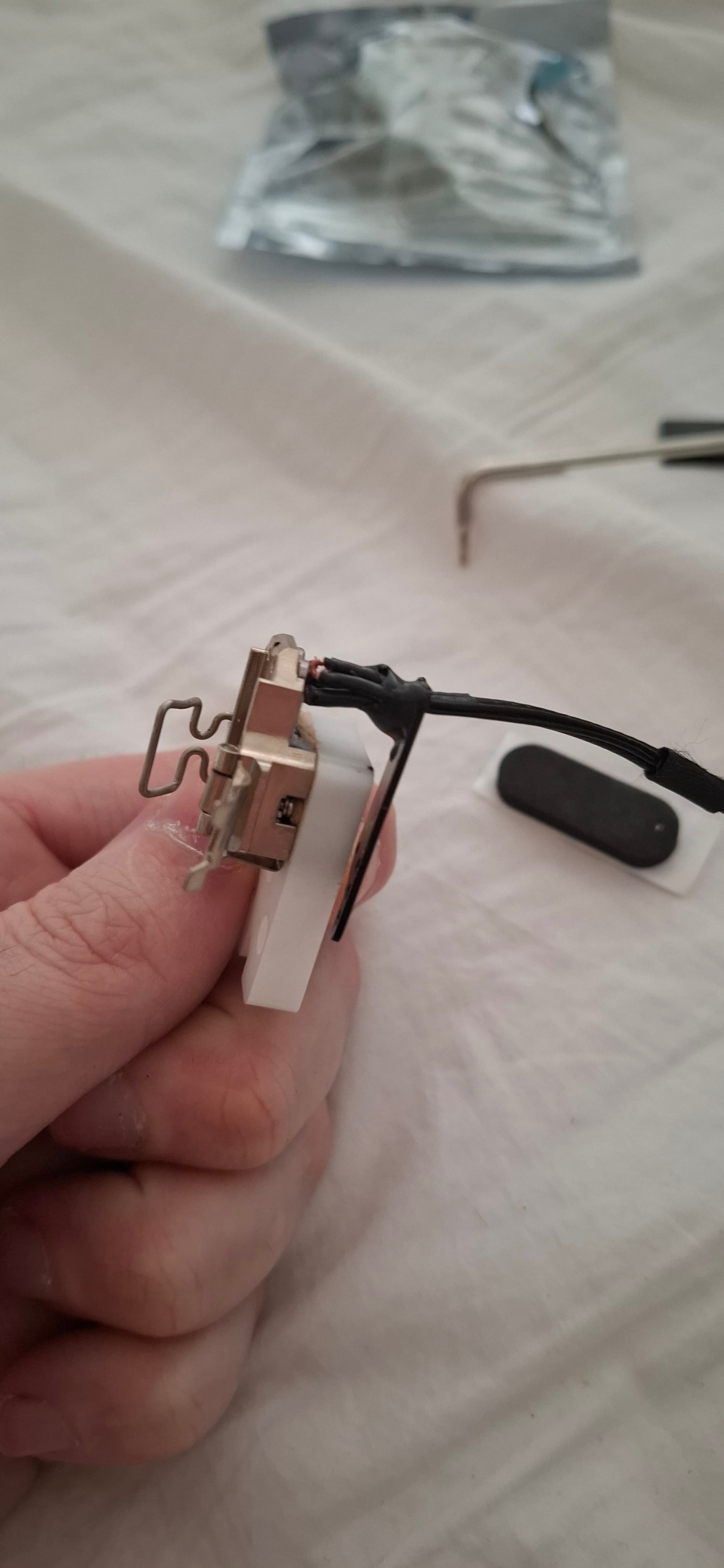

Last night my a1 mini suddenly reported “ nozzle temperature is abnormal, the sensor may be open circuit” so I took out the nozzle to inspect the heater assembly and 1 of the 2 black tiny thin black wires came off it. I was wondering if I could solder it but it’s so tiny I have to take apart the heater assembly to see where it is supposed to go. I bought and installed this heater assembly for $20 due to the area holding the clasp being eroded and now looks like I may need to buy it again.
Looks like they are ceramic coated. Just scrape off the coating and give it a shot. Worst case you are just back to buying a new one.
