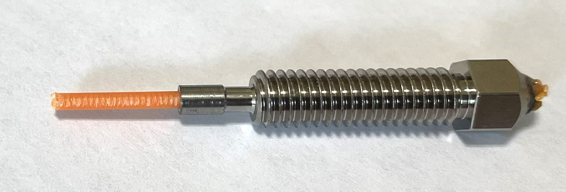

I’ve run into the same issue about three times recently with my P1S. During a print, after several successful filament changes through the AMS, the printer suddenly develops what looks like a clog (photo attached). When this happens, the next filament tries to load but can’t, and the AMS sends it back.
This has happened with both white and orange PLA. The orange spool is Bambu Lab PLA (500g) that came with the P1S Combo. I bought the printer in August 2025, and the filament was stored in a vacuum bag with desiccant until I opened it for this project.
In previous occurrences, I was able to clear the blockage by heating the hotend to 250°C and pushing it through with a No‑Clog tool from Amazon. The hotend is a Microswiss unit that has worked flawlessly for about six months.
At this point I’m not sure what’s causing these sudden clogs or failed filament loads. Any suggestions would be appreciated.

It’s possible that the different thermal behavior of that hotend is allowing heat creep during filament change.
If you have a caliper, check the filament diameter at the point where there’s an issue, that will confirm heat creep, otherwise you could just hold some of the “regular” filament up next to it to do a visual comparison.
