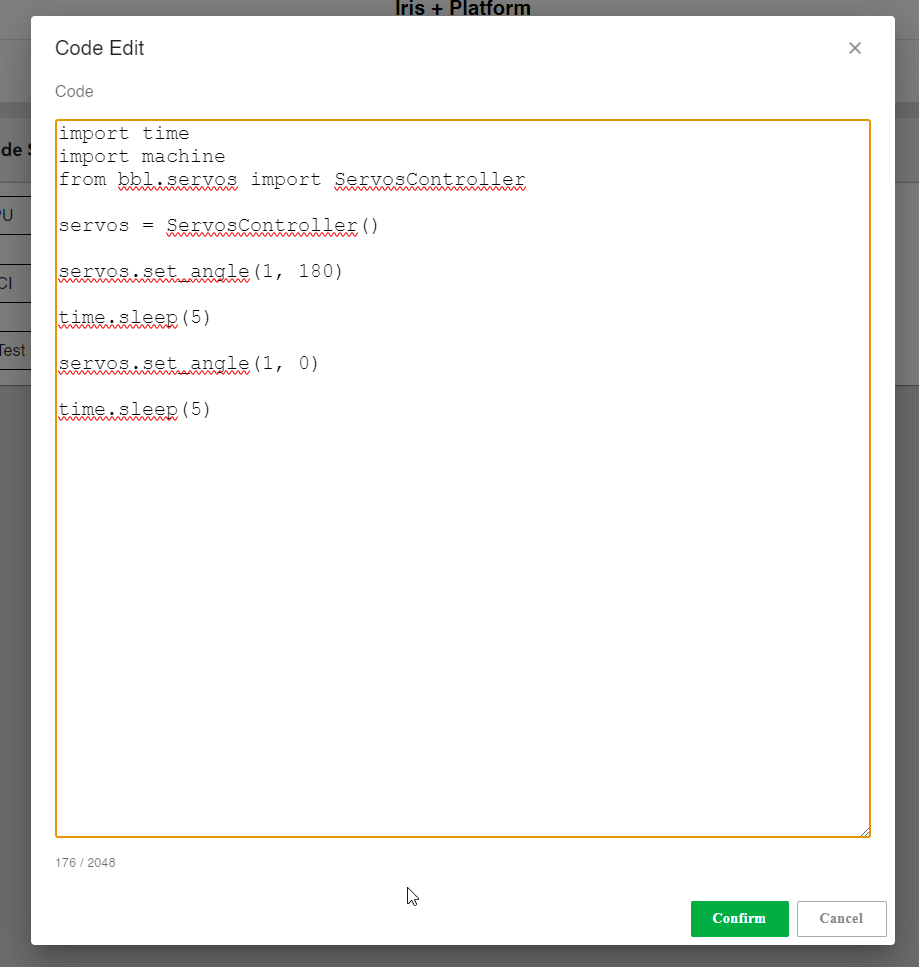

I’ve managed to make a code block that can move the servo to a specific angle:
import time
import machine
from bbl.servos import ServosController
servos = ServosController()
servos.set_angle(1, 180)
time.sleep(5)
servos.set_angle(1, 0)
time.sleep(5)
This will move the servo to 180 degrees, wait 5 seconds, then move it to 0 degrees before waiting another 5 seconds and then ending the script. I built it using the syntax info here: ServosController — MicroPython for CyberBrick V01.00.00.03 documentation
