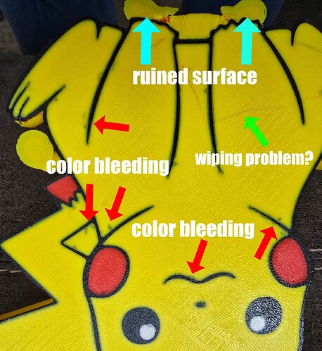

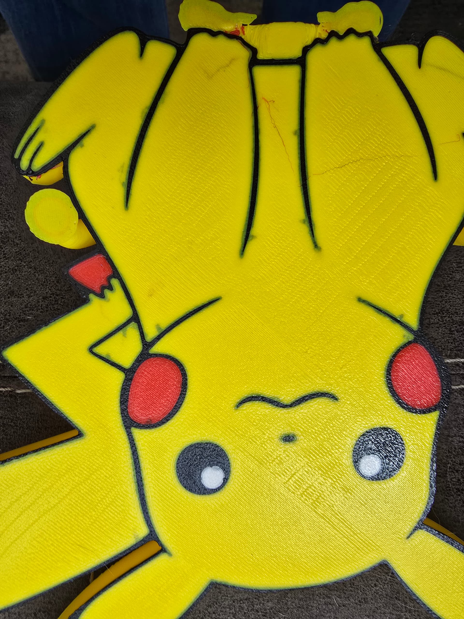

This happens with all of my A1’s and P1S. We sell a lot of multicolor prints that we print face down so the surface comes out smooth and crisp. About half the time there is a blemish, a little piece of the wrong color filament that ruins the print. Unfortunately we don’t find out until the 4-hour print is done. It only takes a tiny bit of red filament on a yellow or white section to ruin it.
We tried touching up with acrylic pens but it’s amateur and we can’t ship it.
I installed a mod on my P1S that incorporates an A1 wiper but I still get blobs.
Any fix for this?

Other than that, the gcode is the more important part. You need to wipe in between every color change. Even if it adds a few minutes.
Increasing purge will help as well. You are putting yourself in a non ideal position when using red and yellow. Although this does not sound like the color is bleeding. Post some pictures up of the issue.
Not sure which wiper. I pulled it off of MakerWorld. But the latest issue happened on the A1.
Are you saying increase flushing values? I’ve been reading about it today but have never changed those.

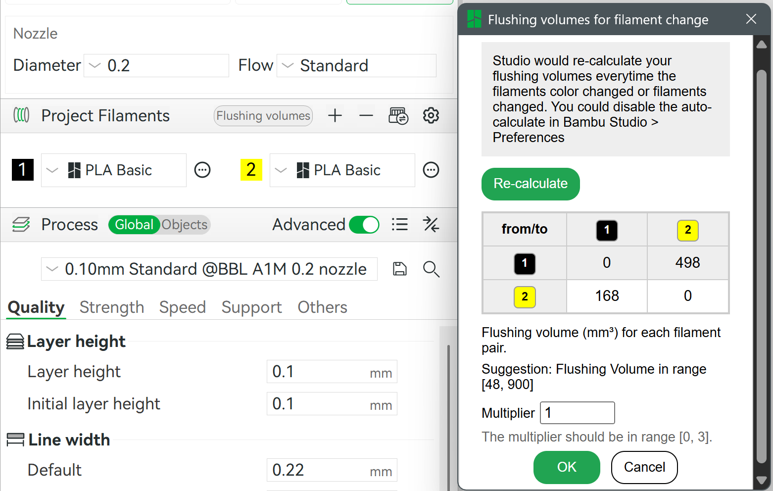

Increasing purge values will help. But let’s say “tune” Purge values. Start with high purge and turn the values down little by little as long as quality stays the same.

This took 4.5 hours to print and I have to throw it away. Seems insane to start another one without changing anything.
In addition to the tips you have already received: Have you increased the flush volumes yet? It’s almost mandatory, especially for yellow and black. Clearly, you are experiencing colour bleeding too, which suggests that the nozzle was not clean.
These are just the standard values, which should be increased:

What you have there is definitely not just one error, but many errors.

These are my current stock values.
