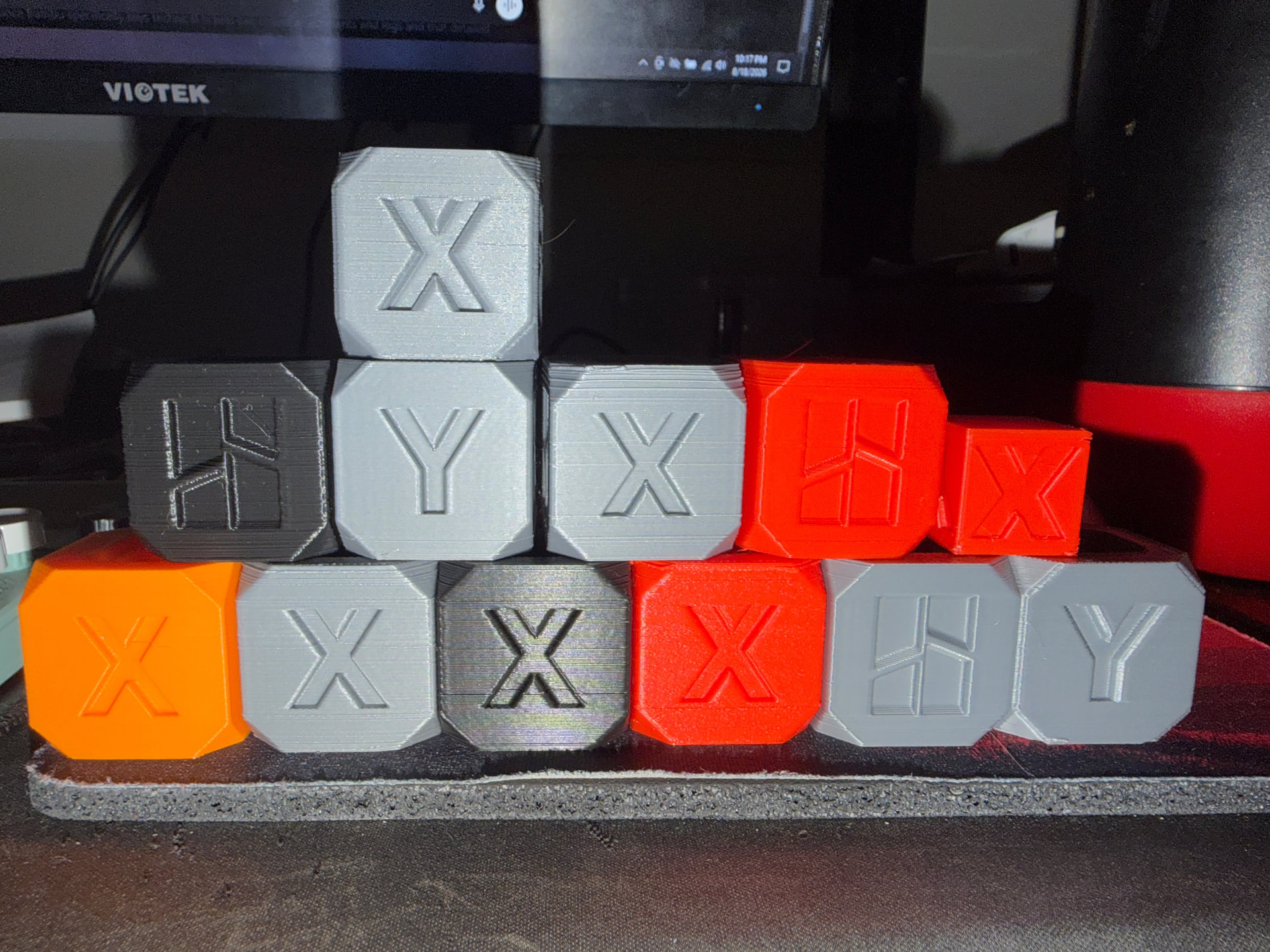

My A1 Mini began producing inconsistent prints and inaccurate dimensions. Before contacting Support, I performed extensive troubleshooting and provided multiple photographs showing the problem occurring with both Bambu and generic filament.
Despite this, Support told me:
“It looks like the issue is low quality filament, as the bambu filament prints look perfect.”
The Bambu filament did not produce a perfect print. It was only marginally better, and my photographs showed that the same underlying problem was still present. I explained this to Support.
From my perspective as a customer, this was particularly frustrating because Bambu filament retails for roughly twice the price of the generic filament I was using. Being told that my problem was caused by “low quality filament” and that Bambu’s much more expensive filament was the apparent solution felt less like a diagnosis and more like being directed toward purchasing Bambu’s filament before the printer itself had been properly diagnosed. If I had not pushed for further help, I would have been stuck with the same issue, having wasted money on filament that I did not need to spend money on.
While waiting for their next response, I continued troubleshooting and discovered the actual issue myself: I had been using the wrong lubricant on the printer’s motion system. After completely removing the old lubricant, the problem was resolved.
I fully acknowledge that using the wrong lubricant was my mistake. My concern is that I provided evidence showing the problem persisted with Bambu filament, yet Support still identified filament as the apparent cause before establishing whether the printer itself had a mechanical issue.

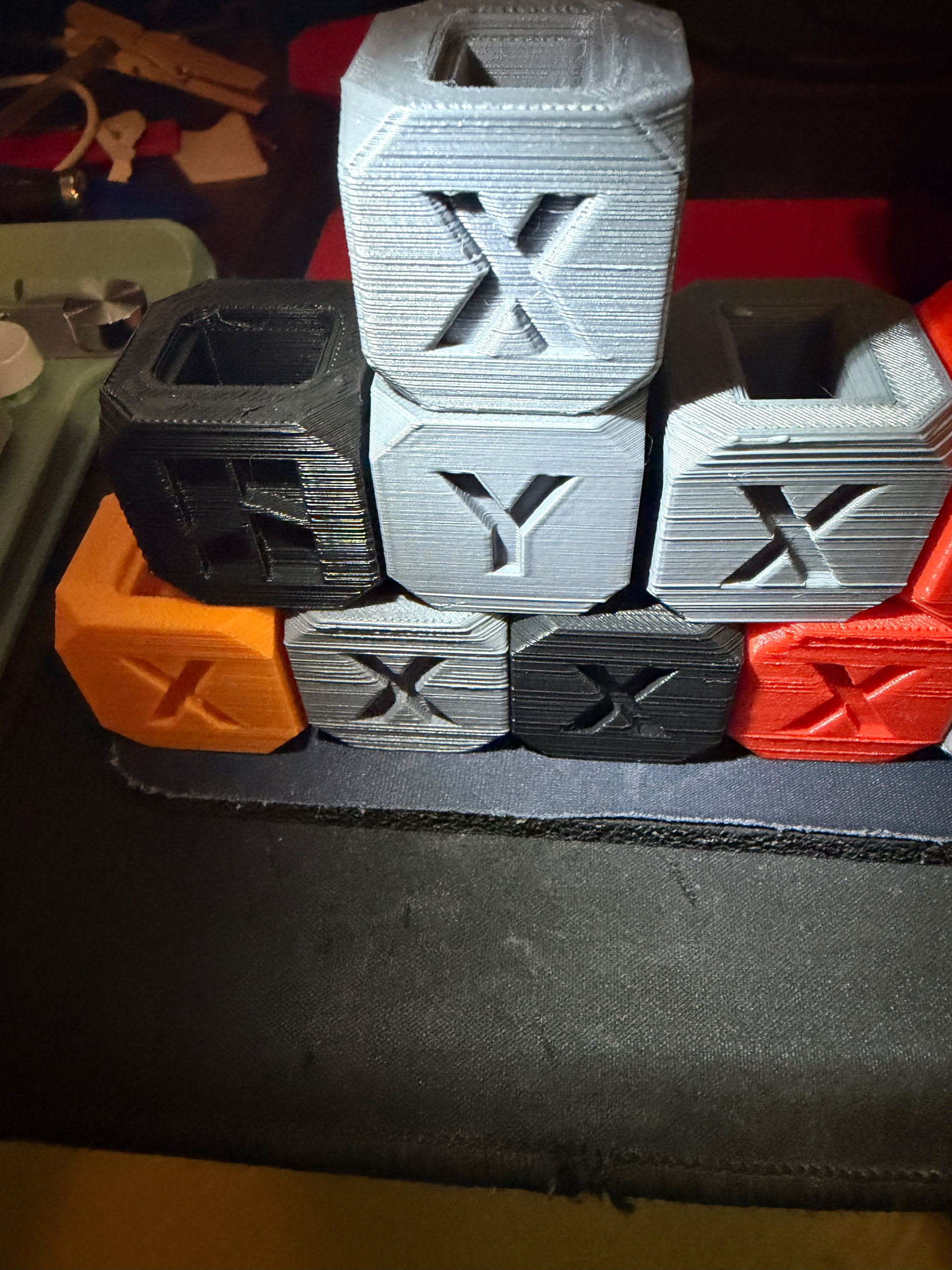

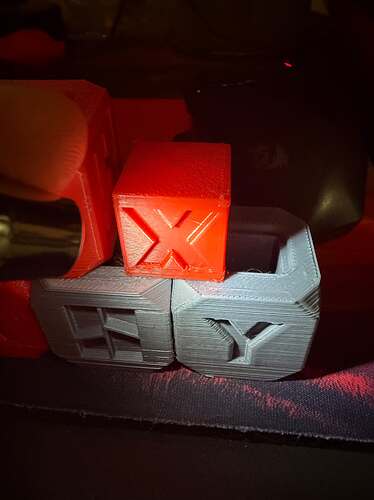

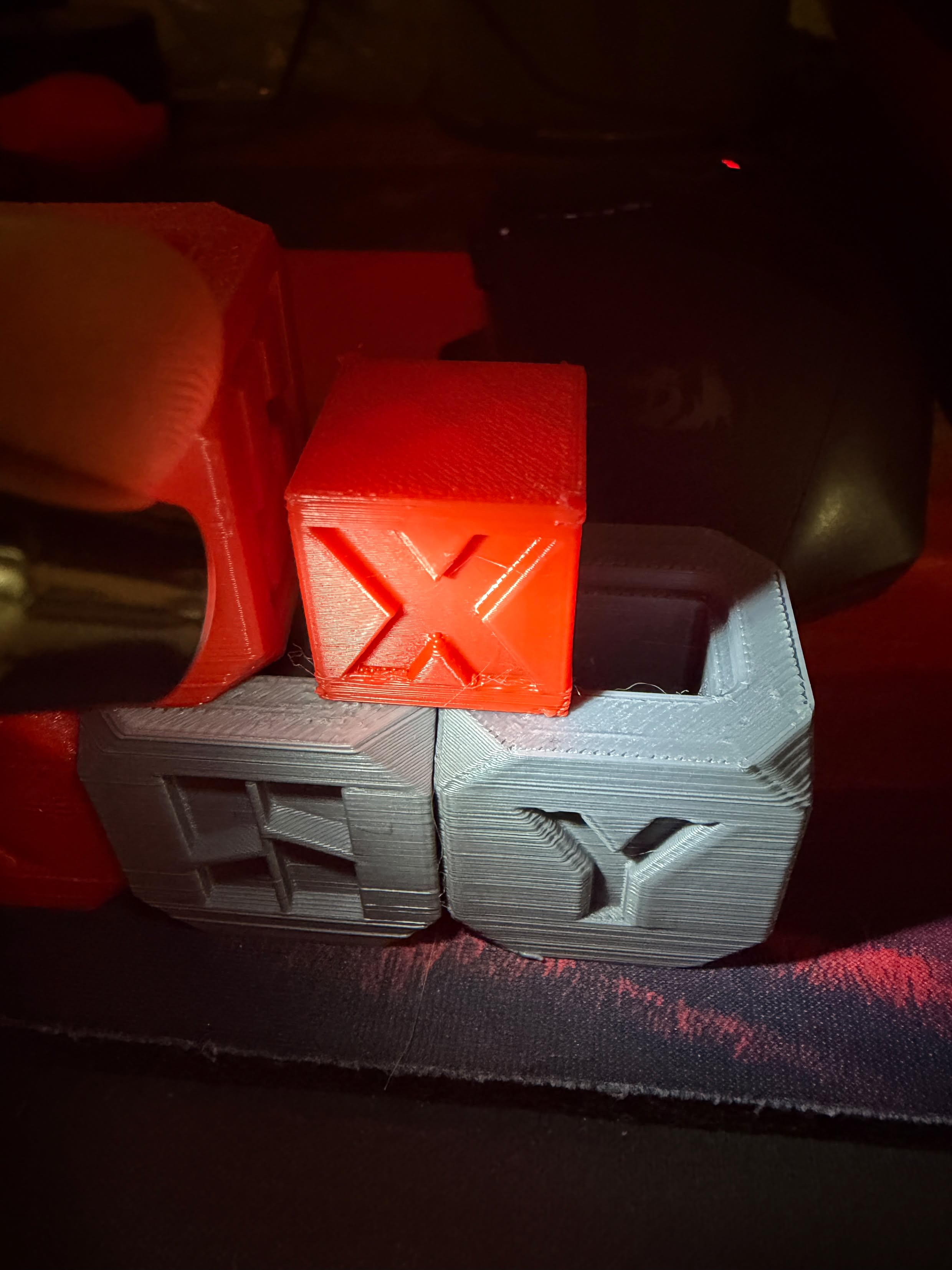

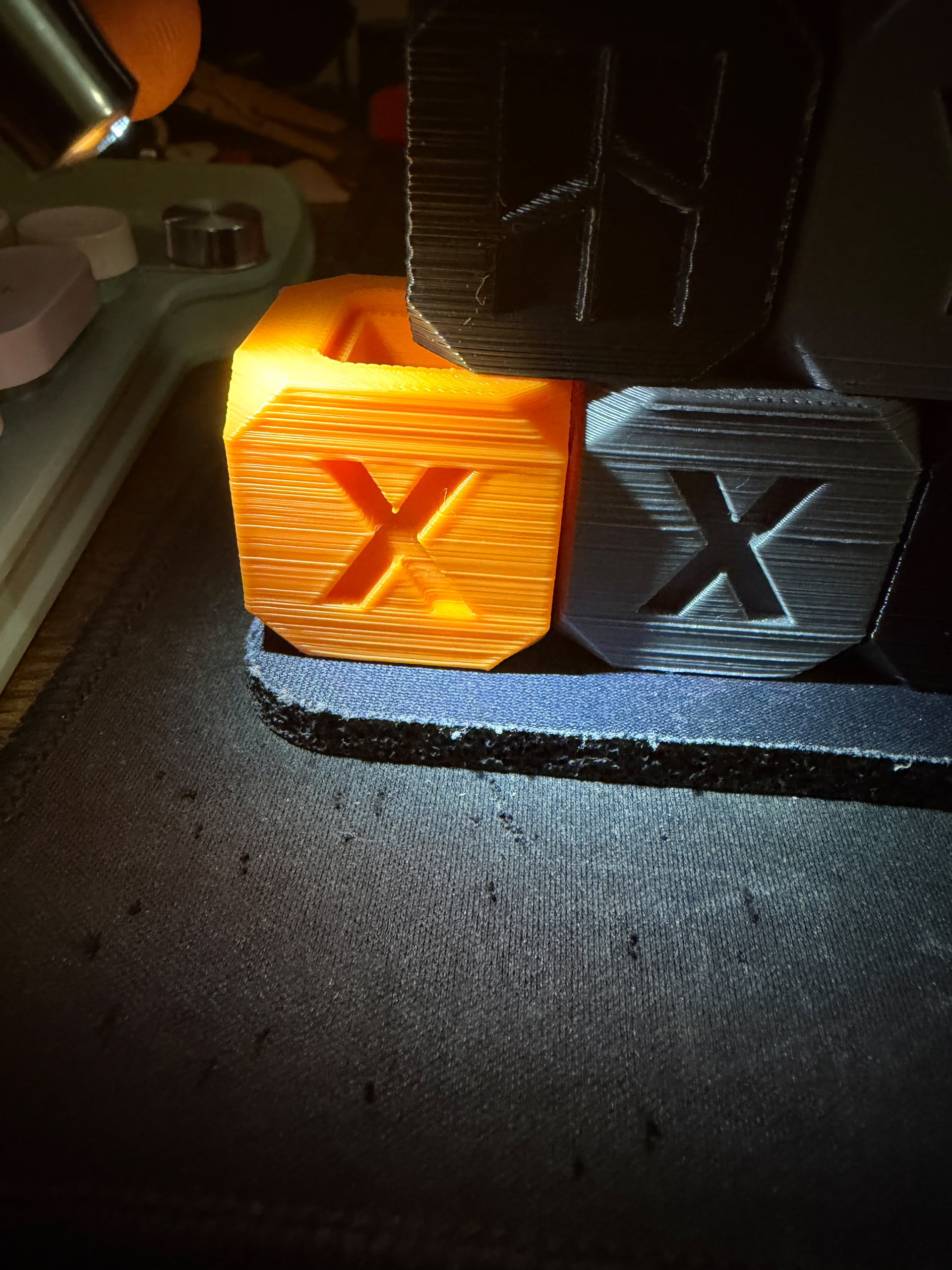

Gladly. As you can see, all of the prints, regardless of orientation and print direction, had the same banding. All prints were made from generic filament, with the exception of the orange cube, printed in Bambu PLA basic. The rest were printed from Kingroon PLA+, a filament that I’ve been using for 3 years now, without issue.
I gave support a comprehensive list of everything I had done to troubleshoot, including firmware and software updates, belt tensioning, cold pulls, unclogging with a “needle” tool, changing nozzles, changing filaments, lubing the Z screw, drying filament, watching the Z screw and seeing no side to side motion (to rule out a bent Z screw), and I even went as far as to disassemble the entire extruder assembly to clean it out (and it was basically spotless, but I still brushed out small bits of filament dust). After all of those fixes, I had come to the conclusion that the extruder was the likely culprit, so I asked support if I could get a new extruder as an act of goodwill. I gave them print logs and everything, so it felt a bit insulting to have it all chalked up to being bad quality filament, because I knew this same spool of filament printed fine on my other printers just a few weeks ago.
Some filaments just show more banding because of color and shadows. Thats where the confusion might be.
I havent used kligroon, but I havent heard anything too terrible about it. I assume you are using a custom tuned profile for it?
First thing I would check is the hotend assembly. Making sure it is tight and the nozzle is installed correctly.
Look at point 4 in this wiki article…
Second thing I would check is your belt tensioning…
The extruder is a wear component. You will need to buy a new one. They are decently cheap, buy two while you are at it.

To their credit, that is exactly what bad quality filament can look like when shoved thru an otherwise functional machine. But seeing the orange cube, which you say is a diff vendor, would suggest a different cause
