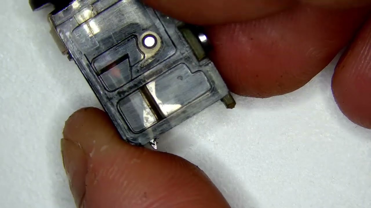

  • I have sharp clean ptfe cuts. The filament sensor design is fundamentally flawed. Literally have little steps cut in it for filament to catch on.

  1. the filament sensor design is wrong and catches on the filament.

Heres a video of talking about the design flaws of the filament sensor:

Thanks for that video. You have gone into a nice bit of detail on the sensor.
Having checked my spare (my active one does not have any issues), the PTFE connector does have some play but nowhere near as much as shown in your video. The installed one does not have any play in my X1, so together with the z-sliding tube guide bracket above it (did you install a mod there?), I do not get any out-of-plane connector movement.

So initially I followed your reasoning that the Filament sensor had a unique issue. Not just on the entry side, but also in its actual filament detection.
With the Video showing an empty filament guide path, I am not so sure anymore though.
