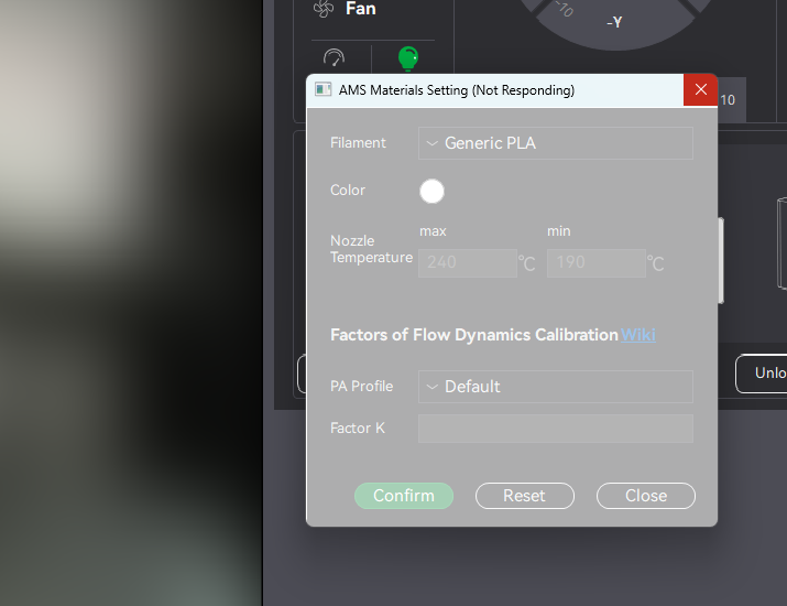

I am on the newest Bambu Studio 2.4.0.70, and I have reinstalled it to see if that would fix it. It has been running perfect for a bit and all of a sudden when I go to the device settings, and attempt make changes to the colors on any of my printers. Heck even select one of the six I have in the list this thing will lock up for 3-5 minutes, then does it again once I select a color, and hit confirm.
I know it isn’t a PC issue, I am running everything else just fine on a i9 12900k, 64GB ram and a RTX 5070. Unless there is some sort of interaction between the device area and the GPU, which could be possible with the live video in there(which I am not using).
Anyone else run across this?

This is happening to me, too - printer P2S Studio 2.4.0.70. I’ve noticed it about 5 days ago. Issues mainly on device page: video streaming slow to start and sometimes even throwing error 403; XYZ commands took 20 seconds to execute (although funny enough sometimes XY commands were slow and Z commands were quick to respond and sometimes it was reversed). Interesting was that Bambu Handy on the same network was not affected and also direct controls on printer are OK. I was not aware of any changes done on my PC, so I started some investigation.
  1. I was suspecting network issues and maybe connectivity to Bambu Lab servers, so I decided to switch printer to LAN mode. I started capturing network traffic with WireShark and didn’t find any obvious network problem. All connection conversations seemed to be established correctly and bidirectional traffic working as expected. Bambu Studio still does some communication to internet, but the communication with printer seems to be LAN only and OK. Later I found communication is still over the LAN even if LAN mode is disabled but printer and studio are still able to establish direct connection over the LAN. So I started investigation on client side.
  2. On the same PC using Oracle VirtualBox I installed Linux Mint 22.2 and Downloaded Linux version of Bambu Studio. Logged into my account in Linux version of the Studio, synced the configs from the cloud and checked the Device tab. Eeverything worked as expected, no delays, no lockups.
  3. At this point I decided to switch back from LAN only mode to cloud mode and to perform full reinstall in Windows (still the same PC). Uninstalled, deleted everything in ‘C:\Program Files\Bambu Studio’ and ‘%USERPROFILE%\AppData\Roaming\BambuStudio’ and reinstalled Bambu Studio. Logged with the account, synced the configs from the cloud and checked the Device tab. Everything worked as expected, no delays, no lockups. Well well, worked, but only for 1 day. I printed one thing with reinstalled Studio and am seeing lockups again.
  4. Out of curiosity I checked my Linux Bambu Studio and that one is still working with no lockups or delays. On the other hand, virtual machine has limited resources and mainly VRAM is only 256 MB. Not sure if it is because of that, but Studio is sometimes crashing there, so for normal printing I am sticking to Windows installation.
My conclusion is this is definitely client side issue and only Windows client seems to be affected. Linux client and Bambu Handy app seems to be unaffected, too.

Just heard back from Bambu. TLDR: Issue still not rest but they had me try this.
For your current issue, we suggest navigating to the C:\Users\Your User Name\AppData\Roaming directory and deleting the BambuStudio folder. After that, check if the problem is resolved. Please back up the user folder before deleting it, as it contains your custom parameter files.
  1. Help-> Show config folder to find the the directory of the config folder
  2. Close Studio
  3. Delete the folder
  4. Empty Trash
  5. Open Studio again
It actually seems slower now…..
I’ve tried this and the plugins folder… doesn’t help at all. I knew they were going to ask for that to be done(support has people do this 1st or 2nd step, almost with any issues)
The ole’ turn it off and back on again. Rarely works but I figure I should just proceed as they ask until we can get to a meaningful resolution.
