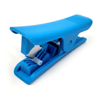

  • Ensure that the PTFE tubes’ ends are correctly cut (completely perpendicular) and positioned.
    • I believe that the last action I took that finally made the issue disappear was to disconnect and reconnect all the PTFE tubes from the hub, and also cut a few millimeters from the end of the tubes, ensuring that the tubes are fully perpendicular and no sign of wear and tear on the tubes’ ends: A1 series Printer PTFE Tube Removal | Bambu Lab Wiki

I started having the issue again after a few months.
I removed all the PTFE tubes from both the Hub and the AMS, and noticed that the ends looked torn.
I cut the ends with a PTFE cutter to ensure they are perpendicular and then reconnected them.
I can confirm this solved the problem for me.
