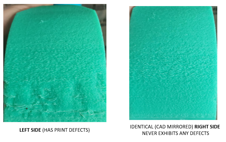

2) Printing defects. I can not explain why certain objects exhibit the same print defects in the same spot every time. In the following pictures you can see the left and the right side of a symmetrical TPU object. I have printed this object twice. Both of the times the right side printed nicely and both of the times the identical (CAD mirrored) left side of the same object has these defects. (This slice uses fuzzy skin by the way) Do you have any idea?

A couple of things here:
You mention numerous brands of TPU that you are using. Are you intending to switch brands during one print job?
What’s the reason for using so many different brands? All probably need some calibration before printing.
Have you looked at the TPU feeder from Bambu?
Definitely for TPU 95A but even softer runs perfectly without the complex setup that you have.
It would probably make swapping spools on runout a lot easier.
If some TPU manufacturers have the filament hooked to their spools, stop using that brand or respool the filament to prevent this issue.
