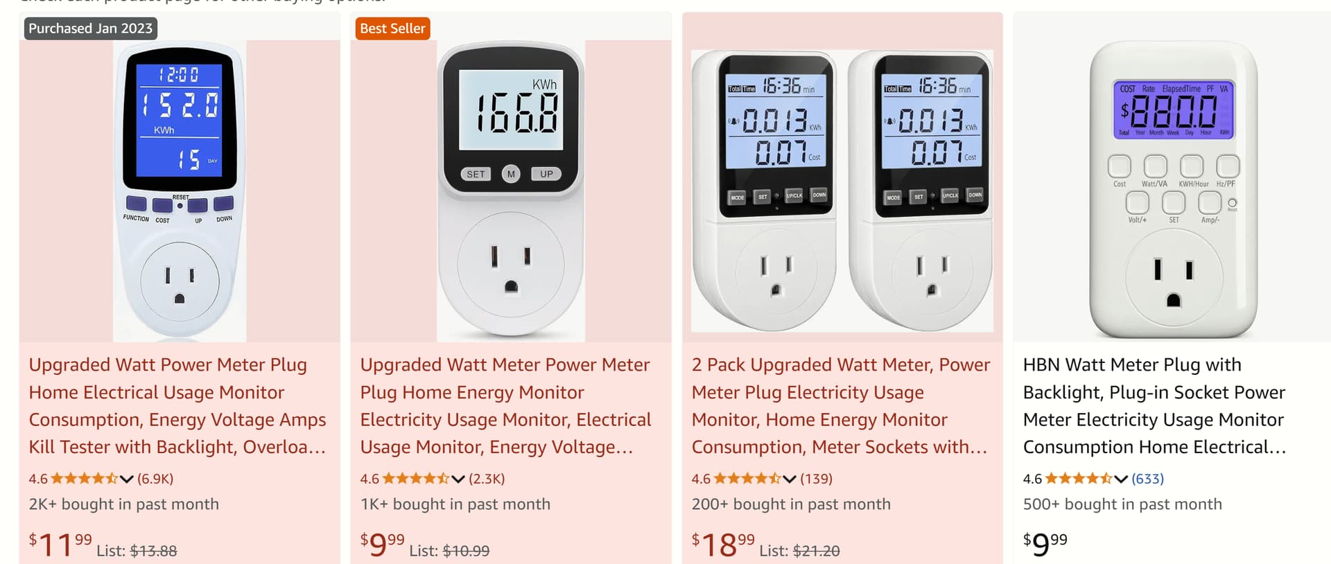

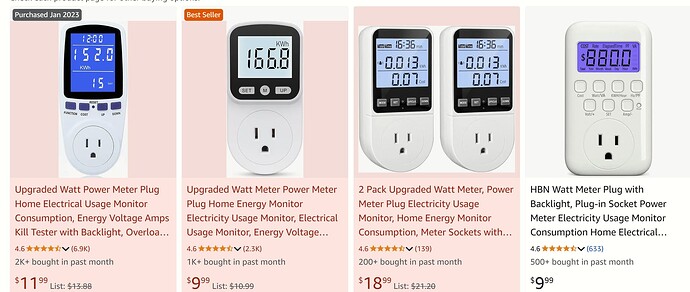

Get a kill-a-watt (or similar). They are an incredibly useful measurement tool to have, and are cheap. Clear it, do a couple-hour print, take a measurement, multiply by the number on your power company’s bill, bobs your uncle

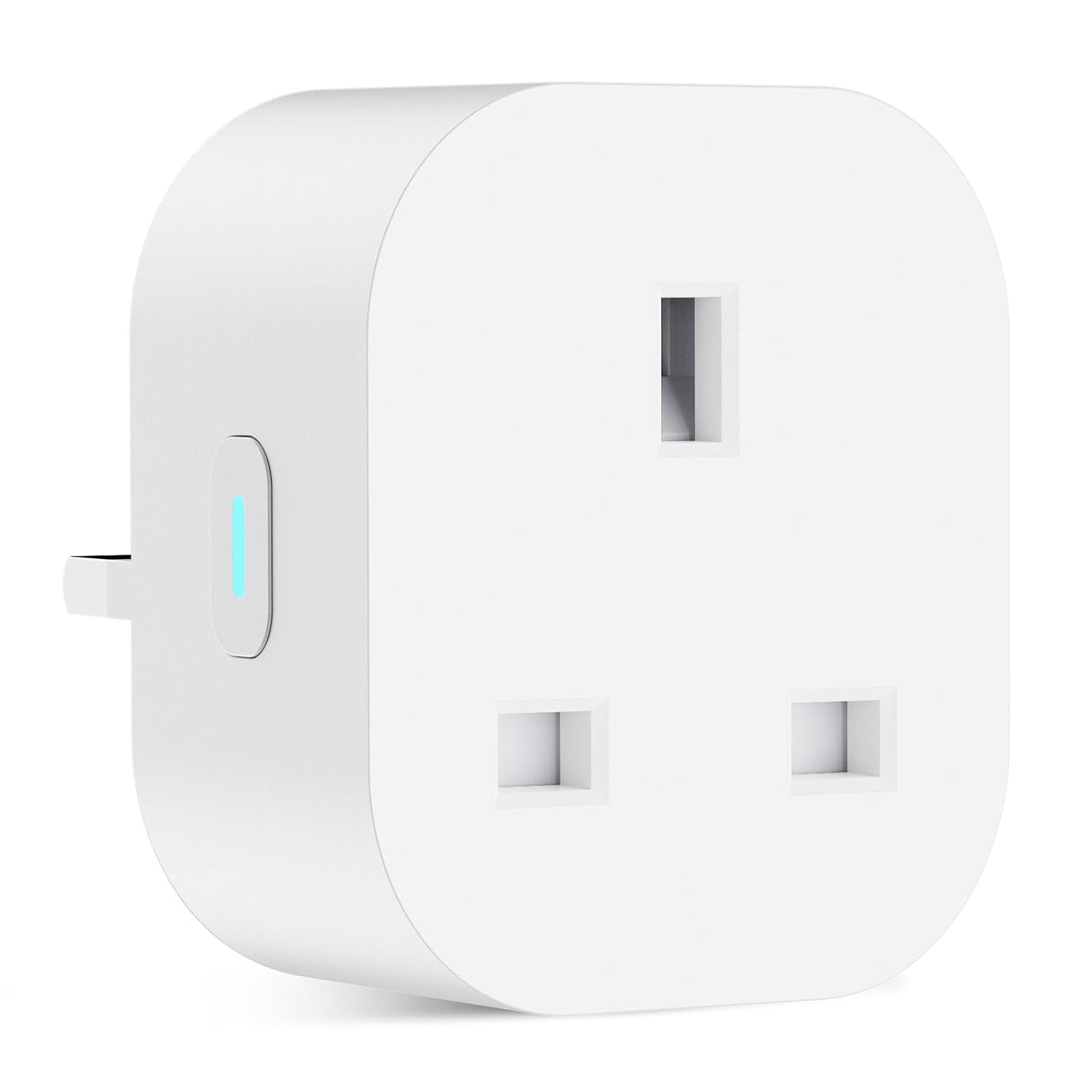

I have smart plugs on each printer, which let me switch them on and off by voice. They also provide energy monitoring data from the installation.
From below, I am on 220V U.K.

I’m surprised nobody mentioned this but one indispensable tool for every household and/or shop is a Kill-o-Watt power meter or the 100s of variations. I have three of them kicking around the house and you can even enter in what you pay per KWH to find out the expense of electricity at the outlet level. While these are not scientific great they are what our Chinese friends would call “Chabuduo” (差不多).
Here’s the US listing but just do a search on any site or home improvement store. They are available in every country that has electricity. :grin:
https://www.amazon.com/s?k=power+meter
These used to be pricey when I got my first one back in 2007(like $69). Now they are dirt cheap. If you pay more than $15/unit, you got ripped off. There’s no reason to not have more than one if for nothing else, to monitor electricity hogs in your office or home.
Of all the models I have, I prefer this one because it has a backlight that can be turned to continuous on.
https://www.amazon.com/dp/B09BQNYMMM

I have smart plugs on every single socket, not just for printers, ones compatible with the Smart Life app. The app adds the extra ability of seeing total usage and grouped usage.
You can read the data in any way you want on the app.
You can also schedule them to turn on or off after a timer or event.
You can also trigger them based on other external factors.
