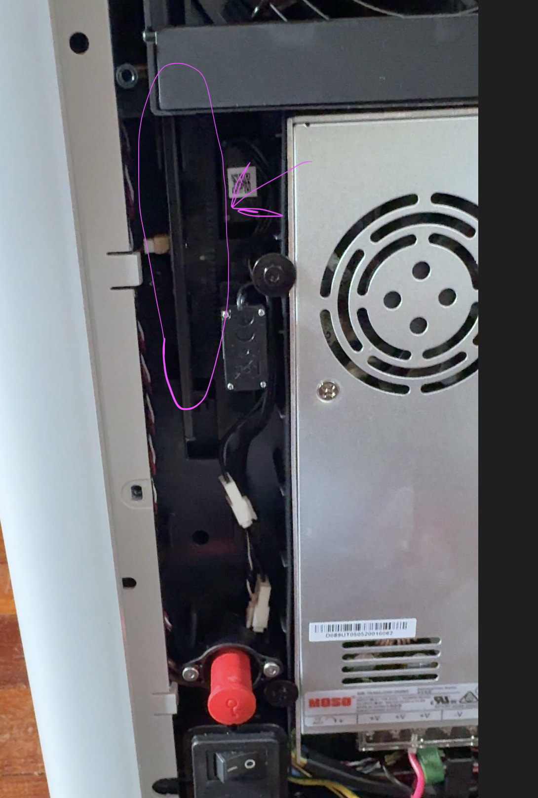

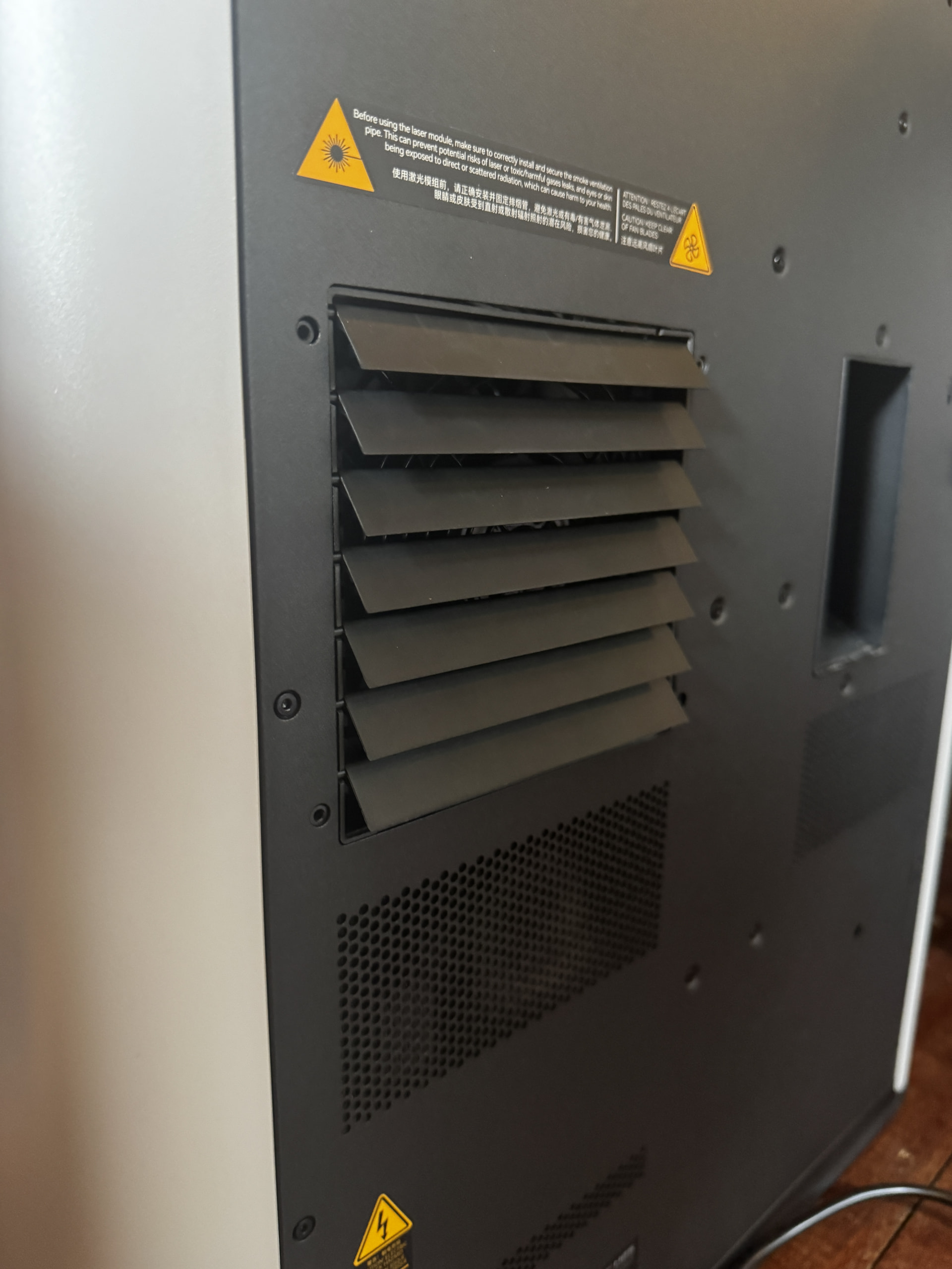

As a follow on from my stuck vents post. My H2S (10 months old) has developed a fault where the rear exhaust vent wont close. The fix is at the link below and support is telling me they are sending out the parts.
I am not comfortable doing this level of “surgery” on my H2S, the instructions seem very complex. That said I would welcome your counsel as to how concerned I should be. thanks for any help.

thanks. will have a look for a makerspace. I have also asked support for other options. This just feels like a lot can go wrong when you are taking out power sources. Seems crazy when the issue is down to a small.
That is crazy that they generally expect an end user to do this., and I have done a lot of repairs of things I shouldn’t have in the past. This is 10 months old and out of warranty? Since they are so twitchy about the servo (which I understand) I would mark one tooth of the gear and put a matching mark on the block or body just incase it got bumped and rotated.
I am very concerned about doing this. the issue is on the back. the long piece with teeth will move up and down freely when pushed by hand and the vents open and close. But when power is used rather than a hand the long piece with teeth won’t go all the way. there may be a lose screw I can’t see so that when the servo activate the long piece is being pushed out of alignment because it is loose.
The response from support was to send me the spare parts to replace everything!
It almost sounds like it has jumped a tooth? So that the servo is moveing full range but the rack is lower than it is supposed to be so that when the servo stops the rack is not all the way up. But that is all a guess on my part.

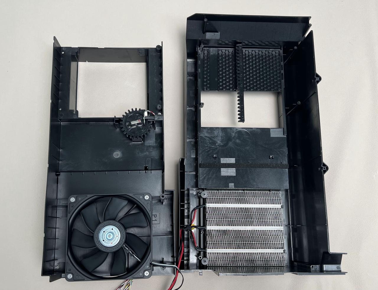

Thanks for the comments. Update. Bambu have responded quickly and the parts arrived within 2 days. I told them about my concern about self repair of something that looked complex and they said that an alternative would be provided but did ask that I look at the parts they sent first and assess the repair prospects then.
I opened the parts and took the back off the printer and was able to compare my installed parts with the new ones. This allowed me to see a hidden flap, inside the mechanism which I manually opened and closed 3 times and then powered up the printer. The vents opened and closed correctly. I will be doing a full test tomorrow but hopefully this has fixed it.

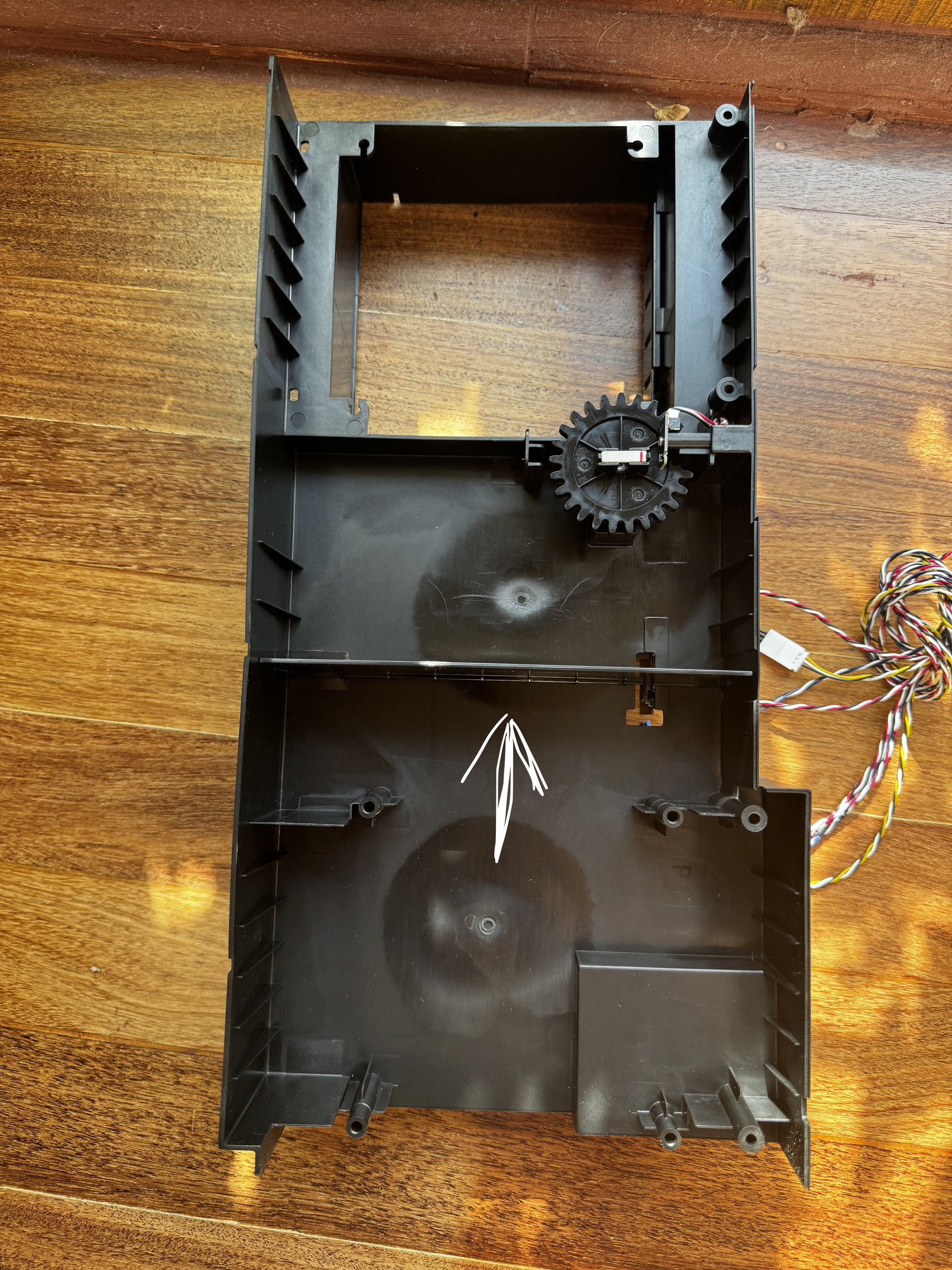

Hi. Here you go. this photo is not on the wiki. It is a “Hidden” until you disassemble the chamber, flap. See photo with arrow. In summary, despite the mechanism to open the rear flaps working when manually operated by hand, under power the servo “jammed”.
When the spare part was mailed out to me it allowed me to see this hidden flap and I then reached inside my unit to manually open and close that a few times. When this was done I did a further test and the rear flaps opened and closed with no issue.

Thanks. Very helpfull. The part in the wiki shows the holders for the pins on the flap and the outline for what I am guessing is a knock out for what I guess is a spring. Your part has the flap, the “new” part they show does not. I don’t know if this is an “evolution” in design like the A1 board or if the part they show in the wiki is just not really all there. Or maybe from a different “H” model. (Edit; this is at top of wiki Note: This page uses the H2D machine as an example. The replacement steps are exactly the same for the H2S, and H2C.)
Did the new part you received have the flap? From your description of events it sounds like it did.
Edit: attaching pic from Wiki. They area in question is shown multiple times and I never see the flap the OP shows. It’s possible the wiki does mention it somewhere and I just missed it.
Hi. sorry for the delay in response. Yes the new part had the flap. I have since printed another 10 hours with the old part fitted and it has not malfunctioned again. Could have been debris?
