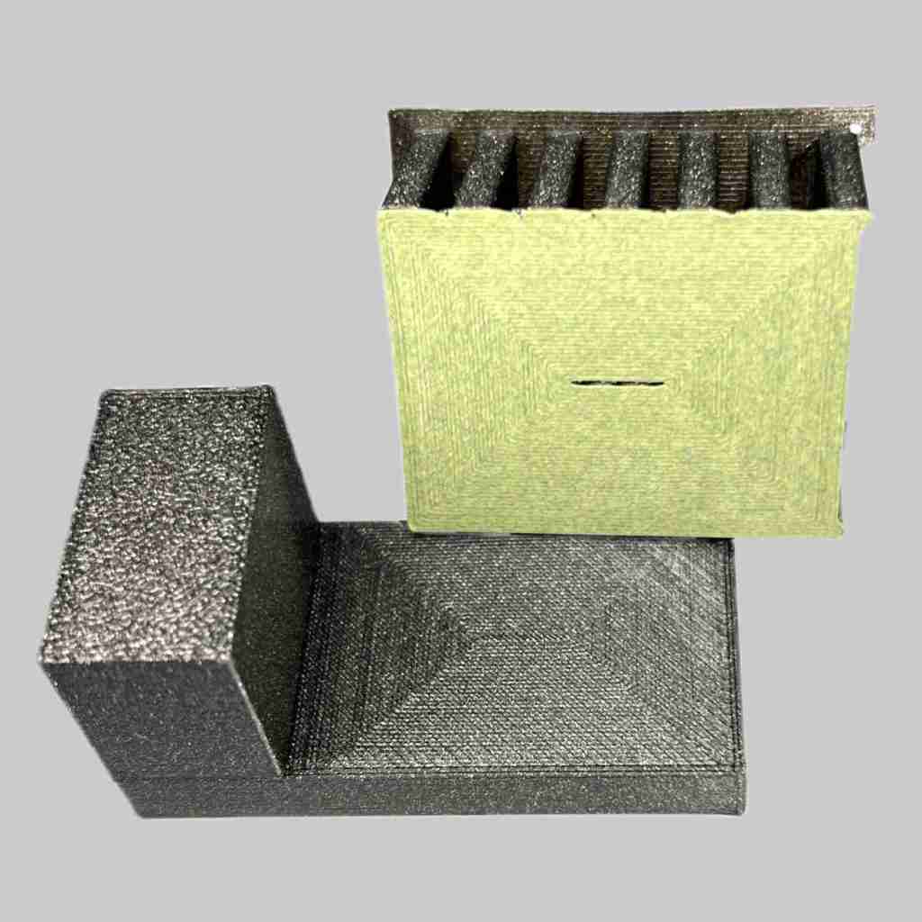

Doing some testing with petg and HF 0.4 E3D will update when i know more details. some first prints I did with overhangs and bridging is it can blow away the bridge :slight_smile: and overhangs work all the way up to 80% but need to try some real prints and not just tests and mess with all the setting. I’ve turned off slow down for over hangs and slow down for better layer cooling. Anything else you can think of i need to do?
Those are the two main settings so you should be good to go. On the non-Bambu printers I usually only ran the Cpap around 30% normally and like 50% for overhangs. I tried 100% but it sounds similar to a vacumme cleaner and actually blew a print off the bed lol.
lol
Fab thx, I’ve just worked out the same with the 30% being way way quieter than 50% by a massive amt. so looking I will match you on that one.
Been playing with bridging over the top of infill fast speeds (250+)and max fan, that’s a massive amt of time saved, always annoyed me the time saved printing infill followed by losing all that time gained by slowing down to bridge over the top.
