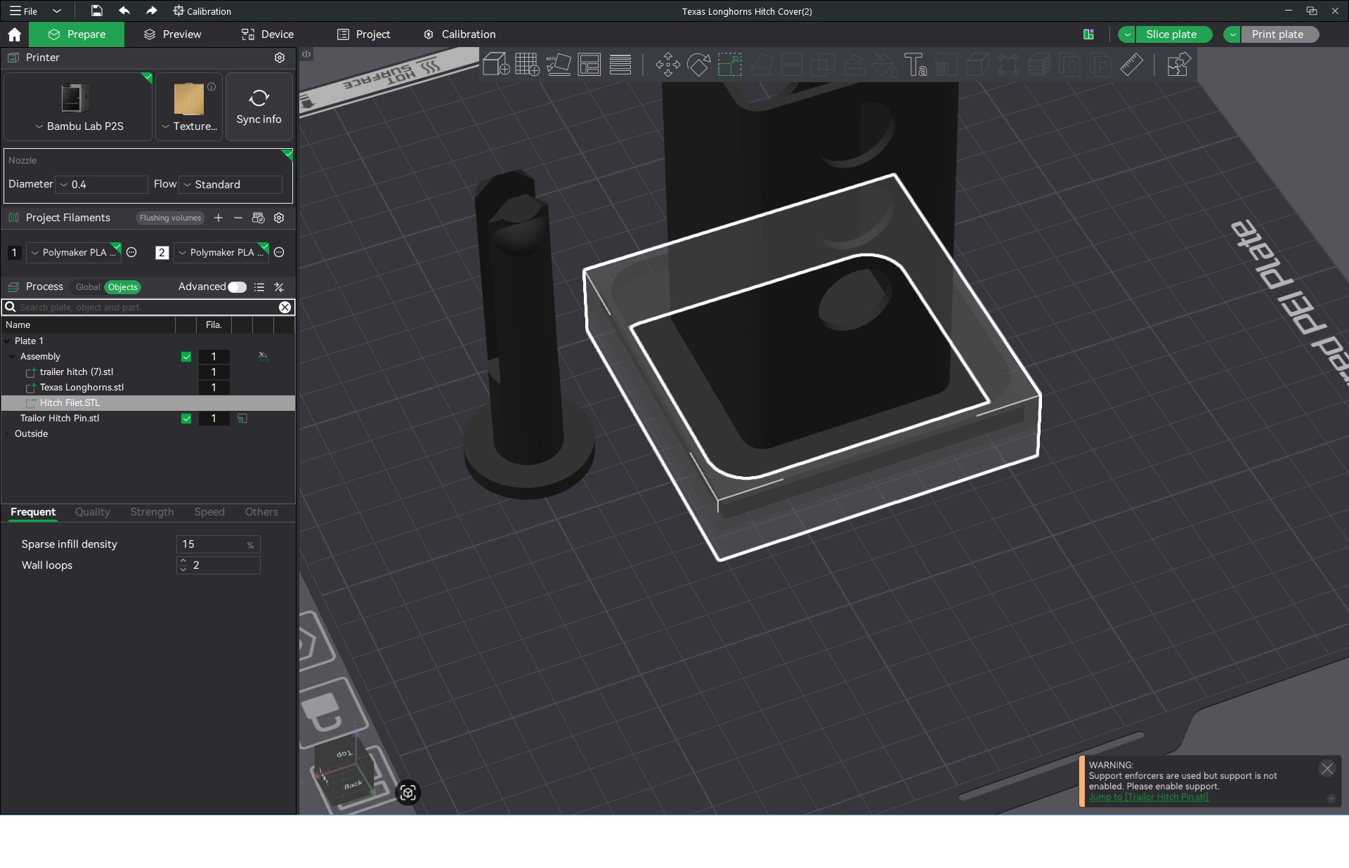

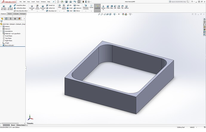

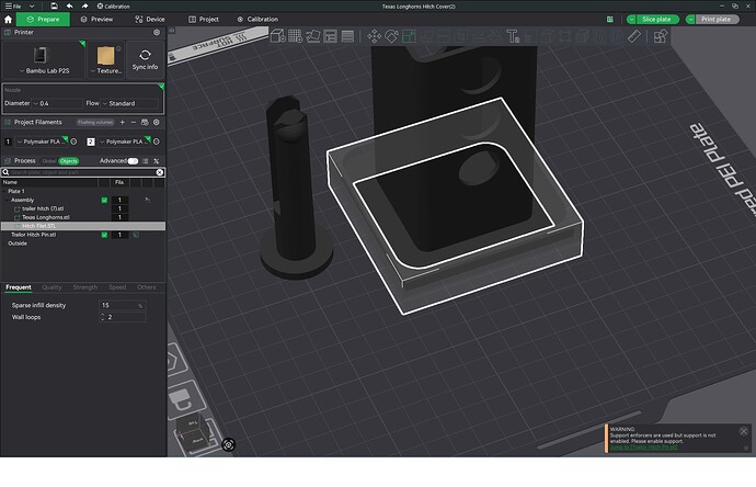

I combined the 2 methods. I wanted to round the edges of this hitch cover and I did not want to lose the art on it.
So I made a negative “frame” with rounded corners and dropped it in as a negative part that I centered.
This was a simple fix because the part is pretty basic but had to be faster than recreating the art on there. Thanks for the idea!
