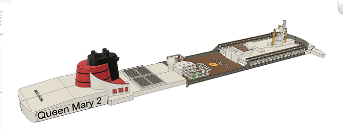

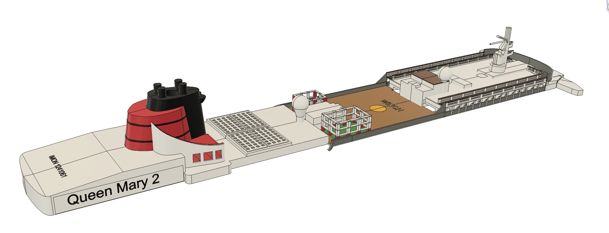

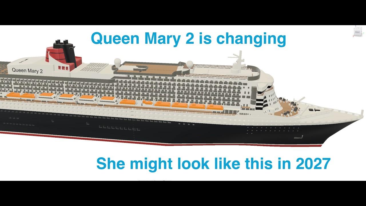

Created 3 versions of my QM2 model - Original layout, 2016 refit and a guess at what the 2027 refit might look like.

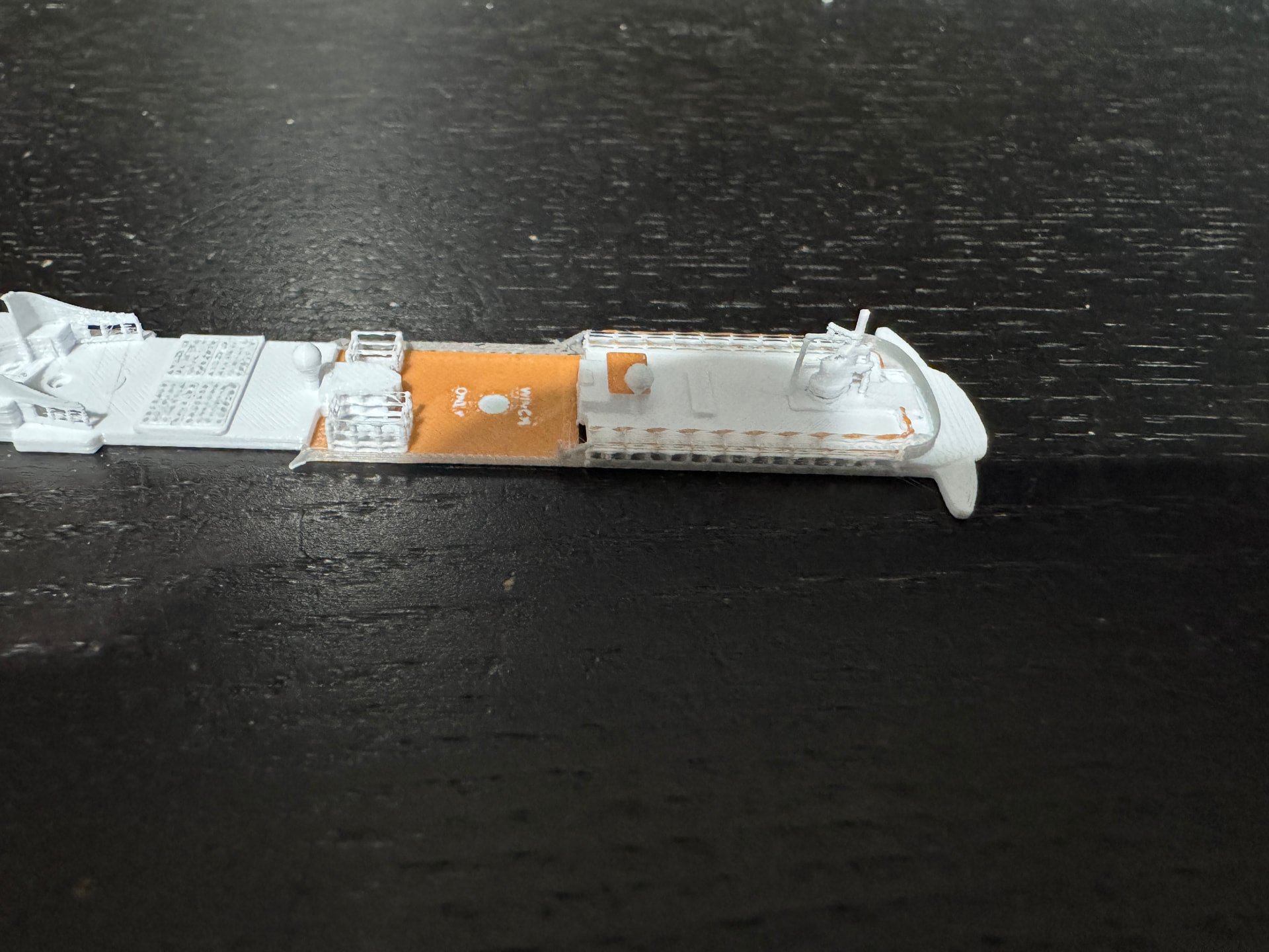

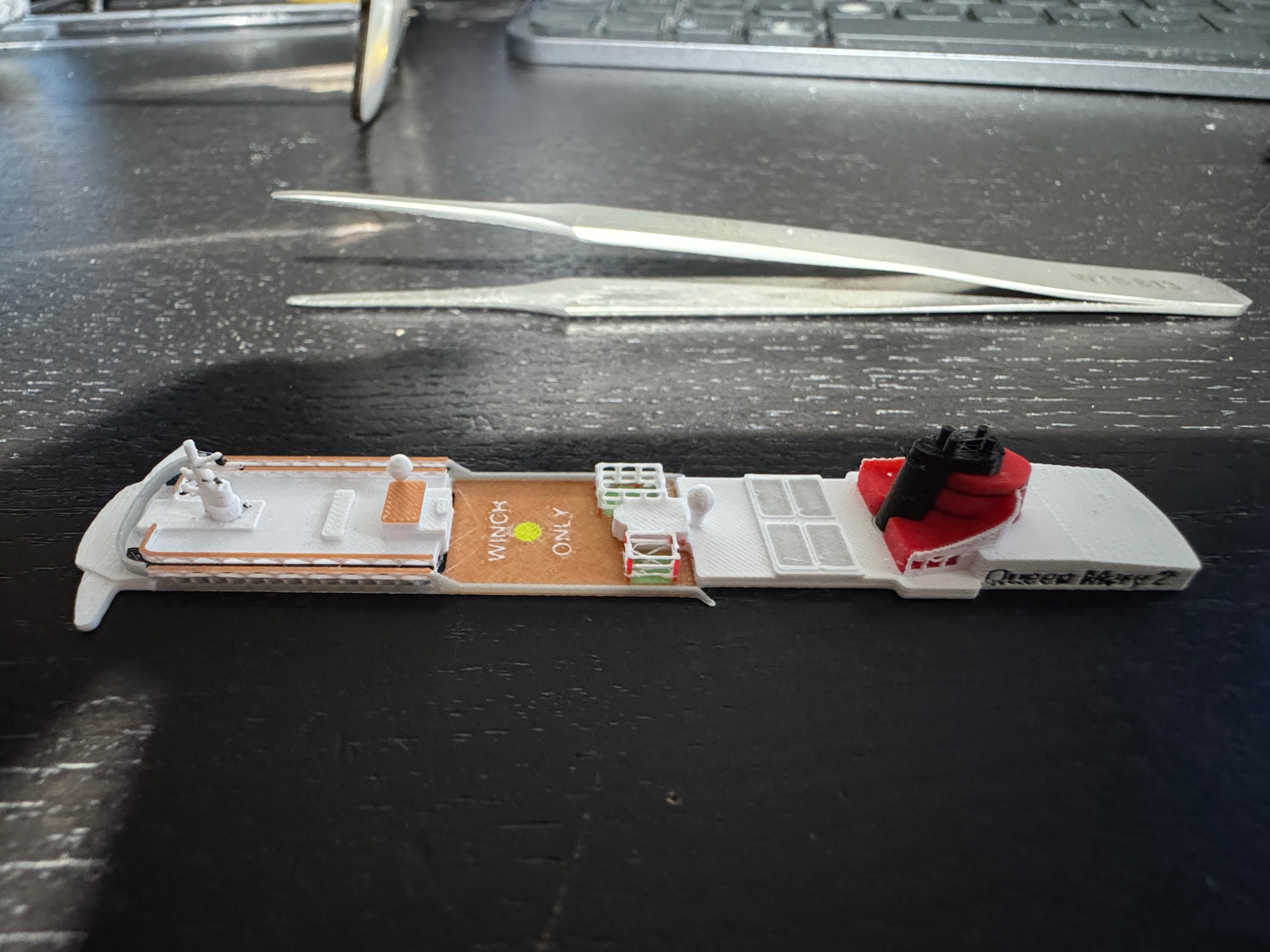

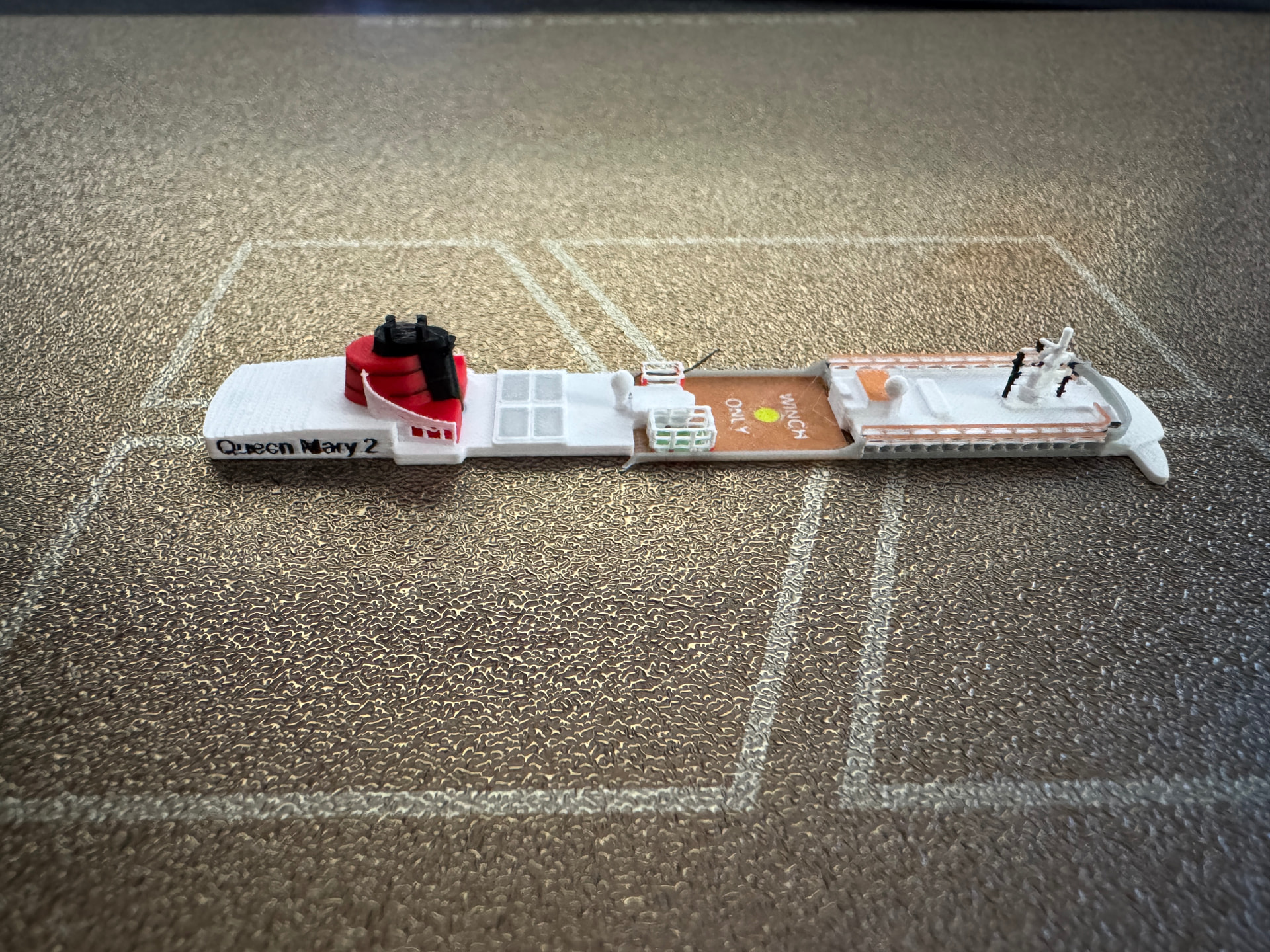

Test print of deck 13 at 1:2000 scale in a few colours with 0.2mm nozzles - needs a bit of work.
Just a suggestion for you or anyone else printing ships, I know the owner of a large motor yacht (45 meters) who paid double digit thousands of SGD to have a 3d model of her yacht made in 1:56 scale. Go down the marina with a model and see what happens!

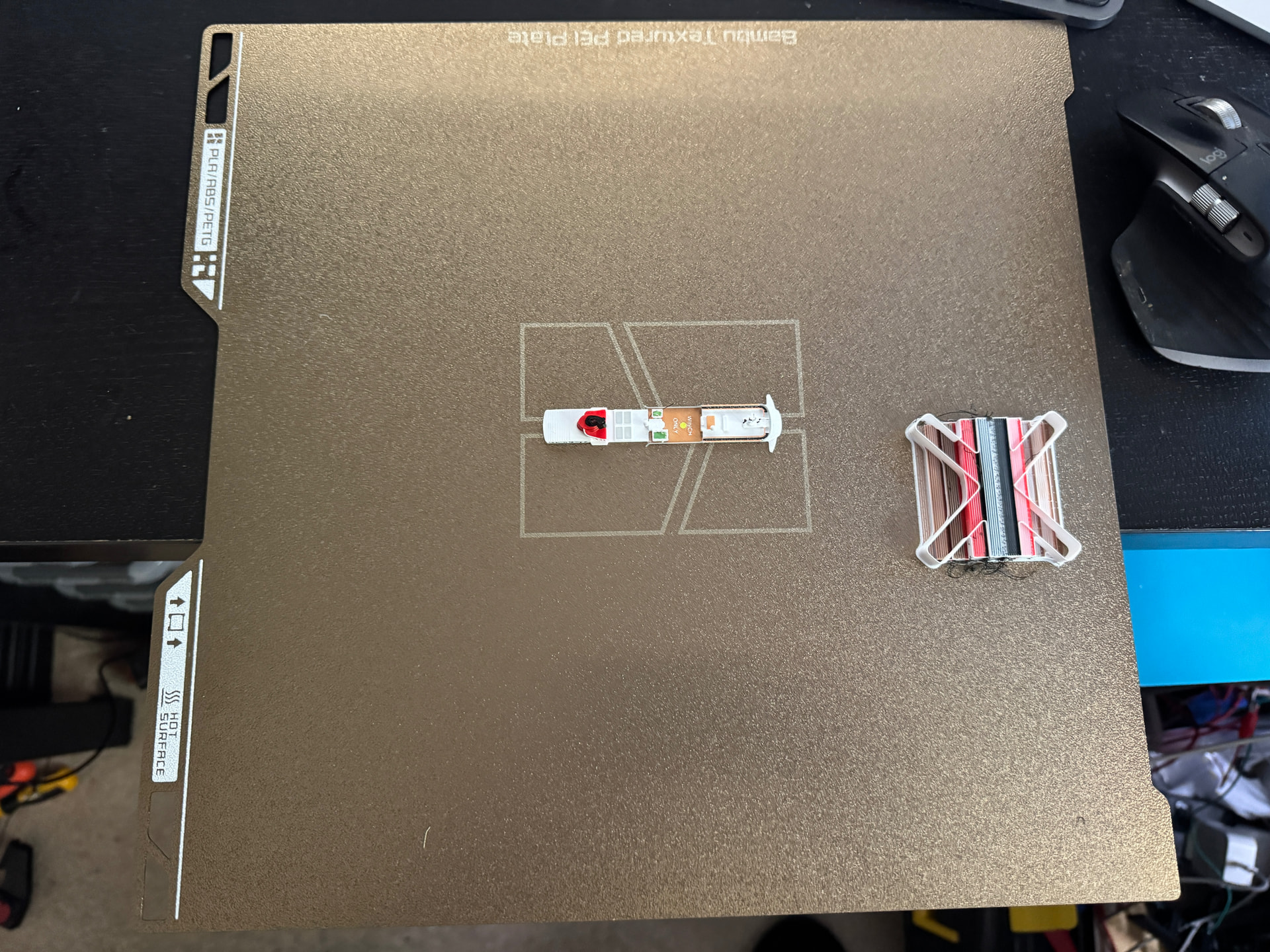

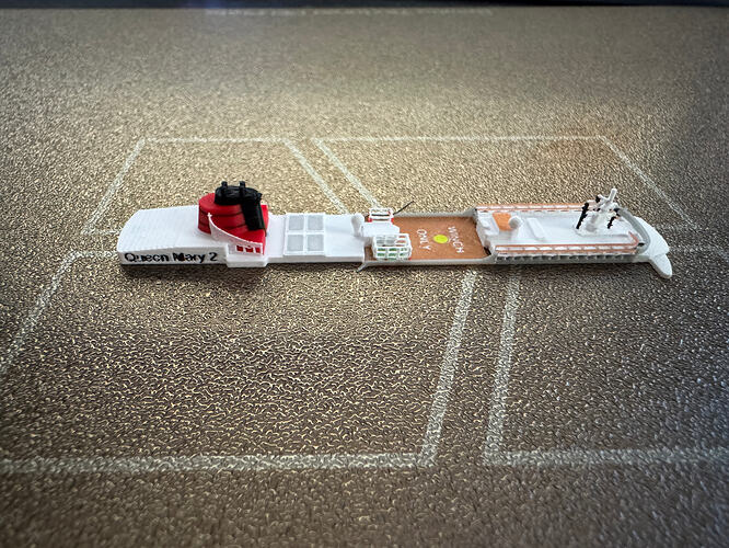

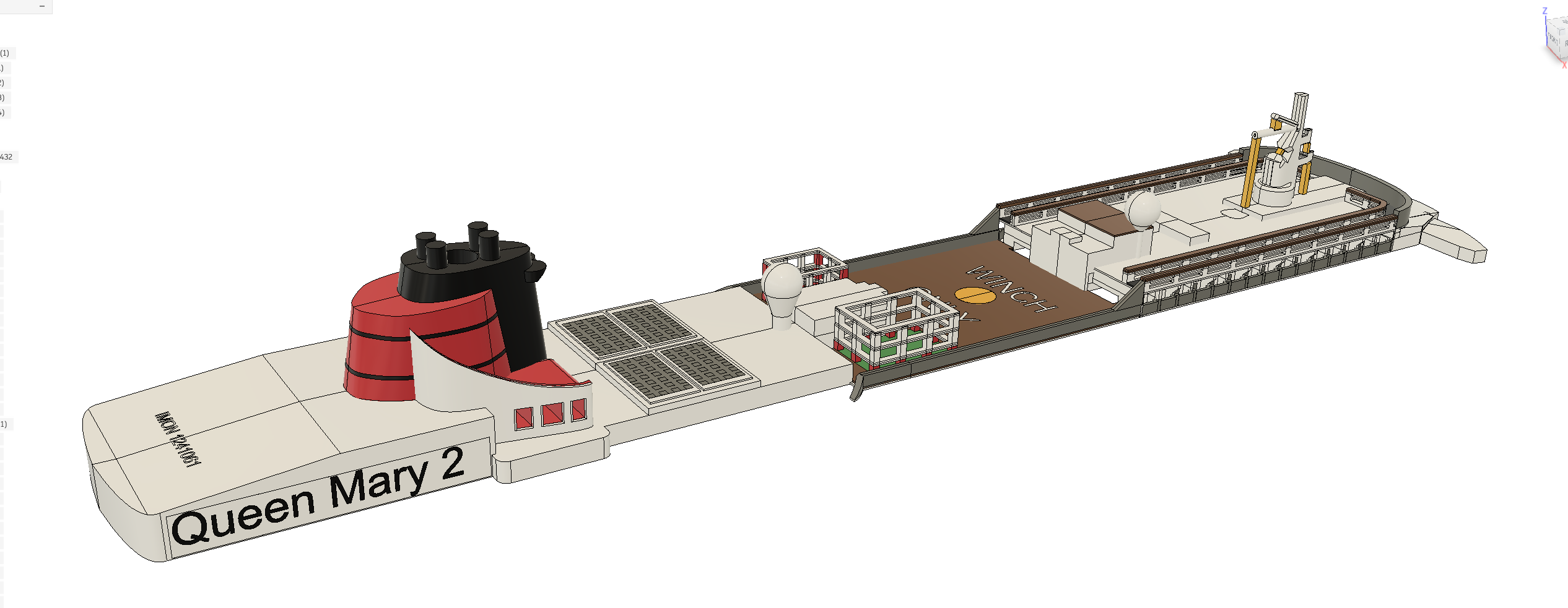

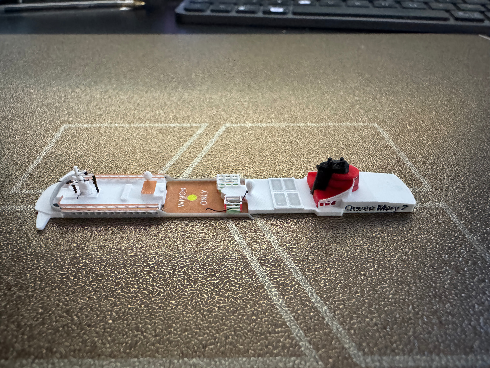

Kicked off a full colour 0.2mm test print of deck 13 of QM2 (4.5hrs) - see attached screenshots for the lower detail (for 1:2000 and 1:1000) and higher detail (for 1:500) version.
A little but suspect at 0.2mm - might try it double the size at 0.4mm to see whether it prints better at that scale. Looks ok by eye.
Should probably use white instead of black for the mast support - as tricky to remove some parts.

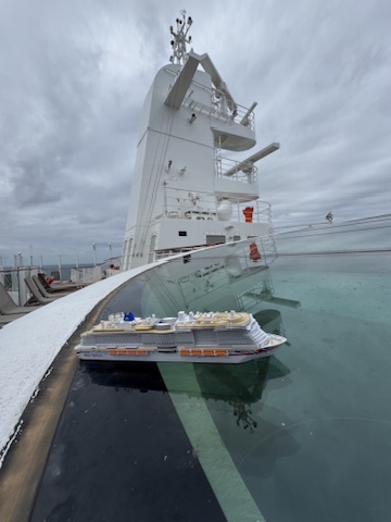

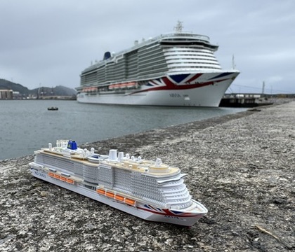

Couldn’t get a perfect side by side shot - due to port layouts and weather - but quite happy with convenience of tiny 0.2mm nozzle 3d printed models. Next time I might try getting a ferry for a better unobstructed comparison view. P&O Cruises Arvia 1:1 vs 1:2000

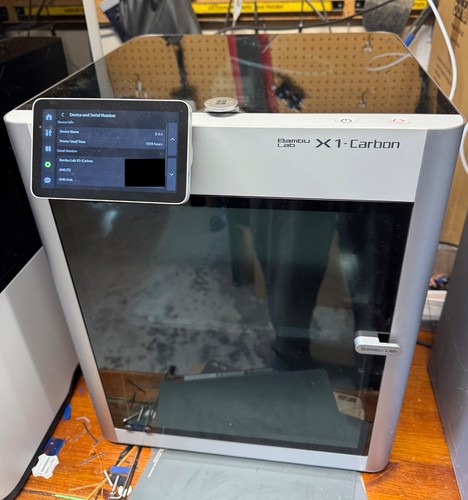

Decided to try selling one of my X1Cs - as getting too many printers.
Selling the newest one as it only has 1098 hours on it (the other one has over 2000, plus I had to change the fan on that one)
Haven’t used ebay for a few years - and not sure what X1Cs are really worth these days.
Initially trying to sell it without the AMS - as I would like to keep as many AMSs as possible.
Listing here in case anyone has any interest or feedback.

No listing shown from the link , last time i looked x1c were going from £600-£800 in the uk
Listing got flagged - because I included a link to this thread and YouTube - so need to work out how to revise it. I’ve put it up for £450 (without AMS) - maybe I should push it up a bit.
Update - sorted out issue - plus pushed the price up to £500 - interesting to see what happens.
I just followed a search and found two in need of repair for that price (£450) , i would of suggested a search then determine which are listings to sell others, £1200 with ams for example would be a listing i would consider a listing to sell others , good luck with the sale
Interesting thanks - I looked at sold listings - and got the impression combo’s were going for about £600 - so thought £400 for one without the AMS - but maybe I will push the price up a little bit more as you suggest to see what happens - thanks.

My process is
  1. Get dimensions - length, width and height. - and add them as parameters in fusion.
  2. Get a good side photo - from a distance zoomed in ideally - as straight as possible - to use for positioning of the decks and creating the side profile.
  3. Import it into fusion as a canvas - scale to 1:1000
  4. Draw the basic outline, and a horizontal line for each deck position
  5. Work out the deck heights from this - round them up or down - and try and make as many as possible the same height - and as them as parameters in fusion - and apply them back to the deck heights sketch.
  6. Create a component for each deck and a construction plane for each deck.
  7. Separate out the deck plans into one image per deck
  8. Load the decks in as canvases onto the deck construction planes.
  9. Line the decks up - with features like stairs - and adjust the dimensions - which sometimes involves stretching the photos externally - so that the features like lift shafts plus external widths match up - sometimes decks plans are not exactly to scale in both dimensions
  10. Then do an outline sketch for each deck
  11. Then create the hull using the lower deck profiles and lofts.
  12. Model all of the decks - only usually need to model one half
  13. Mirror each of the halves.
  14. Then start comparing the details with photos and videos - Blender is fairly good at this particularly for drone shots - because you can make an overlay of the drone shot plus real model to line them up exactly.
