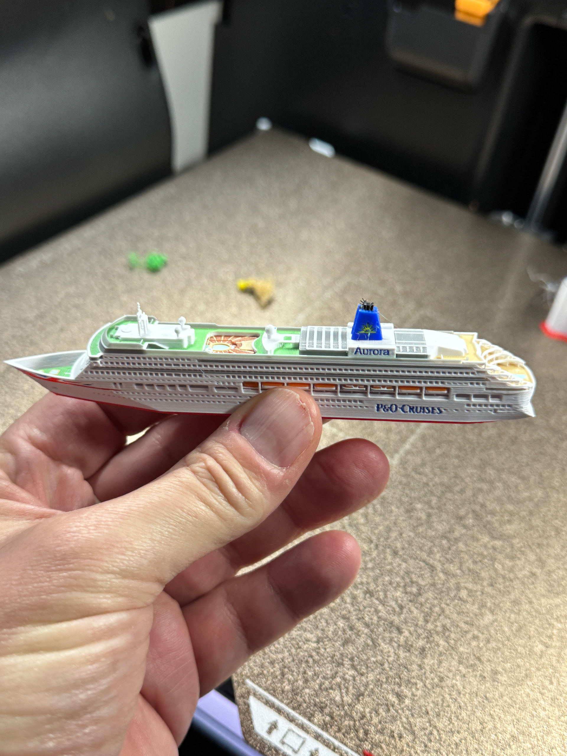

That looks like an interesting ship to model - will have to do one of those one day. That’s the great thing about ship modelling - there are so many 100s of different ships to do.

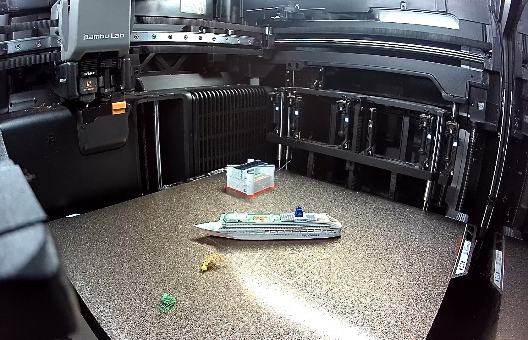

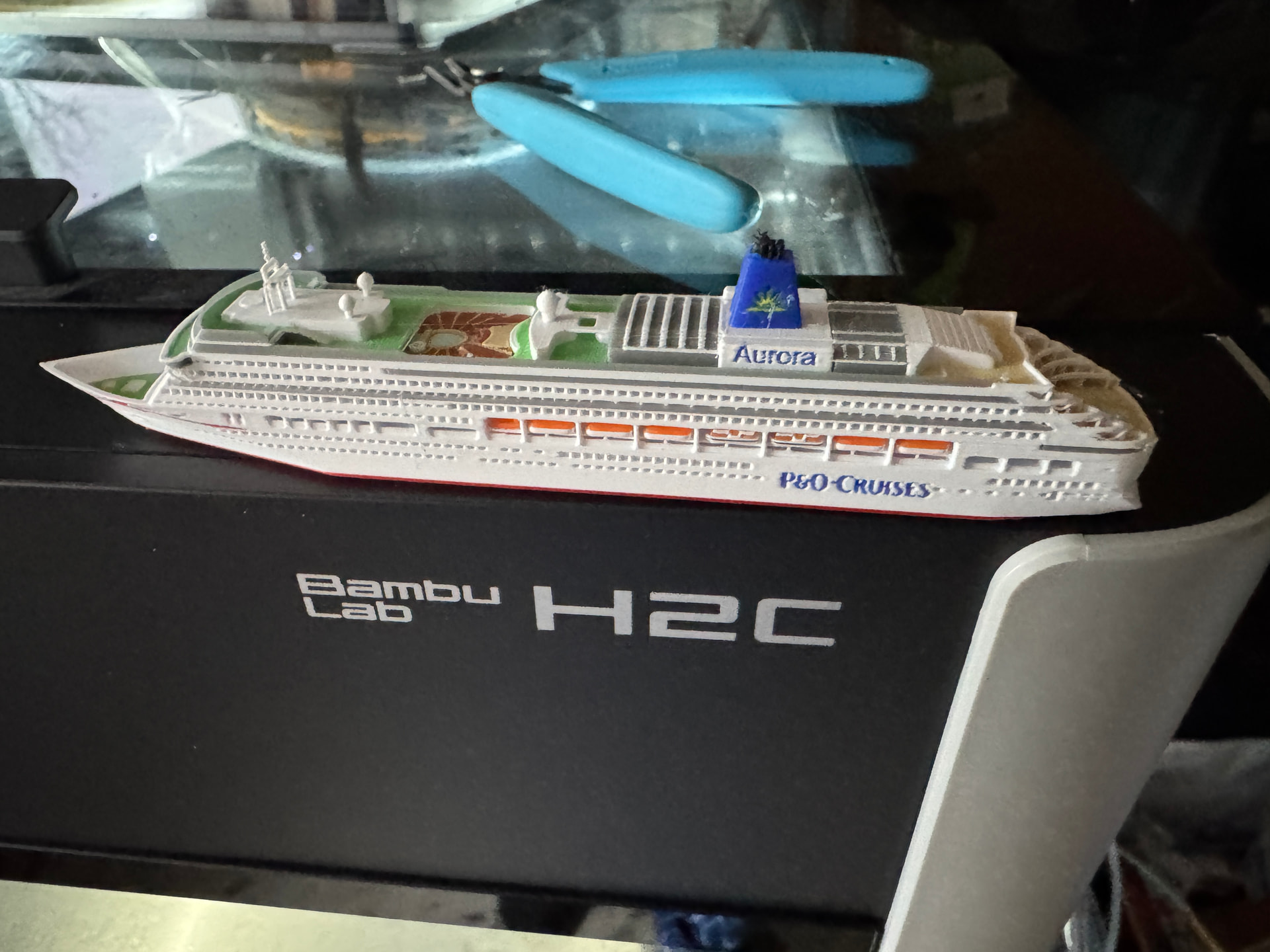

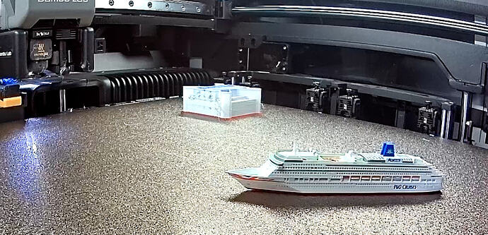

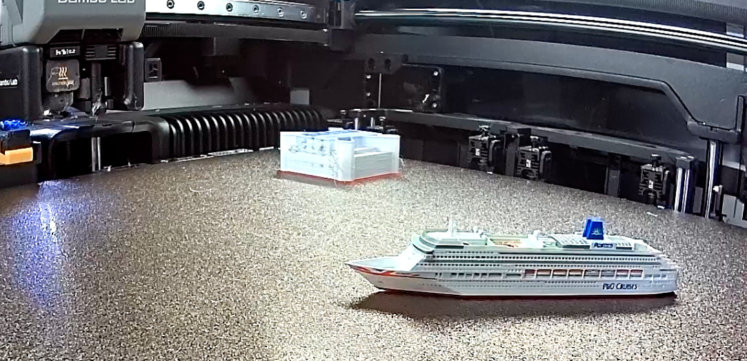

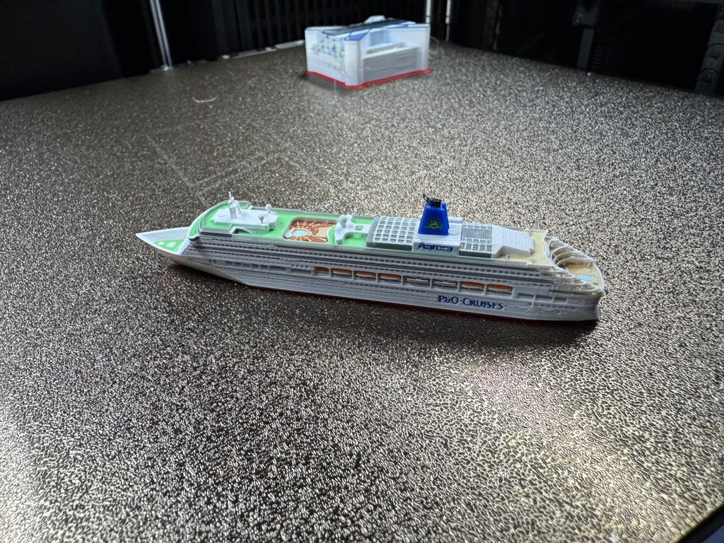

Nice surprise to wake up to this morning.

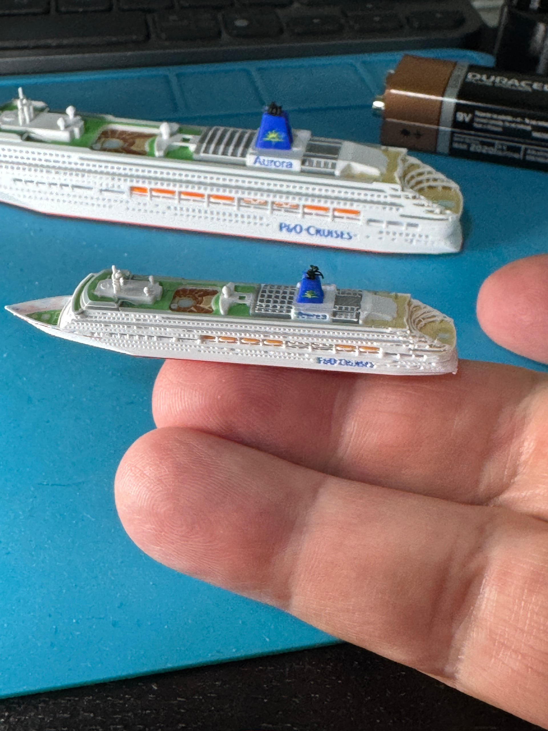

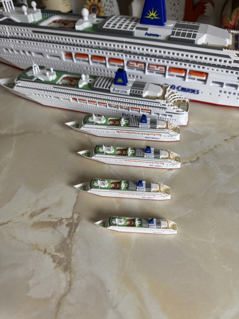

Printed perfectly in about 9 hours without a single intervention.
its tiny when compared to the 1:1000 and 1:500 scale versions.

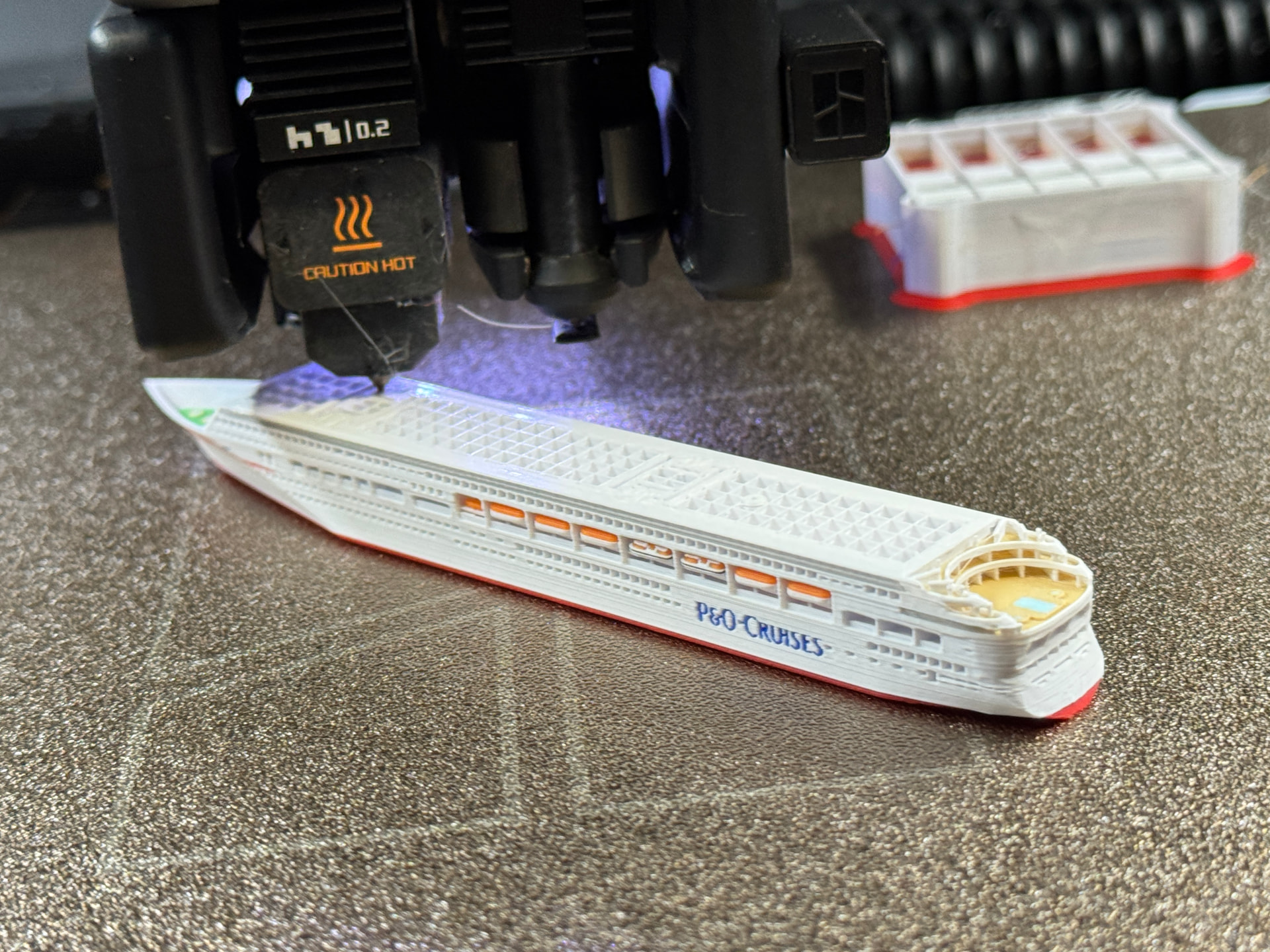

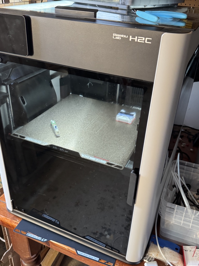

Quite pleased with the H2C and 0.2mm nozzles - might print the rest of the fleet at this scale too.

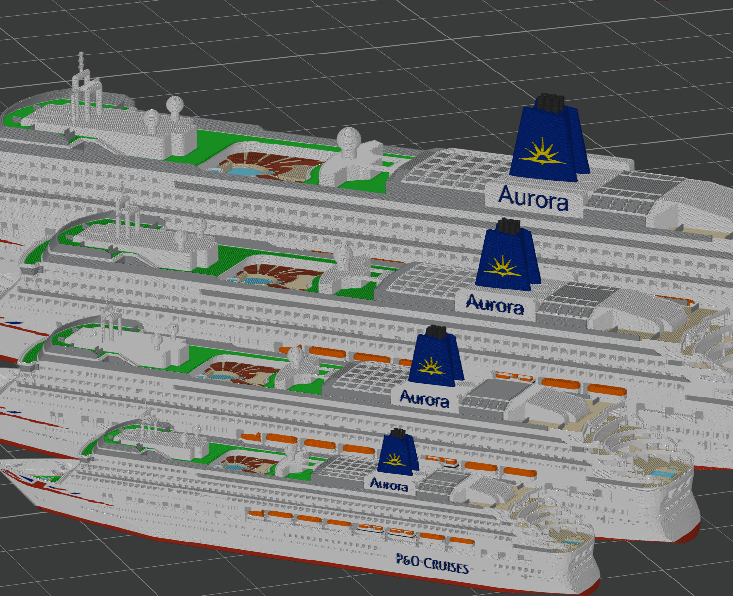

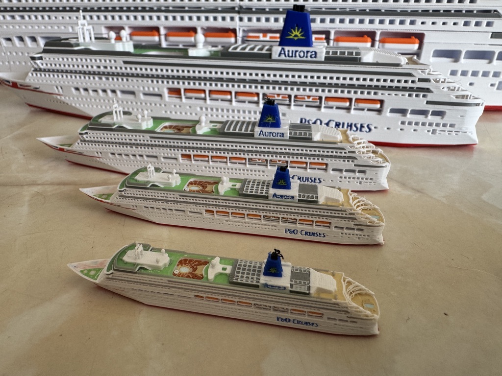

Going for 1:4000 next - looks like it might work - the text still looks legible.
Print kicked off.

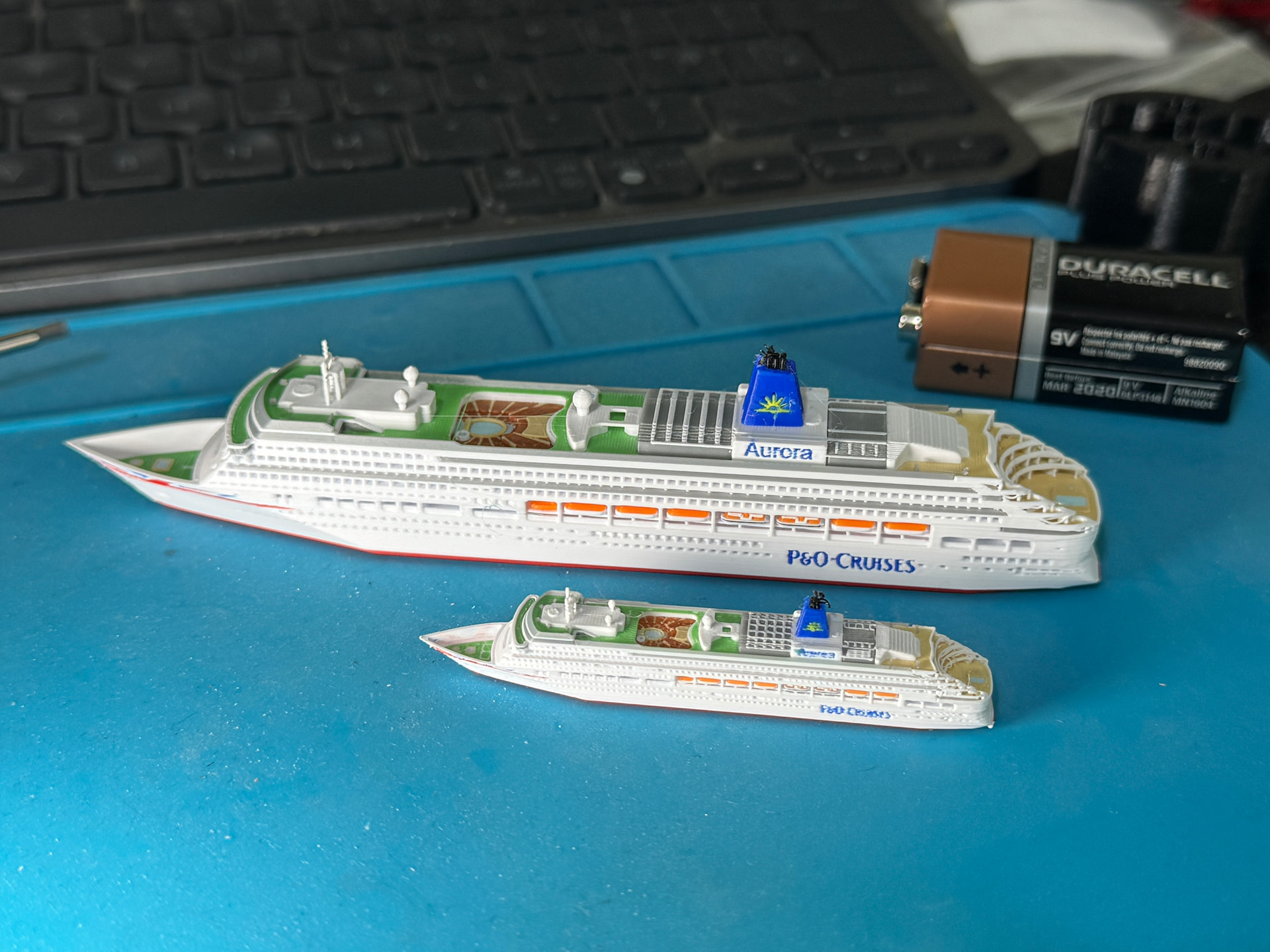

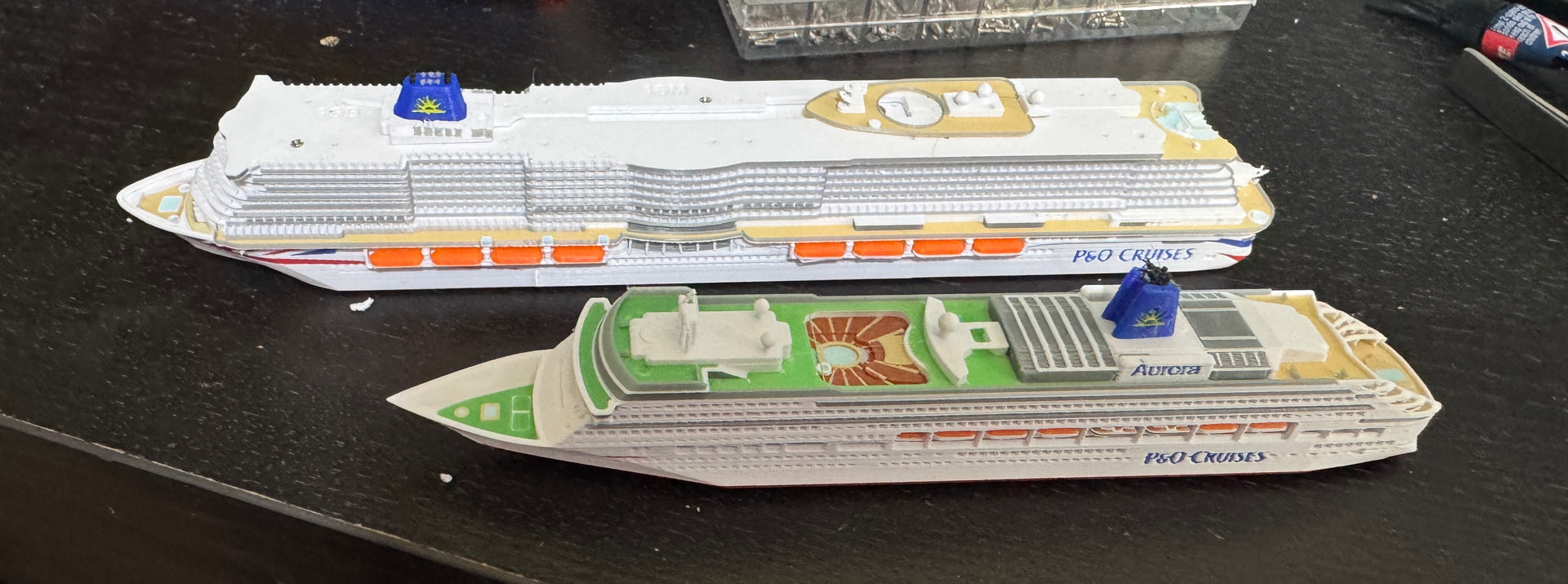

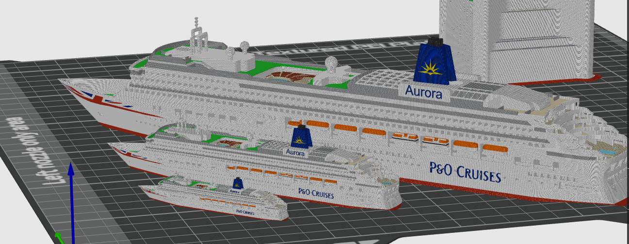

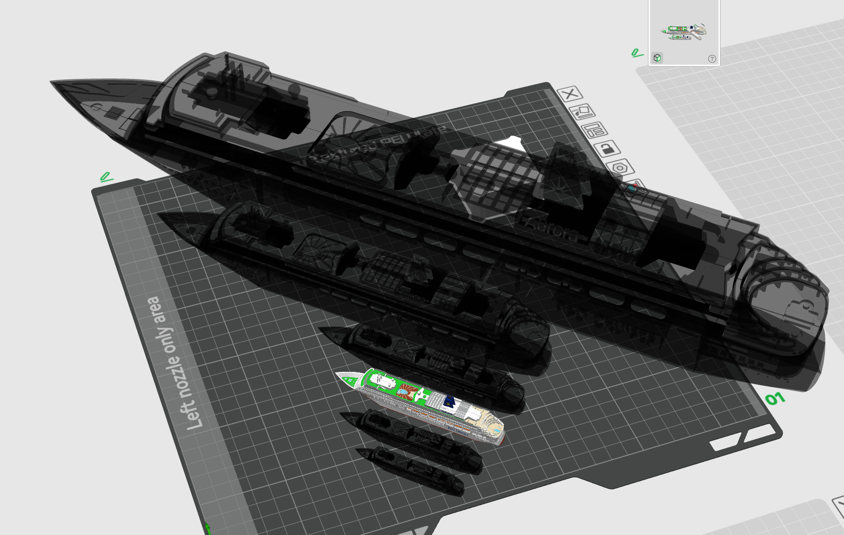

1:4000, 1:2000 (the one I just printed) and 1:1000 comparison in preview
1:4000 not bad (without close up or magnifying glasses) - but probably a push too far.
Will try 1:3000 next
1:3000 also can out quite well - but text a little bit corrupted - so 1:2000 probably best size
1:3000 is the 2nd one from the bottom.
  • but I have kicked off a 1:2500 scale print as final test.

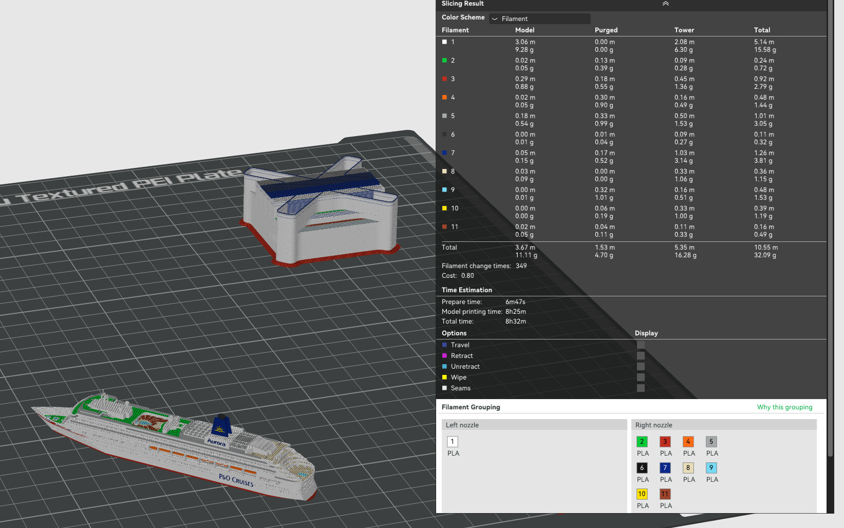

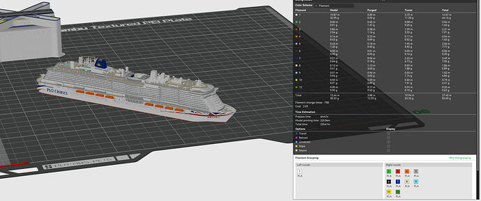

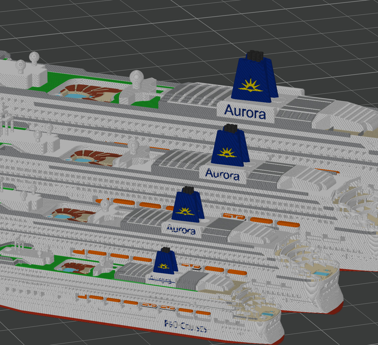

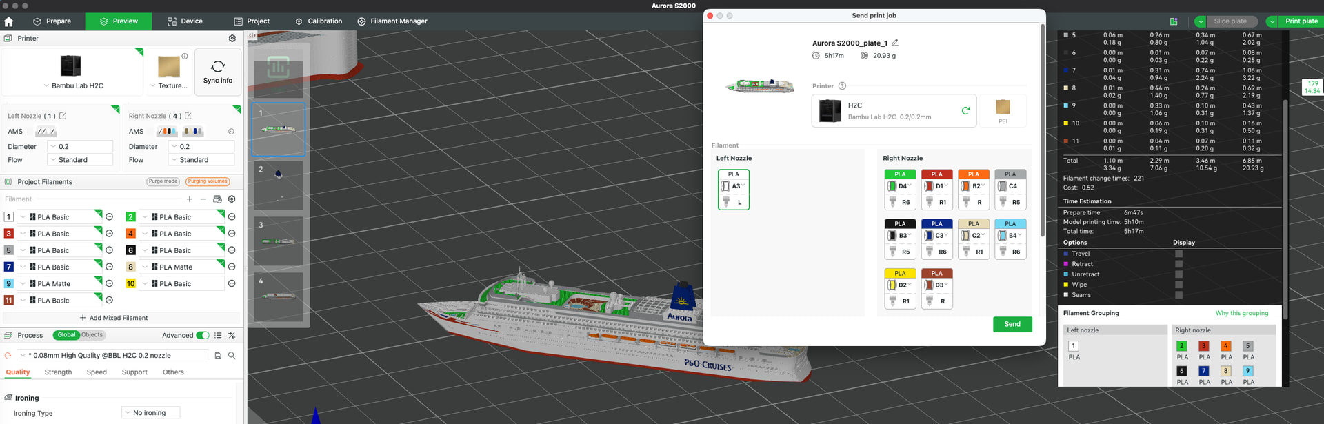

Comparing slicer settings
.08 layer height Arachne
0.1 Classic
Conclusion - should probably use 0.08/Arachne for the 1:2000 version too - due to text, plus loss of detail on the top of the sliding roof that you get with 0.1/Classic - so yet another reprint I think after the 1:2500 one finishes.

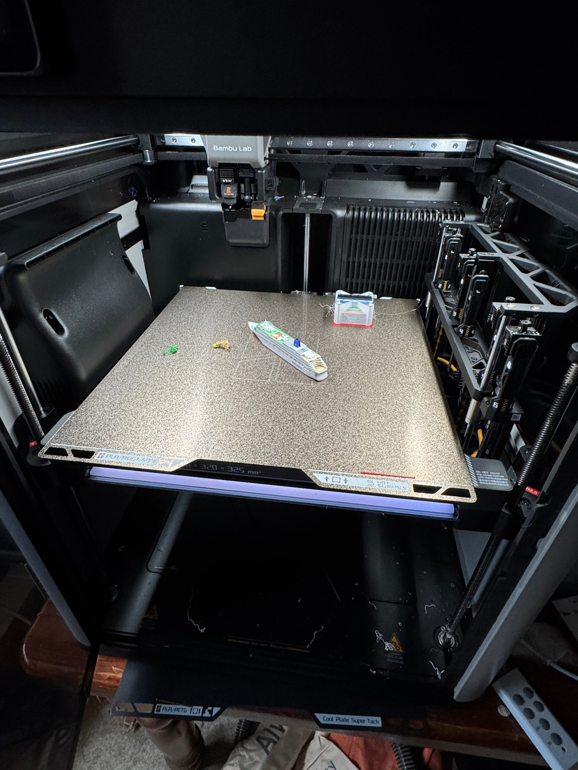

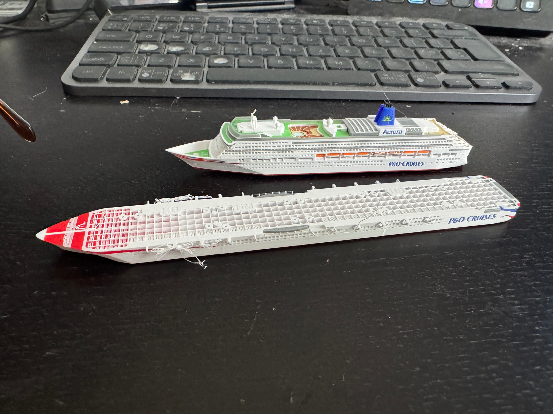

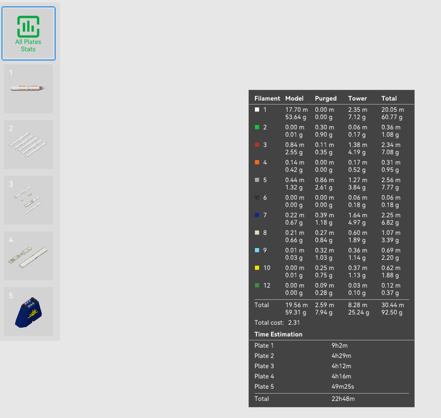

Mini Arvia (1:2000 / 0.2mm / 0.08 layer / Arachne) now underway - it’s about 22hrs - either as one or split.
I’ve got a 1:250 version of this one to compare with too - plus I’m cruising on it for the first time next month.
So kicked off split print

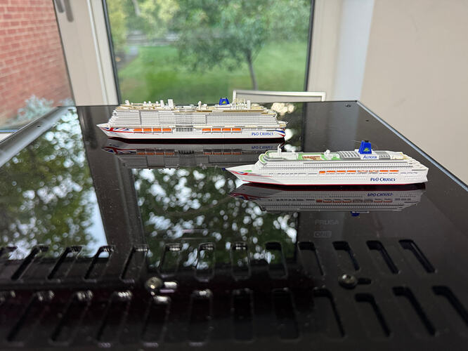

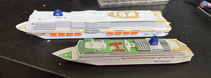

First attempt at Arvia 1:2000 print failed - due to some supports being missing.
Even at this stage it is interesting for comparing the sizes of P&O’s smallest and largest ships (at the same scale).

Arvia 1:2000 Coming along - only 2 more decks to go.

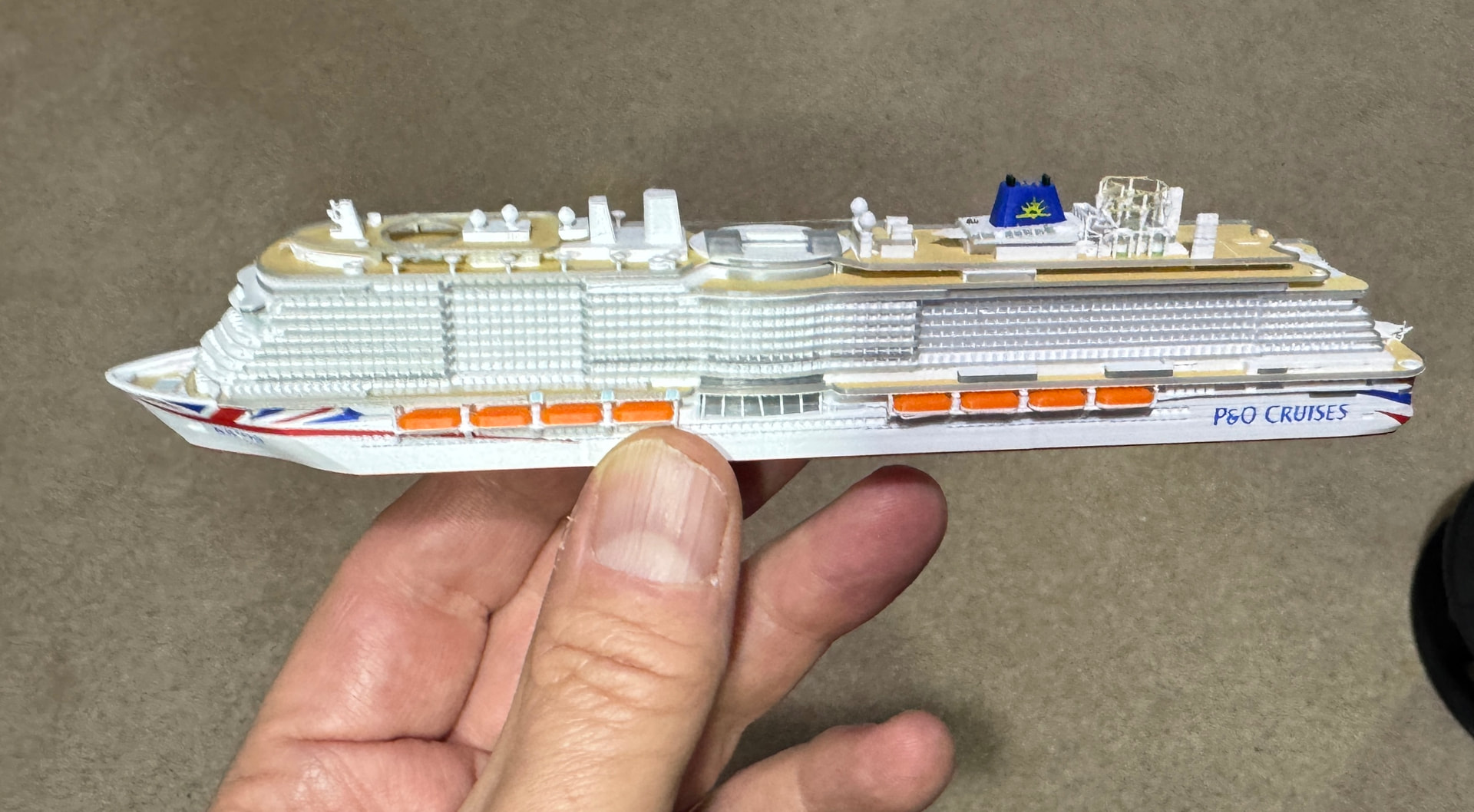

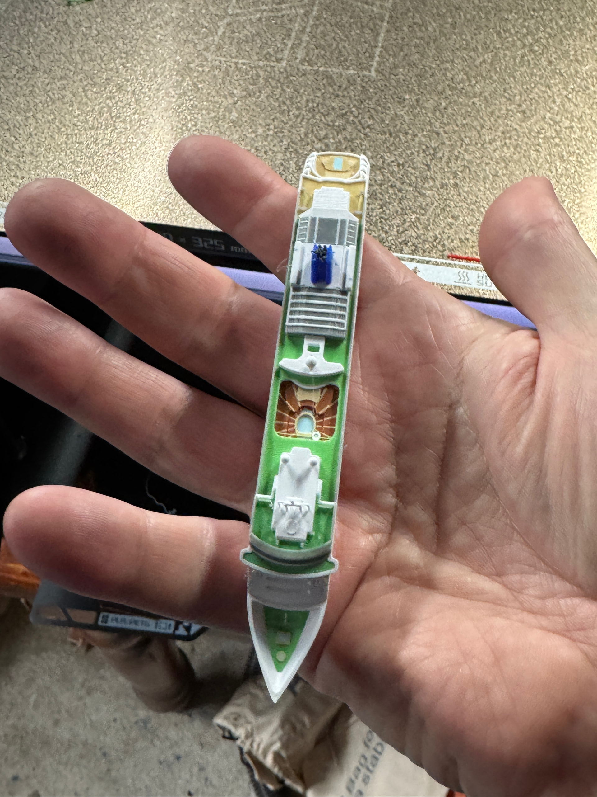

Looking pretty good, and bit fiddly to put together with 1mm screws, and pretty fragile - later springyT method much easier- plus would probably have been better to print several decks together, or the whole ship on one.

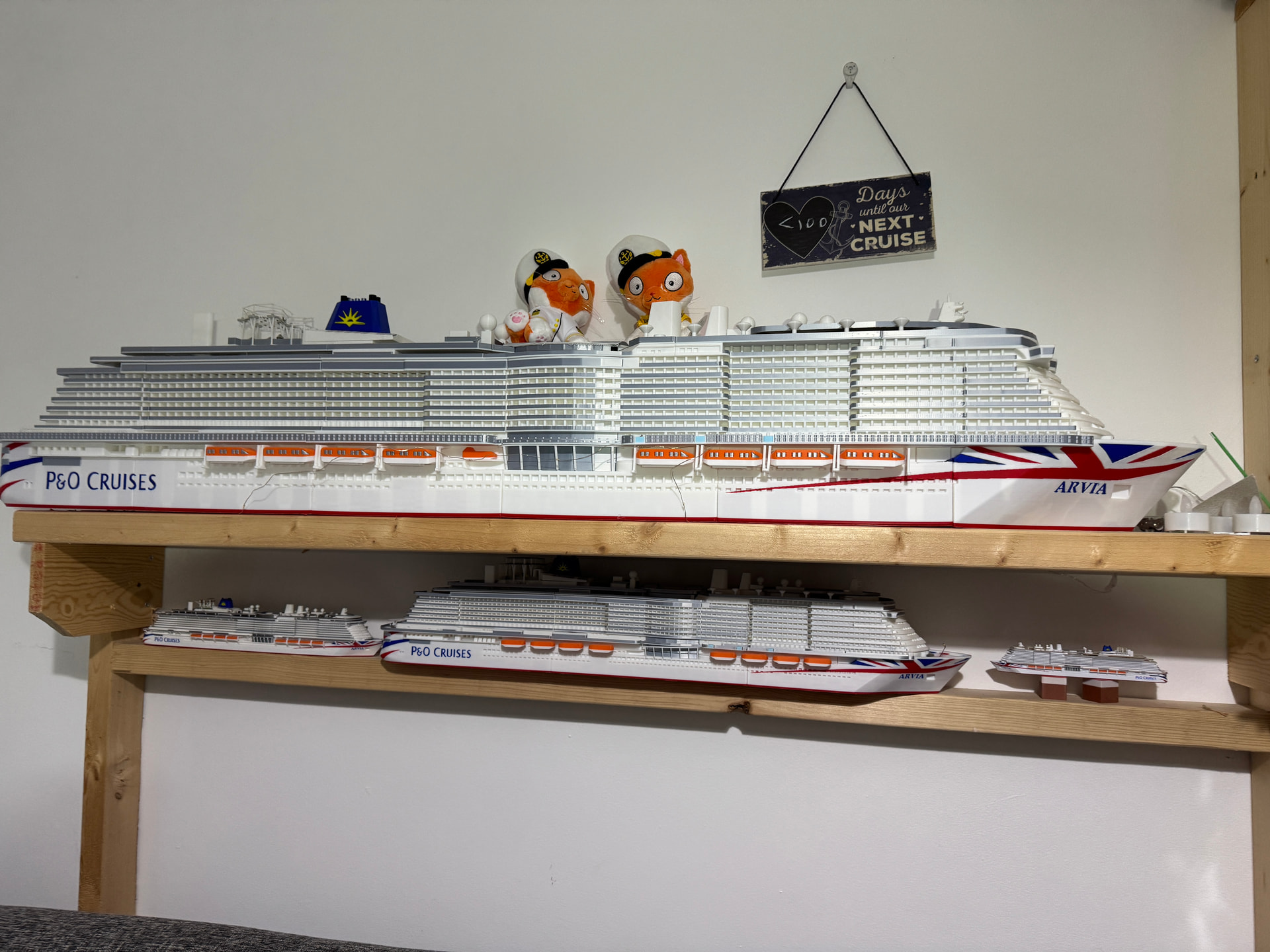

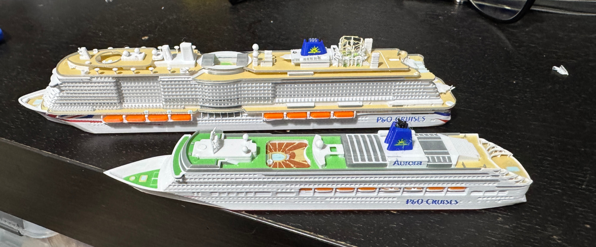

1:2000 Ariva and Aurora (on top of a rival printer).

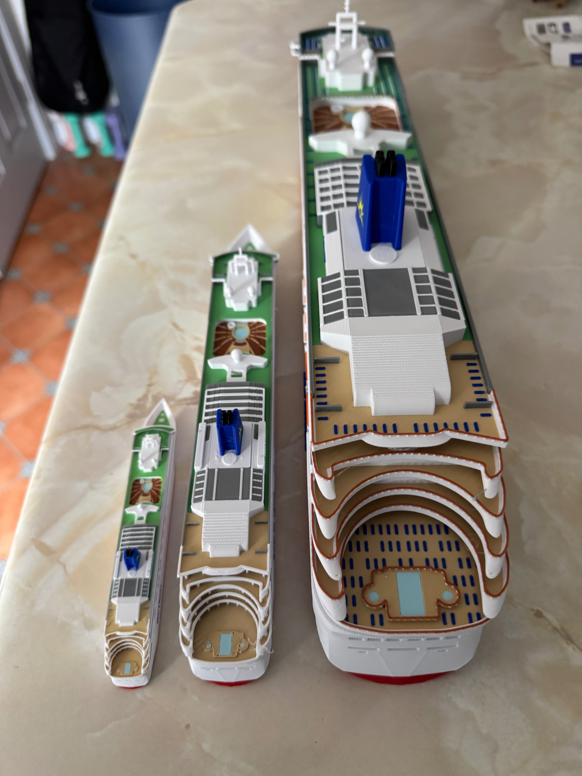

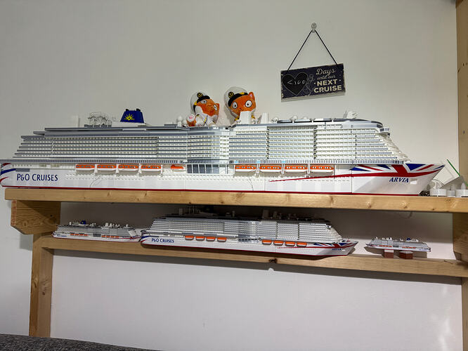

1:250, 1:500, 1:1000 and 1:2000 Arvia
Arvia 1:2000 - multi part

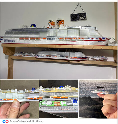

Love the Captain Hudsons
Thanks - got a :heart: from Emma Cruises on her Captain Hudson FB Group..

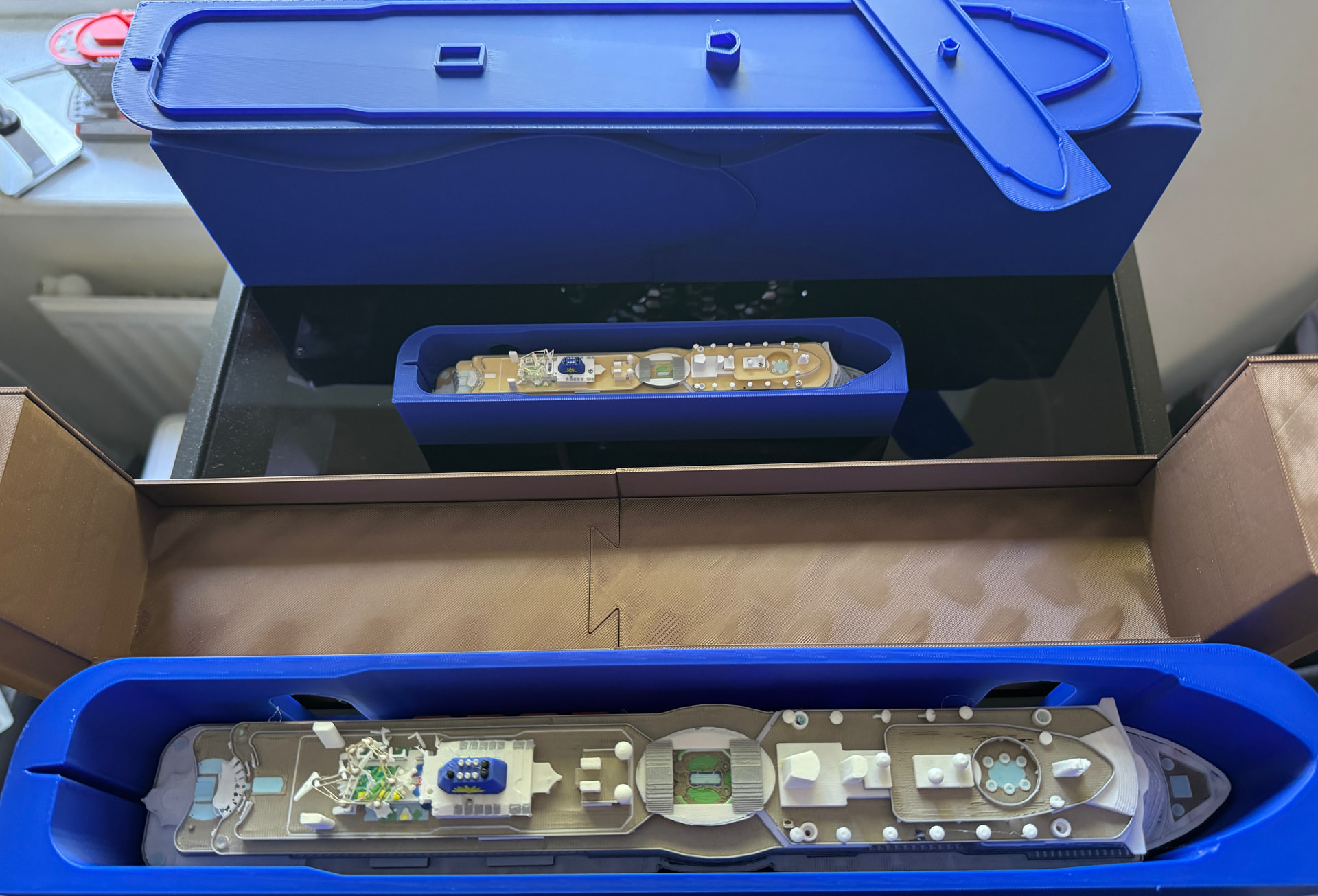

Two Arvia’s packaged up for their visit to the real ship next week.
