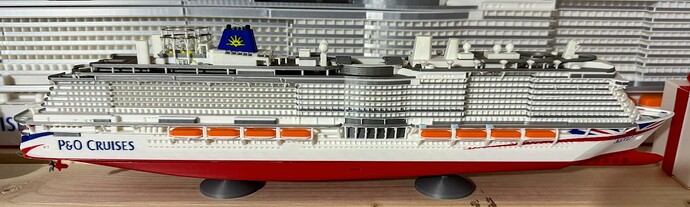

Cruise Ship Print

Thanks - yes plan to move over to other lines soon, although mainly on ships I have been on. Haven’t yet sailed on Virgin. There does seem to be a single colour Scarlet Lady model available on Cults 3d - so I guess it could be painted in Bambu Studio if you wanted to print it on the AMS - it looks like it is designed for a resin printer though - so may need some work or scaling up to get it to working on a BL printer.

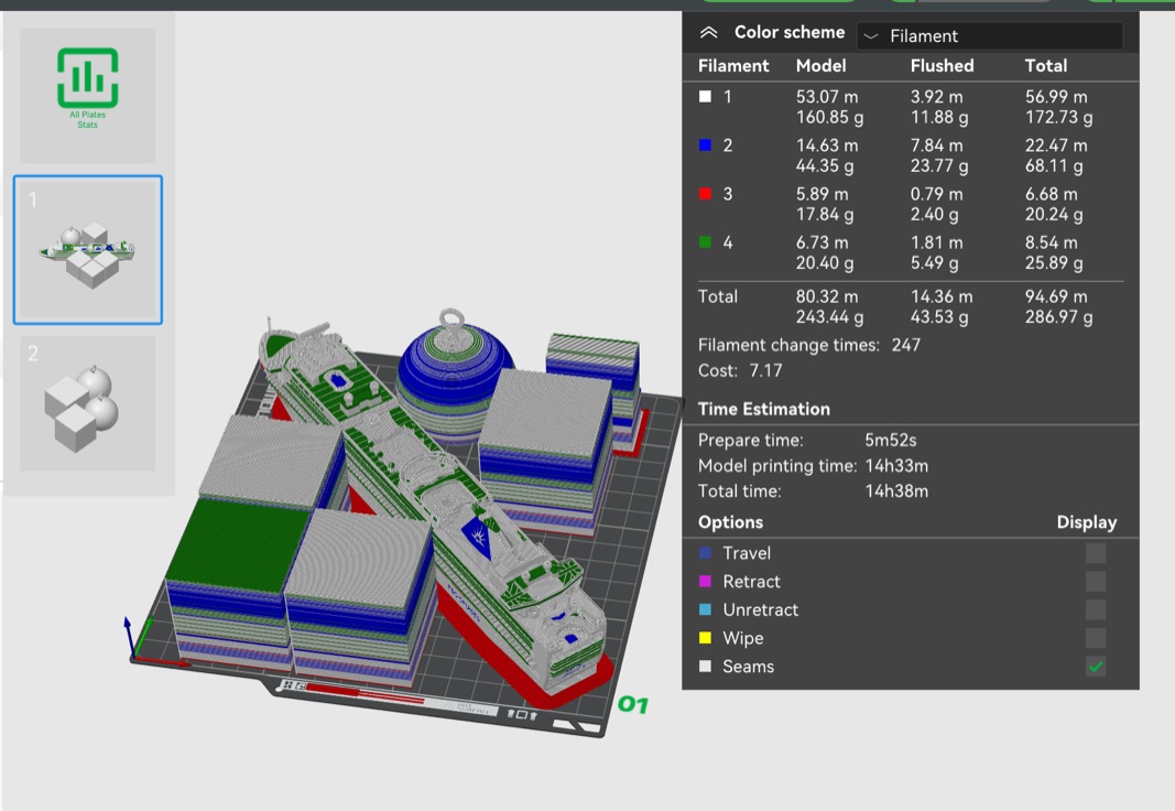

Currently on my last day of a cruise on Azura - appropriately decided to do some re-modelling of my Azura model - to hopefully get it down to a small enough size to fit on an A1 mini build plate, and to reduce to number of colours down to 4. Needs a bit more work before trying a test print on an X1C.
You do amazing work, my friend.

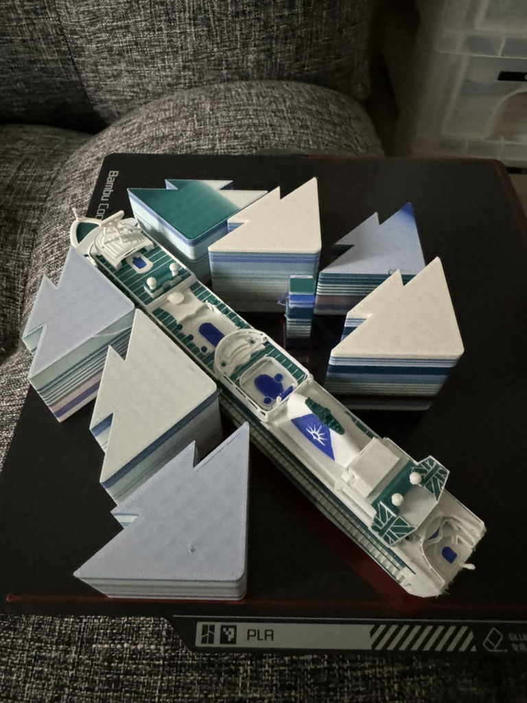

Can’t get purge down to less than 1g - due to size of A1 Mini build plate - but am able to reduce it down by about 2/3 from 116g to 44g with some automated selection of suitable ‘purge-to’ xmas decoration objects (see my other thread for more details). So will do this plate as first multi colour test .

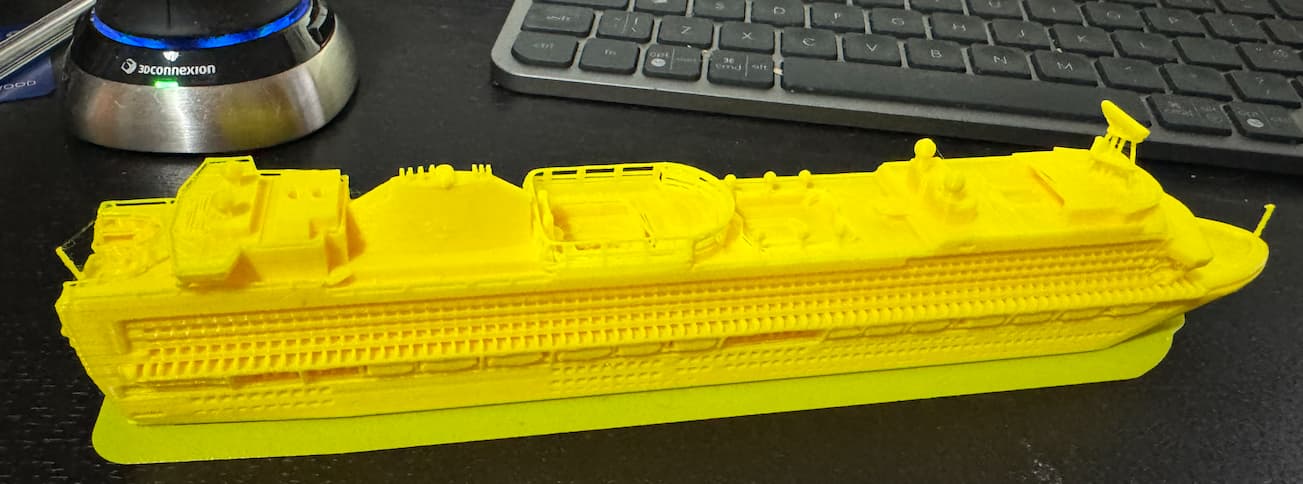

Single colour test print of Azura at the 1:1250 scale needed to work on an A1 Mini worked pretty well- (using BL sponsored yellow filament) took about 6hrs - so think I will have a go the 16 hr 4 colour ‘waste-free’ version tomorrow. The ‘purge-to’ objects are parts of the legs of a 3d printed table that I am creating.
Update - with further refinement - I thought something had gone wrong - but the flush column disappeared - but I actually think I have managed to eliminate 100% of flush! - will be interesting to see how it prints out -
Update - printed and now on Makerworld.

Original multi plate Ventura went over 1000 downloads on Makerworld - haven’t seen many builds though - so not sure if people are downloading for later or seeing that it is too complicated to print.
Multi plate Iona also up to about 650 downloads.
The surprising thing is that my newer single plate ships are not getting nearly as many downloads - when I thought they would be more popular due to the simplicity. Especially the most recent 4 colour Azura at a size small enough for the A1 mini.
I might be that they don’t have the ‘featured’ flag on - plus I guess Venture still being on the BL homepage might be driving downloads.
Might have to look at the photos though on the other smaller ships as maybe this is part of the reason they are not as popular as the less practical smaller ships.
Current thinking is that my next ship will the another Arvia/Iona sister ship - at single plate scale - probably Carnival Mardi Gras.

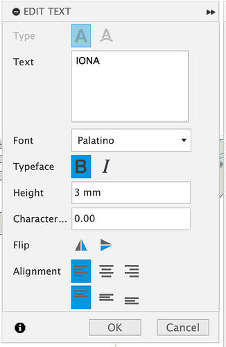

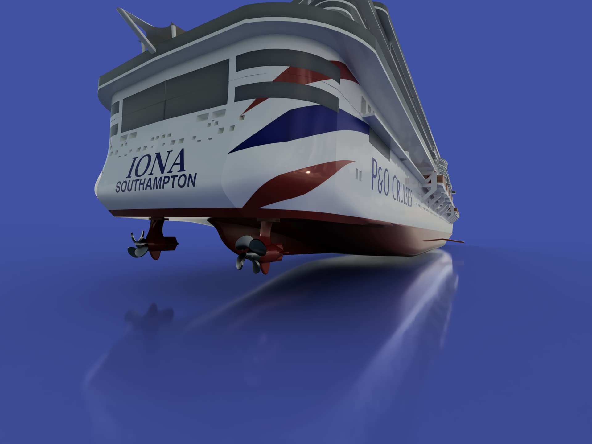

I tried to print but the iona name not clearly print to me(maybe my printer error). Can I know what the name of a font of “Iona” at front port and staboard?. many thanks
Sorry about that - Can you let me know what site you got the model from, and whether it was one of the 1:500 scale versions.
The actual font used is attached - however note that in 1:500 the model it is actually scaled up to 200%
is the text readable if you preview it in Bambu Studio?

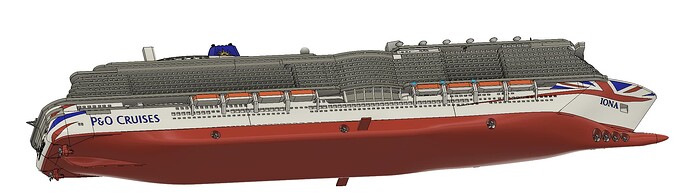

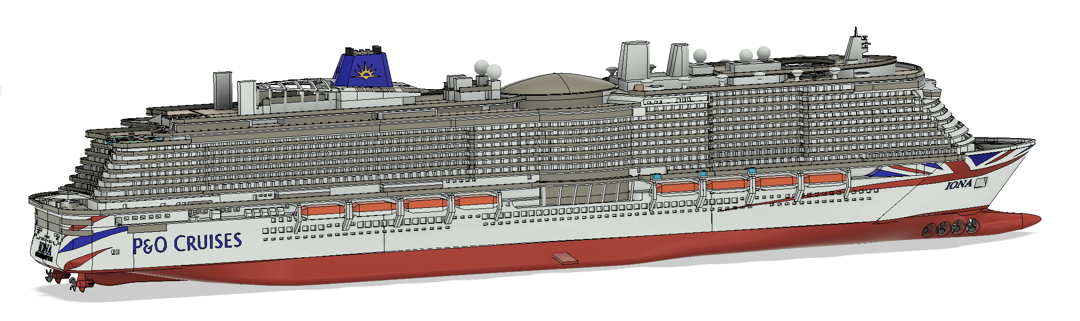

Finally got round to doing some modelling of the underwater parts of Iona/Arvia - its pretty hard due to lack of photos - but there are a few video’s of Arvia parts being delivered on Cruise Critic/Youtube which help. Not sure of the proportions, or whether I have missed anything.
Going to be difficult to do the full ship in a single print due to all of the overhangs - so may have to split the 1:1000 scale single plate versions into 2 - so that I can print the underwater parts upside down.

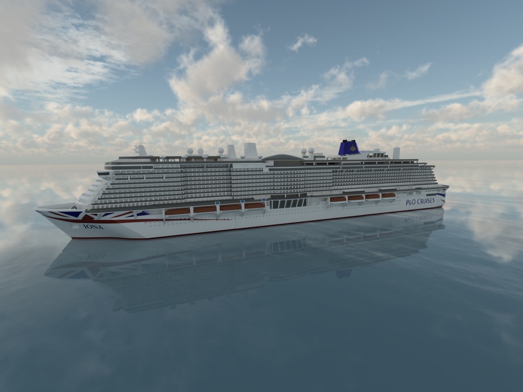

Updated - added a few renders too - I keep forgetting how well F360 can render images
. It takes a few minutes for each one on a M1 Mac mini.
Got some useful feedback from ModelShipWorld and the Fusion360 Facebook - so have corrected the underside to a) Remove 3 thrusters, b) Swap the direction of some of the propellors, c) Aim the stabilisers slightly down.
Slightly improved bottom bulbous bow profile I think this will do for first test prints

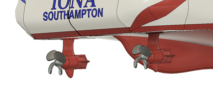

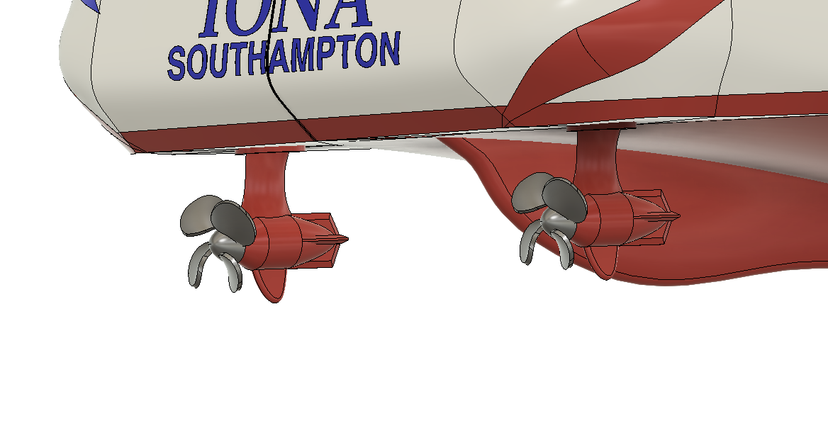

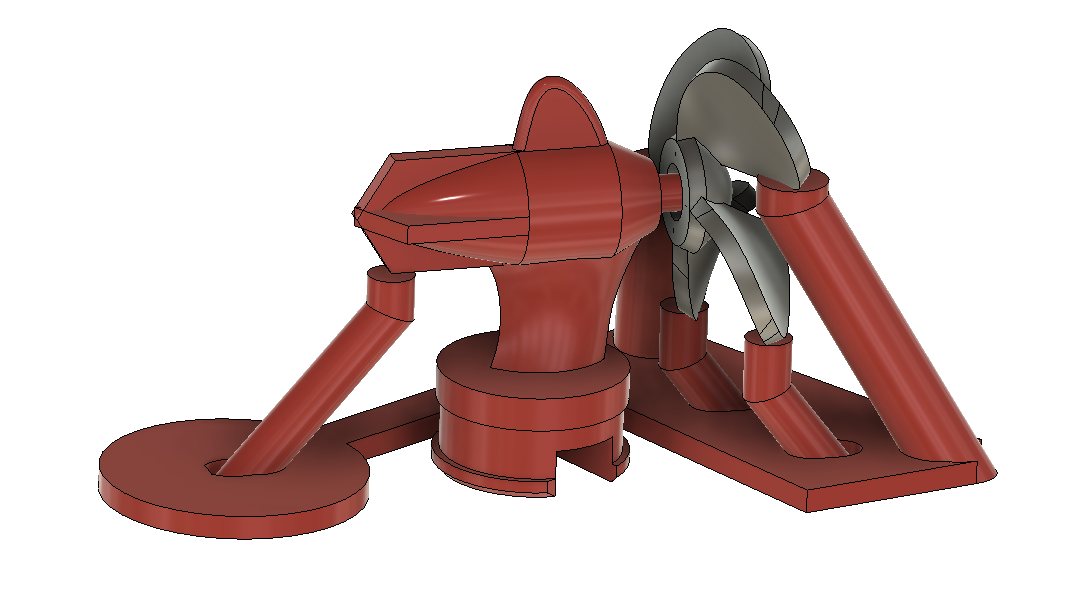

Good progress made today on underwater hull print. Manage to get the tiny Azipods (rear motors and propellors) to print ok eventually - with custom designed supports.
Those tiny parts take about 90 mins to print at 0.08mm layer height.
Redesigned them slightly so that they clip in and can rotate - rather than the glued in versions I did today.
Just need to do final reprint tomorrow then will probably add the extra parts into the existing Makerworld 1:1000 entry in the next few days.
