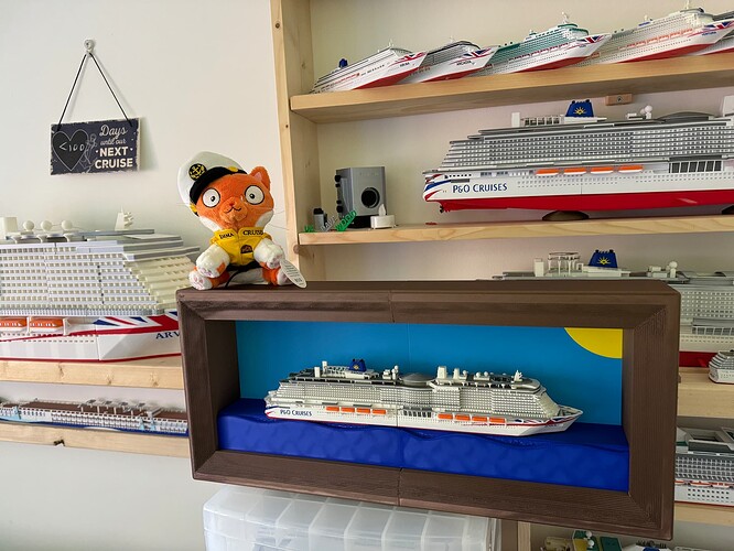

Think I will create a lighter weight version of the case that is easier to transport onto ships. With a paper or thin plastic back for the sky and then the bottom part becomes a magnetic transport box. Something like this…
Lightweight version came out pretty well - particularly pleased with the 2d background part. Disappointingly my printer won’t print more than A4 - so I had to put the paper with is A3 width through twice. Tried a few different ways, but eventually settled on two photos that fade from blue to white - so that you can hardly see the transition.
Some earlier attempts at the 2d cardboard sky part - bottom version is with no fading. Top version with fading, but not enough. Dropped the frame from paper print as would be difficult to line up the two prints.
FInal touch - customised Insert to hold Britannia snugly in place while being transported.
Britannia Model compared to real ship.

Now back - made a few corrections based on the comparison with the real ship. Corrected version below.
Main changes are:
  1. P&O Sign at top,
  2. Slight increase in height of a few of the top decks
  3. Filled out detail of retreat section at front.
  4. Correct the top front windows
    Will reprint tomorrow.
Frame case worked fairly well - but the portable part a bit big - so will update it so that it fits more snugly around ship.
