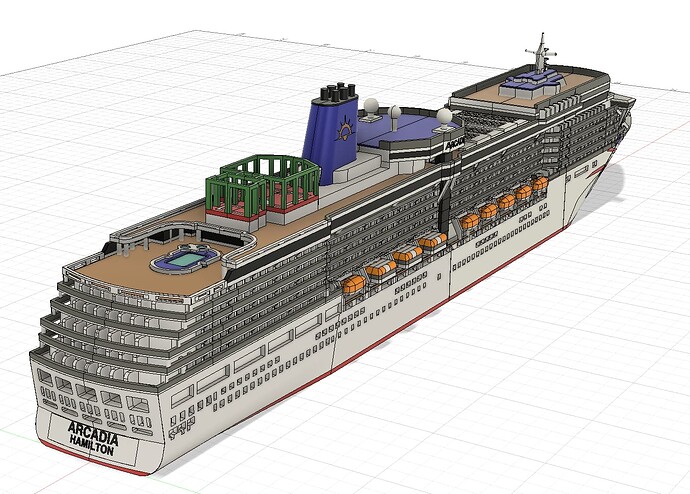

Had a very interesting visit to the Hamburg International Maritime Museum and Miniature World Museum and have been inspired to increase the level of detail in my 1:500 models. Have started on Arcadia - which I think is currently a bit plain at the back.
Current design

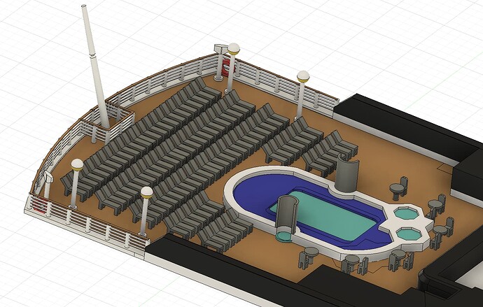

Proposed new more detailed design - deck9 rear only
First test print not perfect - some parts a little too small
2nd attempt a bit better - but railings still quite uneven
think it is mainly due to speed changes between bridging (slow) and the posts (fast)
Added some speed modifier blocks in to bring the speeds down for everything
Now looking quite good and ready for full colour test print

Most required extra details added to upper decks - just need to address balconies on all other decks
Update - lots more detailed added - which caused a few F360 issues.
Before
After
Final version - ready for test prints
Some Fusion 360 renders of the more detailed version.

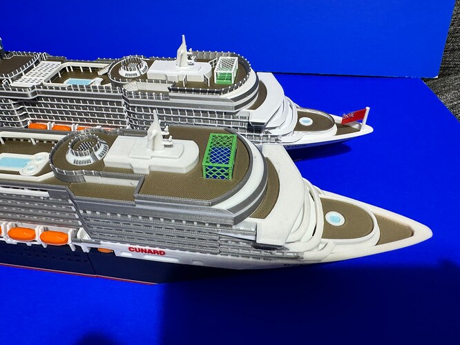

Started on printing the more detailed 1:500 version of Queen Victoria.
Decided to split the top decks off seperately - to de-risk in case of failures.
Have also done a bit of a tidy up - and moved all of the old test print / doubles into a waste pile
First attempt failed on stairs and canopies - should have tried it single colour first
2nd attempt about 60% through - and looking a lot better
Thurs mid day - Main body progressing well - 42% complete - about 12:30 to complete - so should be ready by late morning tomorrow (after overnight pause).
Need to reprint top bow section as a part seemed to be missing.
Thurs evening 84% complete - about 3.5 hrs to go, paused for the night
Finished - just need to reprint bow top section and a few accessory parts

Queen Victoria detailed print now complete - quite pleased with the level of detail I have managed to get.
Compared to previous less detailed version and 1:1000 version
