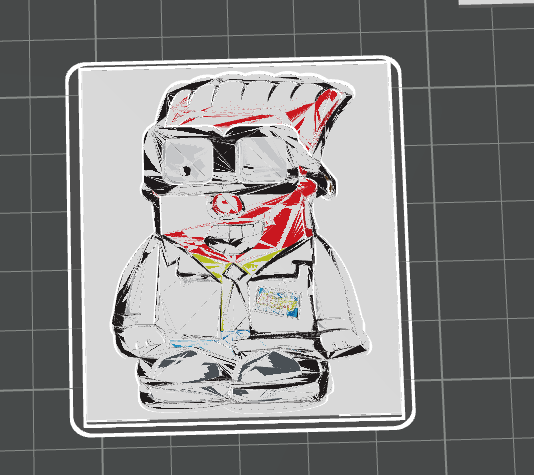

Crystally Top
For MakerWorld Make my Sign. I am trying to make something on it and it tends to make “crystals” on the top.
Would you know by chance why it would be so “cristally” I keep playing with the height of it and it just seems to never get away.
This happened to me when I tried setting the height of everything in the settings to be the same
I did that, then I tried to have each setting a bit different as well and it still was like that (I believe). Were you able to figure yours out by changing it?
This might be a helpful walk through.
If elements in make my sign have the same height, it has the so-called z-fighting in the 3D preview. You will encounter the same issue in the preview of Studio.
The workaround is to give it a try and continue to slice the model. If you find everything is OK in the slicer, then you are good to go.
If you find something is not on the top, you can try change the order of the backdrop in the object list of Studio and try again.
