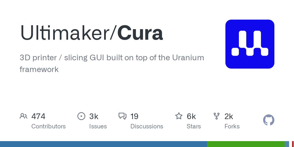

is curas interlock feature for intelocking two materials
(petg/tpu) patented, or why is it missing in bambu studio?

I believe it is about the interlocking feature where one material slowly merges into another across multiple layers, like teeth grabbing something.
Like the photo:
As described here.

That isn’t interlock, that is support for multi tool printers like the Prusa XL or the printer I donated a few years ago when I gave up on 3D printing (before I jumped back in with BL), the TENLOG TL-D3 Pro.
It supports multi-tools (or each side of the IDEX the TenLog has) now, which gives it support for materials of different types and different nozzle sizes rather than the interlock feature which can use multi-tool and IDEX printers, but, could be used with an AMS.
The difference is, that the feature you pointed out allows the slicer to have very different profiles including nozzle sizes when using a different tool. That helps (as in the example shown)when you need fast thick infill, but, smooth outer the surface, or when the model requires a 0.2 nozzle for fine text, but only in a small area, the rest of the model uses a 0.4mm nozzle for speed.
The interlock creates an interlace between two different types of materials so those that normally would not join are essentially sewn together through lower and upper layers and the side walls.
It is like interleaving your fingers and trying to pull your hands apart rather than the hands being open and they slide apart without anything to stop them.
YOu are a 100% right. Wrong screenshot. Same link.
Oops?
