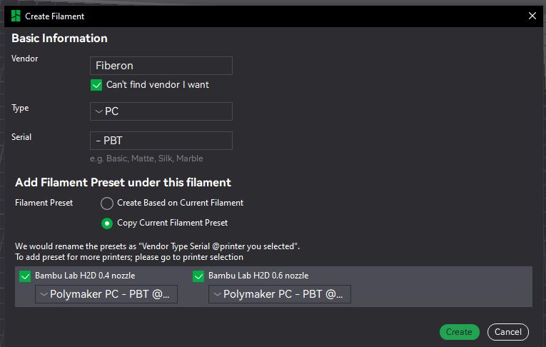

I have a question about custom filament profiles and the H2D.
I generally print a lot of PC/PBT, which worked great with the X1C and OrcaSlicer. With the H2D and Bambu Studio, it looks different again, or rather, it’s not possible.
Since Bambu Studio cannot use the profiles from OrcaSlicer, I tried to recreate the data from the profiles in Bambu Studio. In general, this works, but when I want to add a printer to the profile, the H2D is not displayed.
This also causes the problem that my own filament profiles are not synced with the AMS.
How do you do it?

I assumed that it would work the same way. However, this is where the first problem arises. When I try to assign a new PC/PBT profile to the H2D, Studio refuses because the printer is not recognized as a valid destination.
Currently, I’m getting around this by editing existing profiles directly in the json to add the H2D as a valid printer. However, this doesn’t work with every filament. And if I go directly to Material Options => Custom Filaments, the H2D is completely rejected for PC/PBT or Fiberon.

I know that. It still works in Orca Slicer. In the current Studio with H2D, I can’t even set it. Where the printer is normally specified, there isn’t even an option.
When I get home later, I can post a screenshot of what it looks like on my computer.
A screenshot would help—I think I’m not fully understanding what you’re seeing.
