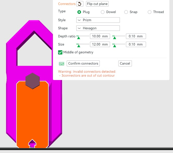

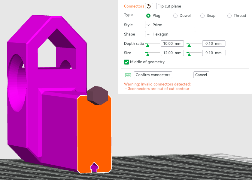

In Bambu Studio, when cutting (C), the “Edit connectors” option is great, but the option to place the connector in the “Middle of geometry” is limited to the middle of the overall profile of the object being cut.
An additional option (“Middle of cut face”) to place the connection at the middle of the “cut face”, which might not be the same as the object’s overall profile, would be even better.
Example screenshots are provided. The cut face is orange, but the “Middle of geometry” is based on the entire object profile (purple and orange).
