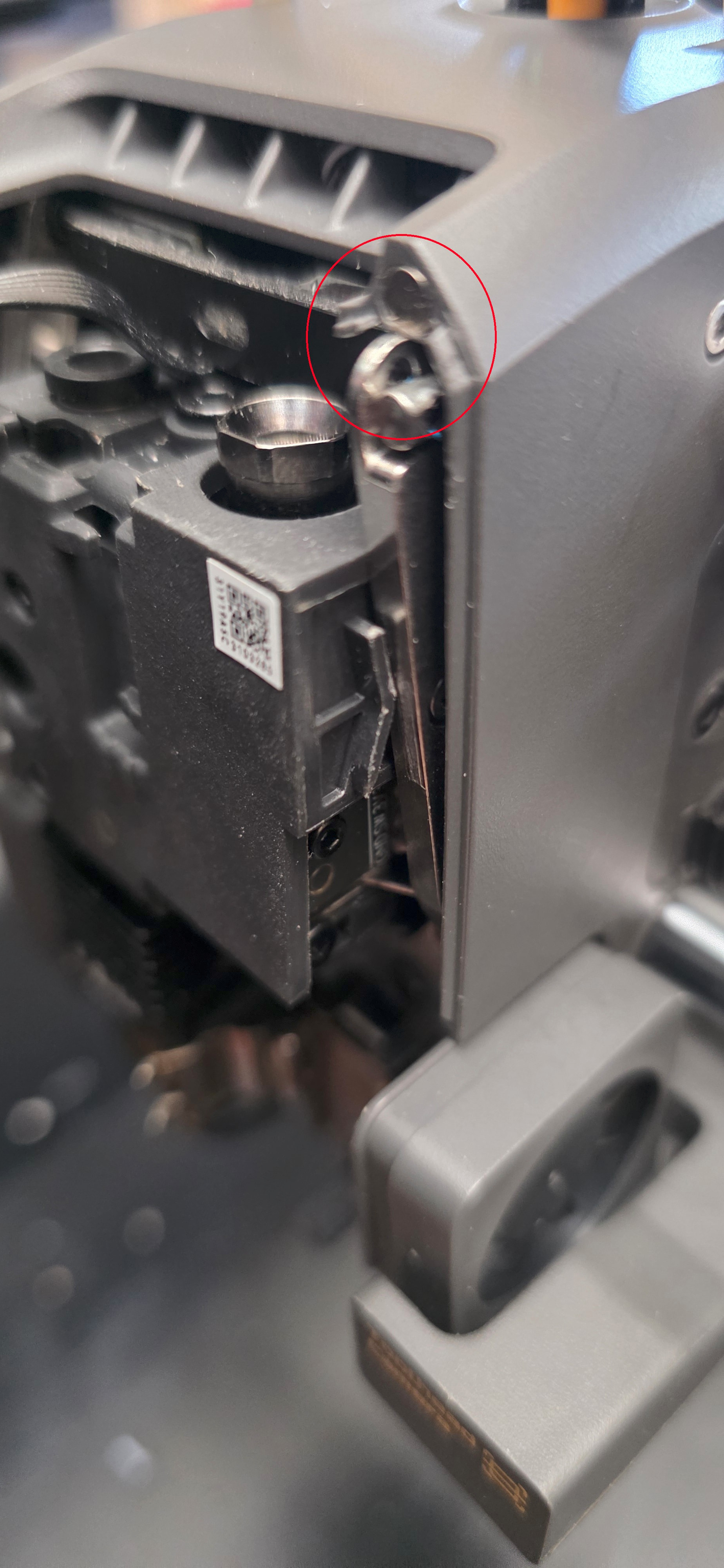

Can someone please explain to me why get right filament cutter lever stuck into Toolhead Middle Housing???
I’ve already replaced everything, everything is new, back and middle cover and this piece on foto is also new that is stuck now….
Even at Support I get the same article about Cutter Assembly. I have never removed those cutters.It is stuck at the top where the magnet is.
I found the cause. You need to install the Middle Housing first and then the back cover. Now it doesn’t get stuck anymore…
