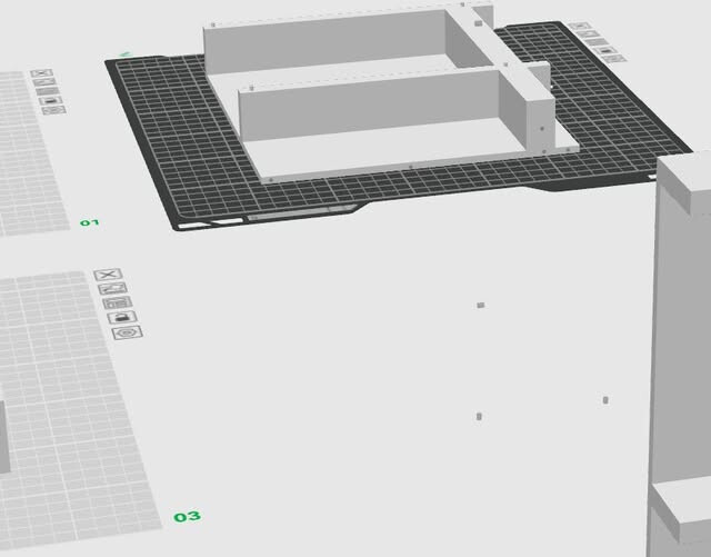

I made a rather large design to hold up a piece of test equipment with possible drawers under it.
It is way to large to print on my H2S or H2C.
I am very, very new to cutting up a print in Bambu studio.
So when cutting, I choose and place “plugs”. Afterwards, I have to mover the pieces around. When I do it looks like it leaves the “dowels” (plugs) at places on the screen. I’ll try to paste an image of what I mean.
How do I avoid that? When places plugs, why don’t they stay with the part?
Thanks kindly, for the help. I find this cutting fairly difficult.

I think I did figure something out. If I right click on each cut piece, before moving them, and selecting “Fix model”, then I can move the part around without leaving pegs behind. Boy, is splitting a model up a PITA. At one point a section had been up in the air and I could not get it to the plate unless I selected “Split to Objects” and then it went down to the plate without leaving anything behind.

If that helps, I think plugs remain attached to the object and dowels are made separately.
edit You mean group or merge instead of fix? Fix appears to be working but from what it does, likely isn’t guaranteed.
Fix. I didn’t notice a merge. I’ll look again, but fixing an object allowed me to move it without leaving the pegs behind.
