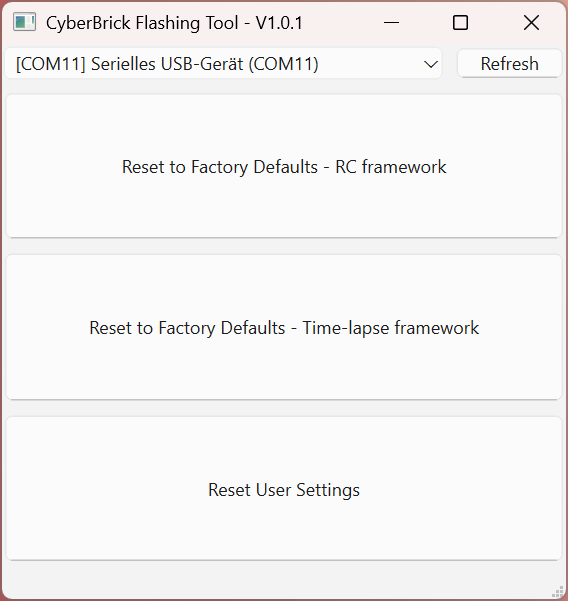

In order to get the CyberBrick Factory Recovery/Flashing Tool, with which you can reset the settings and/or firmware of the CyberBrick Core, as well as swap between Remote-Control (RC) and Time-lapse applications, you need to open a ticket at MakerWorld support: https://makerworld.com/en/my/support/tickets/create
After this, you get sent a message with download links to Windows and Mac version of the tool.
The GUI looks like this:
You need to hold and keep holding the User Key button while attaching the USB cable and throughout the whole flashing process for flashing not to stop after some seconds:
Only when resetting user settings, pressing the button is not required.

I submitted a ticket to get the Recovery/Flashing tool but I can’t seem to get it to work.
  • On MacOS (Apple Silicon), I get an error about Python3.framework.
  • On a Windows 10 machine, I can successfully “Reset User Settings” but either option for “Reset to Factory Defaults” doesn’t work – the progress sits at 0% forever.
@xrk No combination of holding the reset or “User” buttons when connecting USB or during flashing appear to make a difference.
