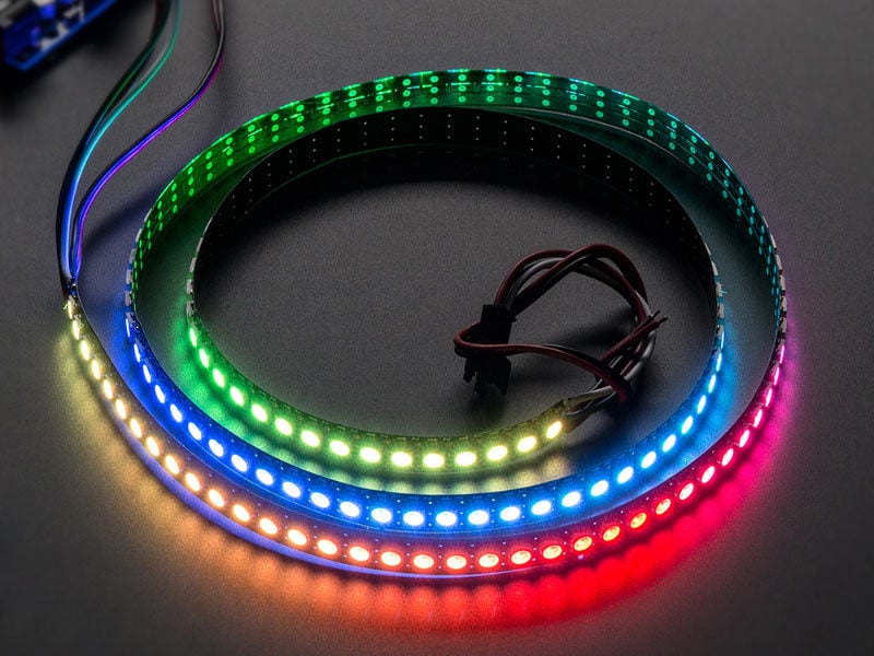

No mystery. Addressable LEDs. They are powered separately, not through the connection to the SoC like a normal LED. Instead of sourcing or sinking current to light the LED, the SoC provides a serial data stream that tells a LED to turn on/off and if it’s colored, what color and brightness. They are often connected in series, and you can control each LED in the series independently with the single data stream.
Many libraries for the Arduino environment that will drive these devices. Easy peasy.
It’s still just a digital output, it can be retasked for an input or a different type of output. Nothing special about these LEDs or the requirements to make them work. Any SoC that can do serial data output can drive them.

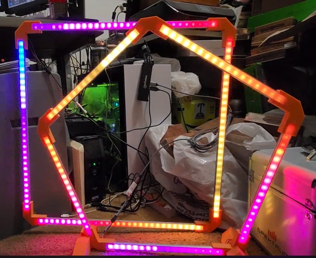

I use these addressable LEDs all the time. I’d post a short video of an example, except linking to YT seems to be broken at the moment…
Here’s a still image. Imagine the colors of all those LEDs constantly shifting around, and changing the pattern of the animation. You can see some of the LEDs are dimmer and some are brighter, which is part of the pattern that propagates around the entire ring. These are race gates for indoor drone racing.

It may not be totally correct to talk about anodes and cathodes with neopixels but they still have LEDs with anodes and cathodes. The terminals are generally just marked with a + or - though.
Neopixels have some sophisticated circuitry in them. System on a chip kind of thing. What neopixels really have are power rails and daisy-chained serial ports and shift registers. There’s red, green, and blue LEDs with brightness controlled on each by PWM. You don’t connect directly to the LEDs but one rail may so in a way it could still be a cathode or anode.
While that’s complex sounding they are really easy to use. In many ways easier to use than discrete LEDs. With microcontrollers, it’s frequently easier to use neopixels and you get RGB/brightness capability. And you’re only driving a digital input so pin loading usually isn’t an issue. With LEDs designers should verify their chip can source or sink the current needed to light them.
