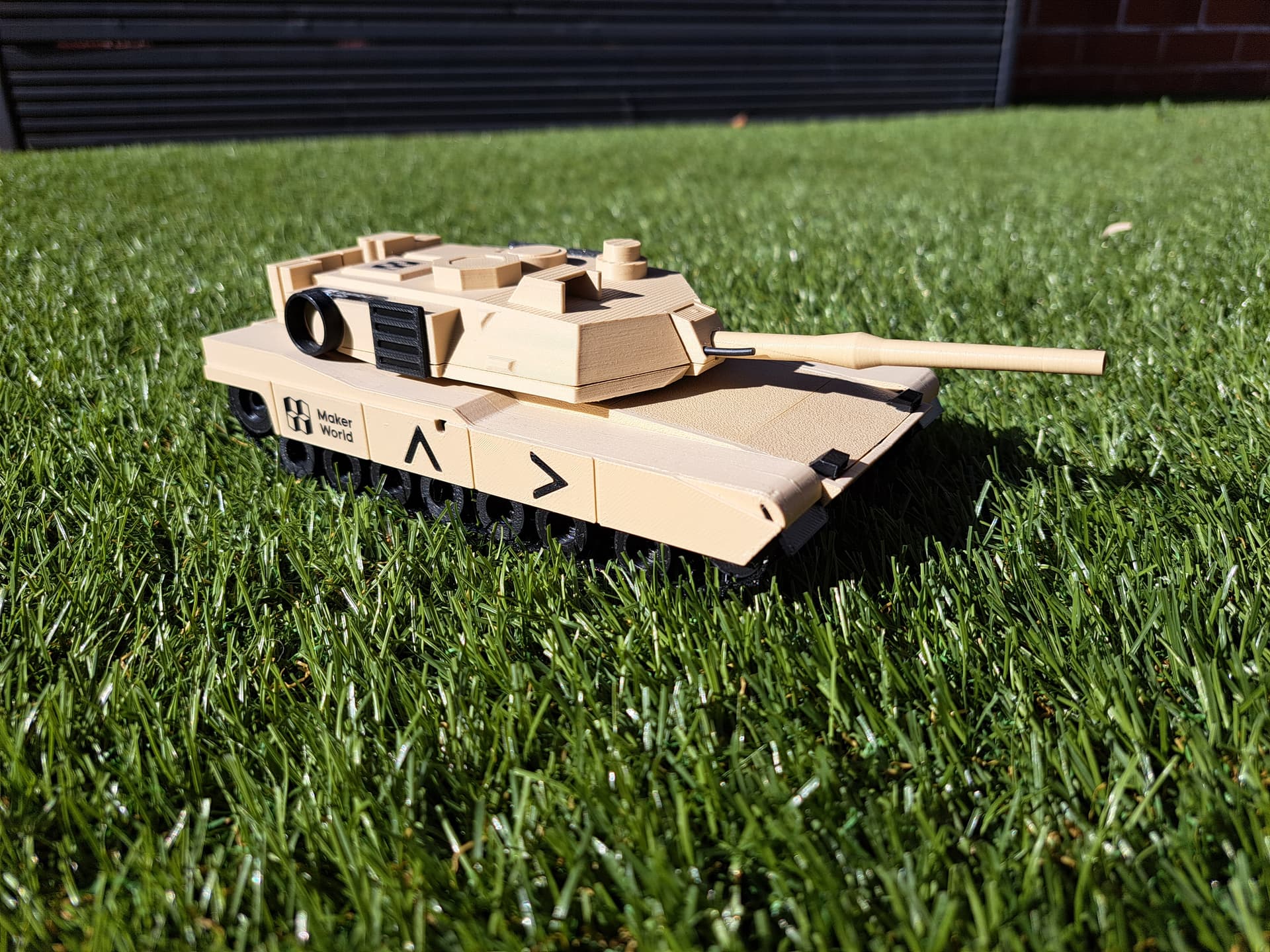

My model is based on an older model previously designed to use Arduino style electronics. After uploading that model, I was contacted by Bambu Lab to modify my design for their upcoming RC system, CyberBrick. I also used this opportunity to improve some of the details and functions of my design.
Functions of my Tank
  • Independent tank tracks
  • Headlights
  • Taillights
Overview
My design managed to incoporate most of the functions of my original model. However I had to ditch the turret traverse function due to limited space in the chassis. This however meant that I could use a more powerful battery, improving the tank’s speed and playtime. I was also able to include working headlights and taillights thanks to the compact RGB LEDs provided.
CyberBrick Version
Original version
Integrating CyberBrick Into Existing Designs
I found the process of moving CyberBrick into my existing design very simple and straightforward. This was thanks to the high quality STEP models provided by Maker’s Supply, which allowed me to model the tank with very high detail in CAD. The large assortment of parts available on Maker’s Supply also made the process very easy. For example, I was able to use N20 motors in my design, keeping the tank very compact.

Has anyone tried using TPU 90a instead of TPU 95A HF for their tank tracks? Greetings :wink:
I am working on assembling the tank and I am working on the skirts installing the lights. Are the lights in the skirts the same as the light in the front of the tank? I don’t see any other light in the kit or on the BOM. Also the instructions are quit confusing in this part. It says to insert 2 lights and they should fit snuggly. one light is not snug and there is no way to fit 2 in the spot.
Not even sure what this is showing. I assuming it is the light with something attached to it. If that is the case there is nothing to attach to it.
Hi there, apologies for the confusion. One LED should be used in the slot. The instruction stating to use 2 is an error. Regarding the second picture in the red boundary, that simply shows the position of the mudguard when glued since attaching that incorrectly will lead to a gap when the side skirt is attached to the main body.
Regarding the LED mounting, it is possible that it is loose due to printer tolerances or filament chosen. If it does not stay in place, you can glue the LED into the print. Hope this helps.
