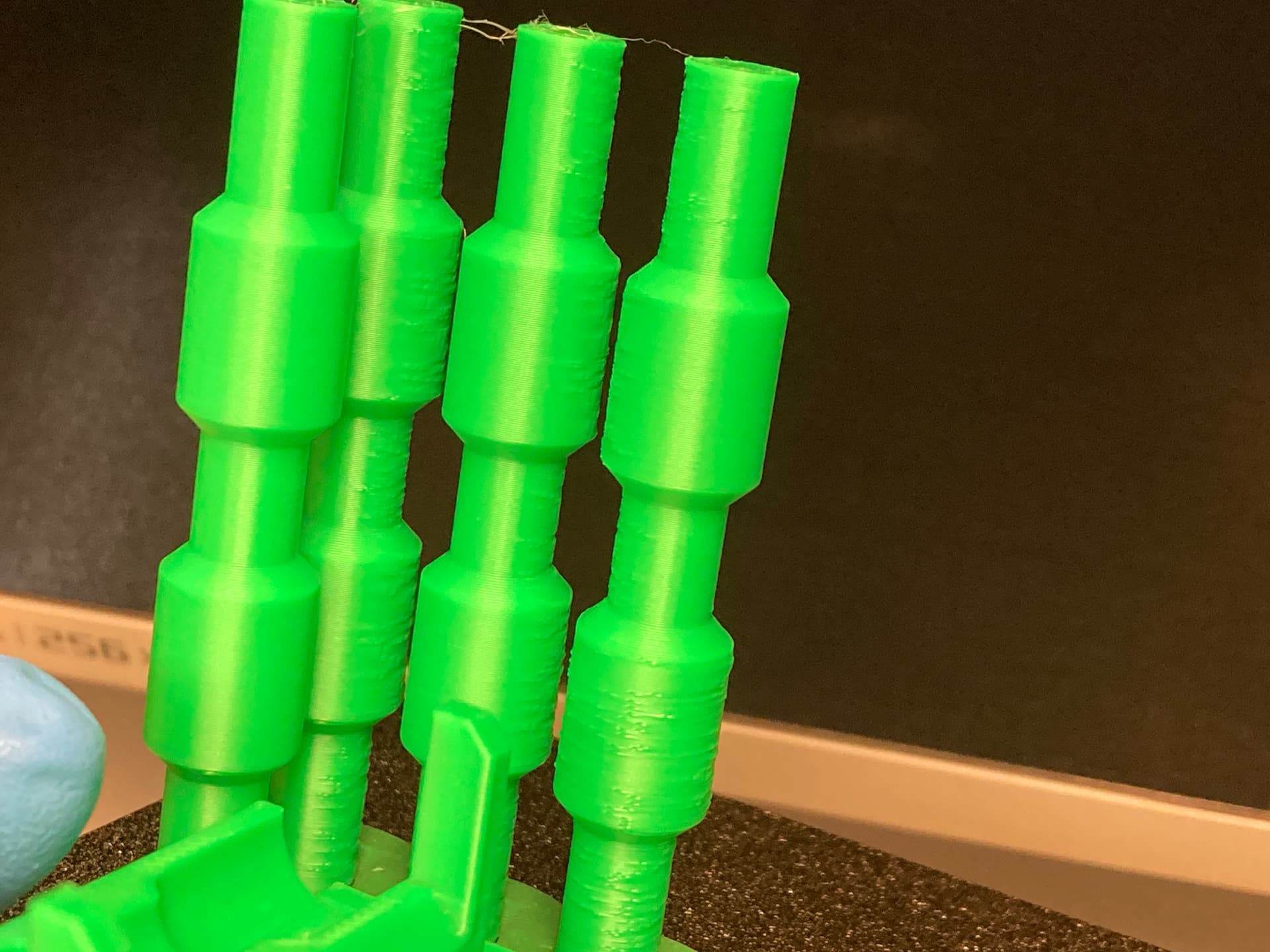

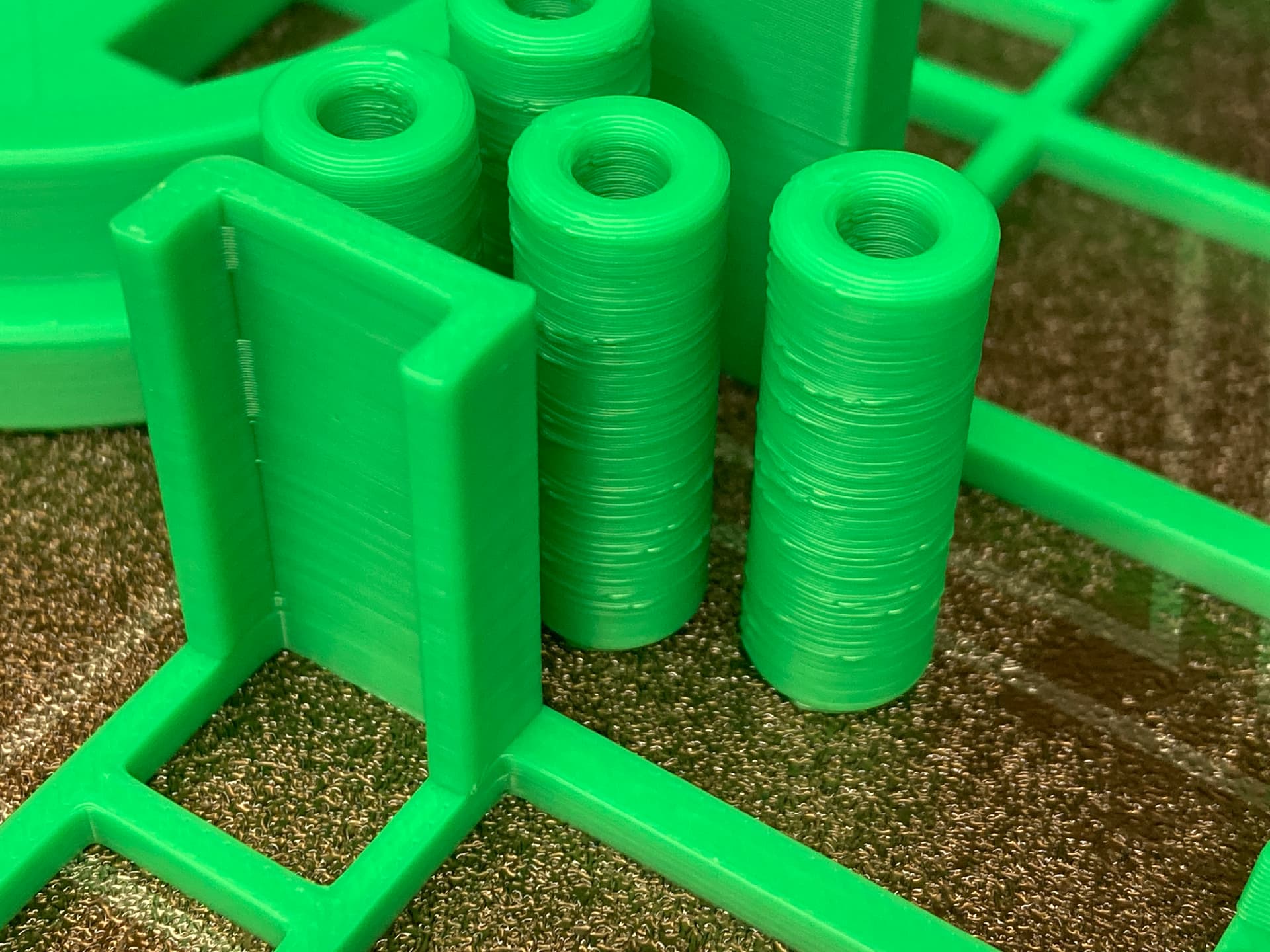

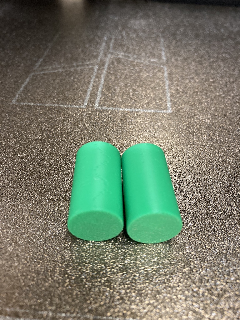

Cylinders are not printing smooth
Printed on an X1C; calibrated Bambu Basic green filament. Printed at 210°C
Noticing bumps and uneven layers on cylinders but everything else is pretty clean. Seems to be related to seams but I am not sure.
This is a model from printables: Filament Drybox with Rosahl RS1 Electric Dehumidifier Membrane by ERIK3DP | Download free STL model | Printables.com

I appreciate the questions.
  1. I dried it for 8+ hours in a Creality PI, also I keep it in the PI and dry it while printing
  2. I went though all the Orca Slicer calibration steps to calibrate the filament, starting with the temp tower, I ran the next two tests manually in Bambu Studios because they are the same, then went back to Orca Slicer to finish the calibration
    (2b.) I turned off auto calibration in the slicer before it gets sent to the pinter since I already calibrated the filament
I wouldn’t think it is a moisture issue because everything but the cylinders came out great. The only issue was the weird looking layers on the cylinders

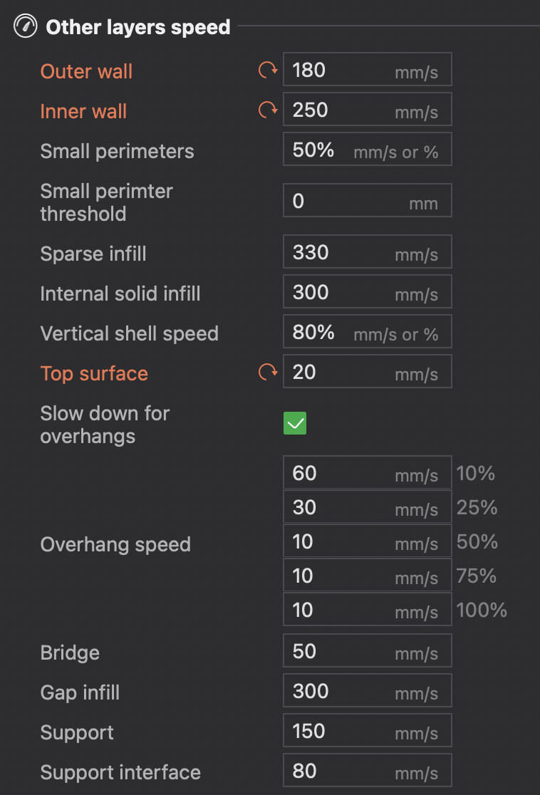

  1. Print at reduced speed. Use Silent Mode at 50% movement speed.

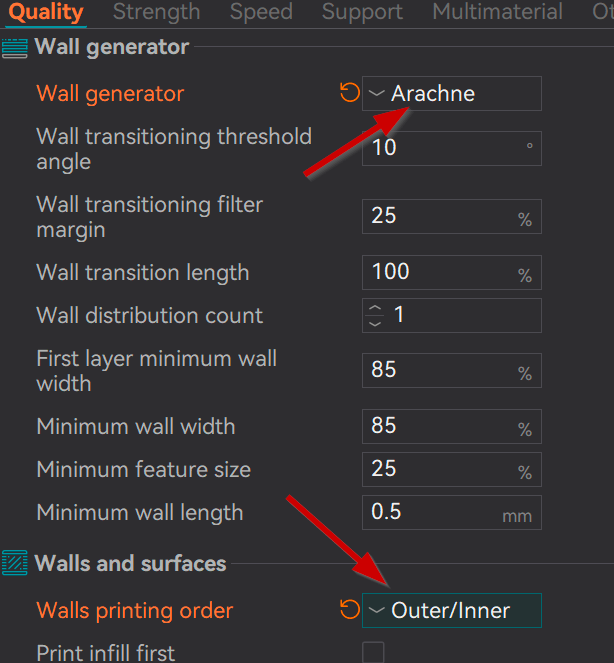

  4. Change wall order. For functional parts, I often switch from the default inner/outer to outer/inner so the walls set up first.
  5. In the Quality menu, enable Arachne to see if it improves the walls.

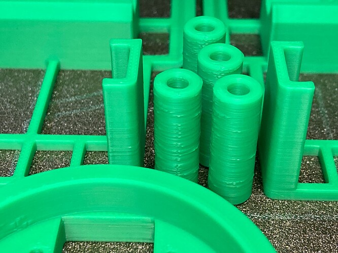

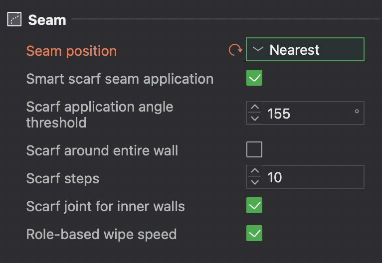

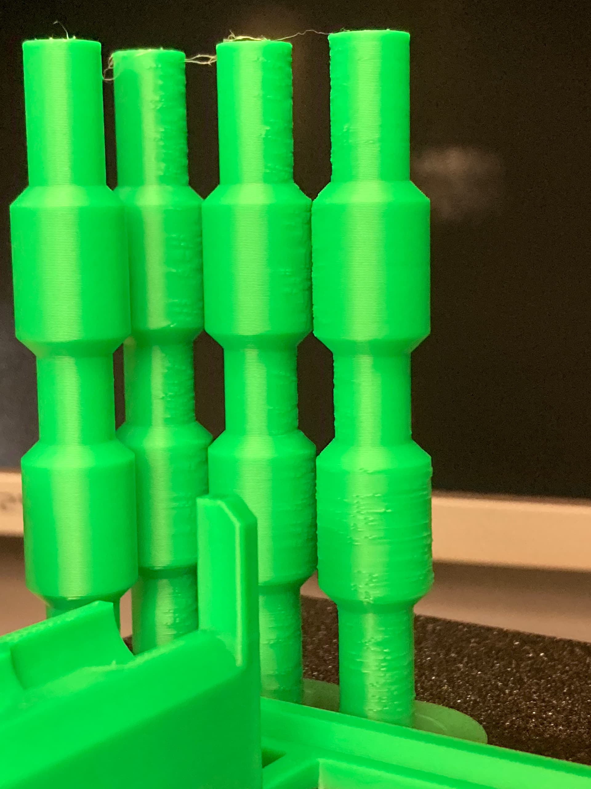

Thanks for these suggestions. I will get to it tomorrow after work. It is weird for sure, I printed a primitive before and it turn out really well. I’ll have to try a few of your suggestions and see if I can isolate the problem.
Primitives testing the different seam options:

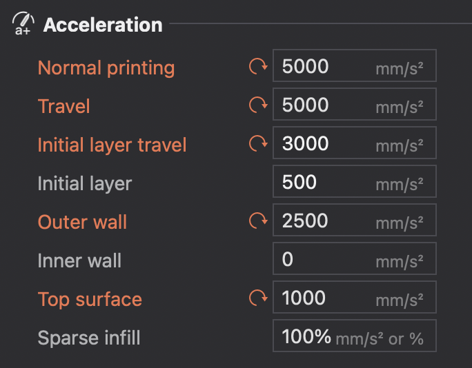

As for the Pressure Advance, I calculated this, although most of the calibration results are a bit subjective IMO:
