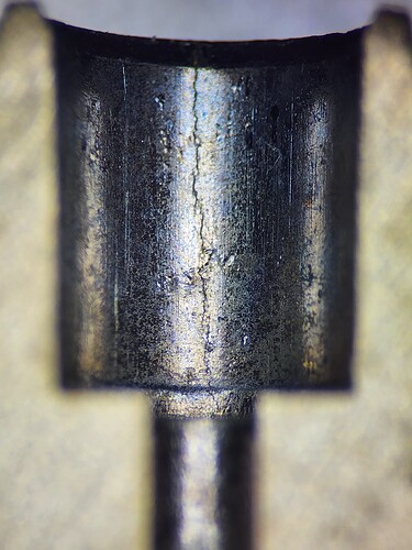

Cheap materials, design flaw, poor quality control. The nozzle being hardened steel and the heater block being brass with a titanium heartbreak they all expand at different rates. Parts are a shrink fit and the heartbreak is a shrink fit with retaining compound. If the nozzle is oversized slightly or the bore in the heatblock is undersized when cooling after assembly it will develop cracks. It’s not out of spec for the parts of you ask Bambu there spec is anything between 0 and infinity just dapends on how they feel but it’s an issue with the tolerances of the parts along with the assembly.
Fix.
None

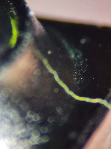

And yes. I did FPI on a nozzle along with pressure testing and microscoping inspection before cross-sectioning one.
This is why the A1 uses a different hotend. I haven’t cross-sectioning one of those But I’m assuming that they fixed it Because I let them know over a year ago about this issue with the X1 hot end and sent them all the data that I collected.
View of one of the 4 cracks on a new unused Bambu hotend. Out of the 6 I had 3 were cracked. And this is a view after cross sectioning after someone who handles their social media thought that they are an engineer try writing it off the scratch.

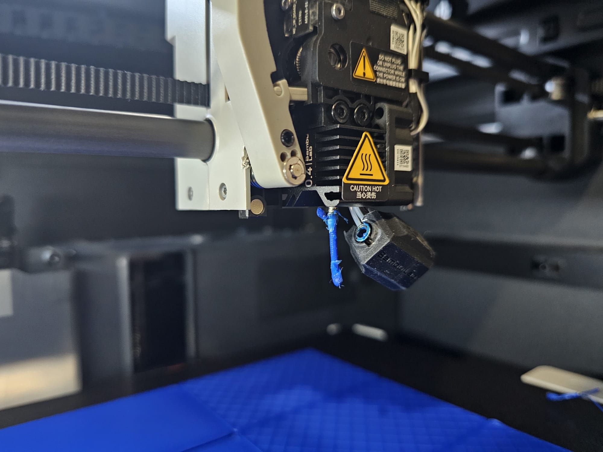

I hate to bring back an old thread but my hot end nozzle just broke. I’ve logged a ticket, but I think I have the same issue? or is this fixable?
Sadly this is not fixable by your printer did come with a spare hot end in the parts kit.
Looks like you were printing grid infill? Probably best to switch to a non crossing style infill as grid puts sideways stress on the nozzle as it impacts where the infill crosses.
